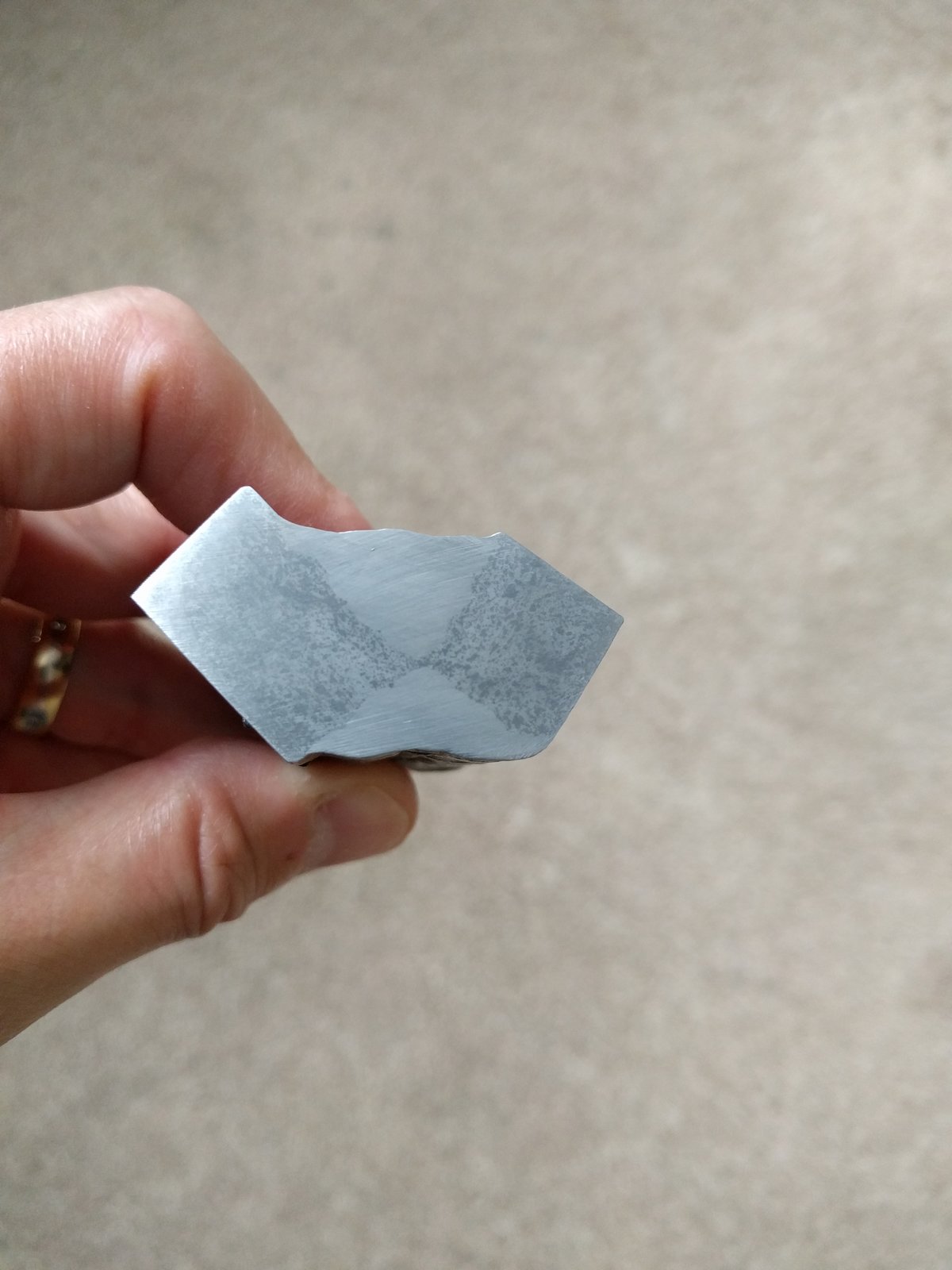

First of all I'm no expert Just a weekend warrior!
Parweld 162 @ 125 A dcep. Horizontal and cooling the piece every 3rd line of weld.
One side is 3.2mm Ewm 7018 and the other is 3.2mm Castolin 6601 (6013 I believe) got given from work.
Can you guess which side was done with which rod? Also does it look OK?
