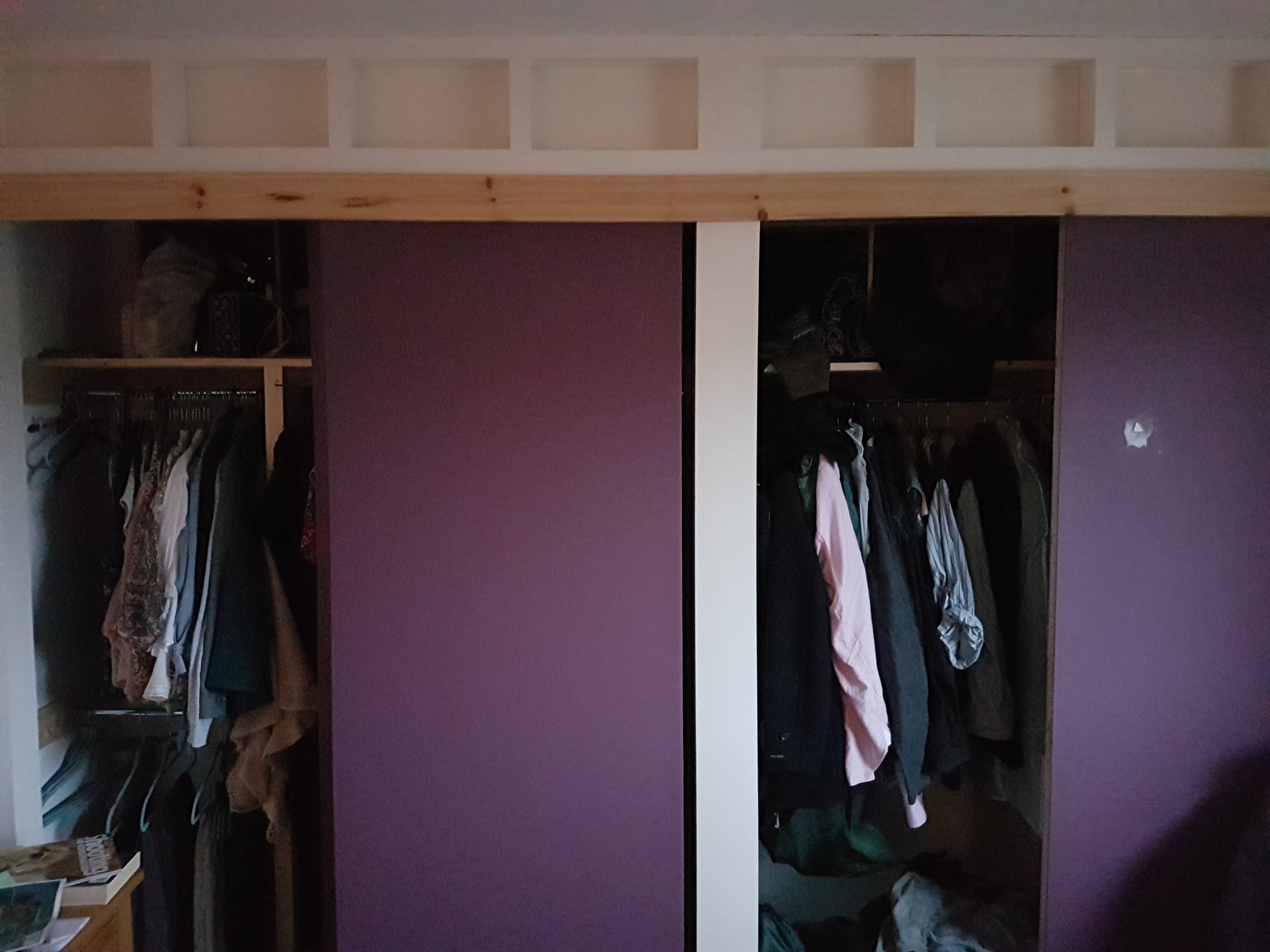

I'll be honest. I'd probably do as Kent did in my own house. Buy the frame and doors as a unit then build my internal layouts out of either pine furniture board or oak veneered ply and edge the fronts with solid oak. The internals are always a weak point with Hammond's/sharp Built a few wardrobes during construction in the past. Stud wall with the hanging rail fitted to the head and a door lining fitted around it . Was strong enough to hang 4 1hr fire doors off of and was in keeping with the rest of the property. No rails on the floor. Just discrete guide blocks screwed down through the carpet.
