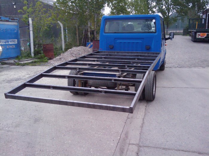

Looks nice, thought you would have had a vice mounted somewhere for the inevitable pit repairs!.

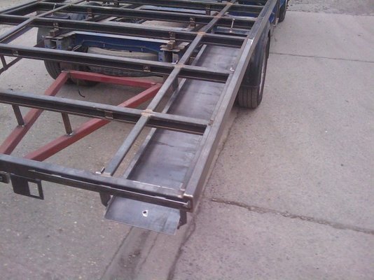

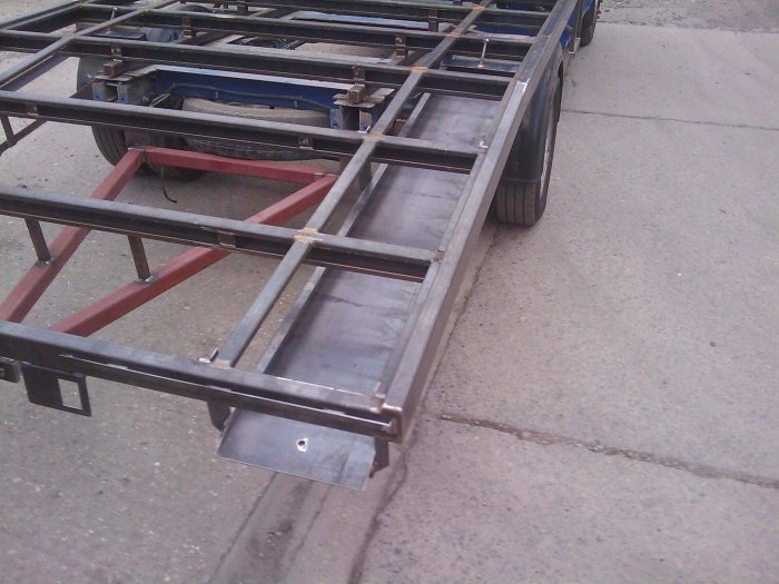

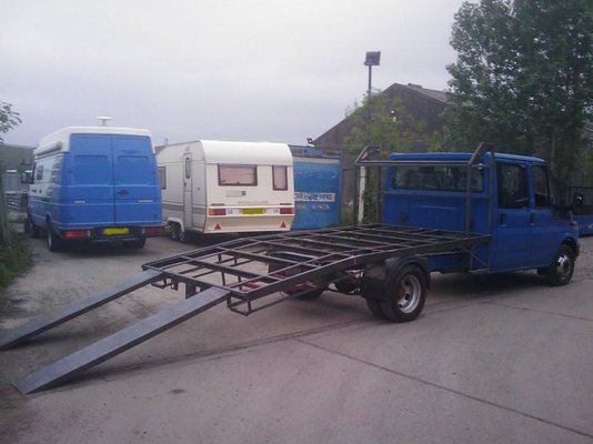

Do you have support for the ramps when loading or will the overhang take the load 'til the "heavy end" gets up behind the cab?

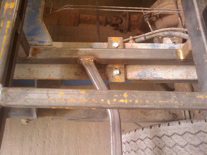

The winch will be mounted on two folded channels, you can see them in the middle just behind the cab.
Let the customer fit it himself, its was all drillled ready.
Ramps, you can see a bolt down through at the back, he had some pin things he wanted to use, so bolt is a temporary measure.
My mates got 1 on a short wheelbase like this and it cracked the chassis at the back. Its not built to nowhere near the standard of this but its worth a note for anybody looking to build one. As you pull the car on theres a massive amount of stress on the back of the chassis, no doubt it was probably overloaded at some point to start it off.
