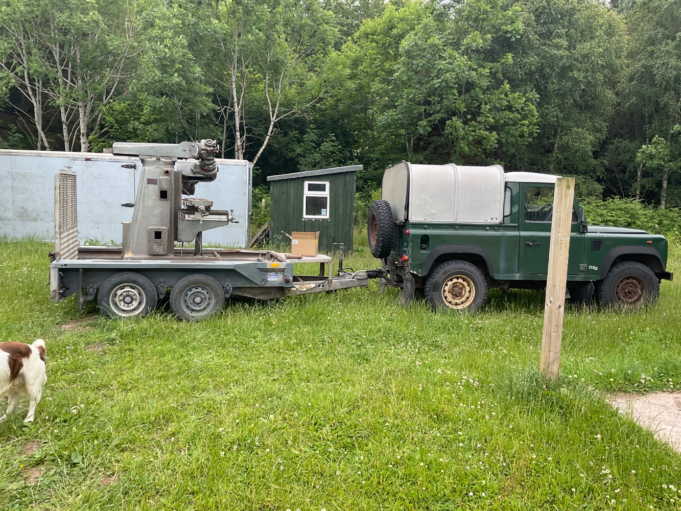

Just picked it up from the Northwards depot, sold by @Theblackbox and arranged by @fizzy - thanks to both, and also to @Jelly_Sheffield for some advice. A good lad there put the long forks on and posted it in the back of the trailer. Didn’t even have to take the ramp off:

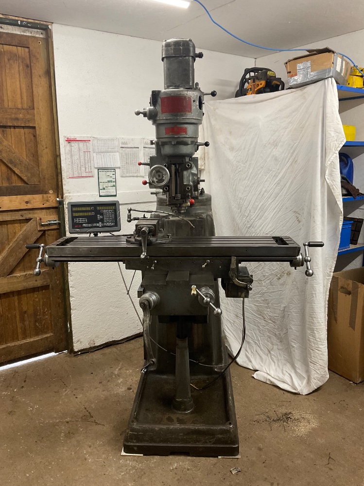

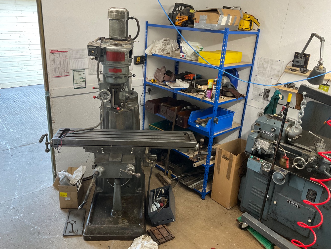

A quick wash with diesel and into the shop. The Quicke 3300 loader only just lifted it. Once outside the door, I found the engine hoist would lift it, but the wheels locked up so it wasn’t much help. In the end, I picked up just the back end with the hoist, and used a big pinch bar to move it along. Once in place, I used a die grinder and scotchbrite wheel to take the rust off the table:
Mark I?

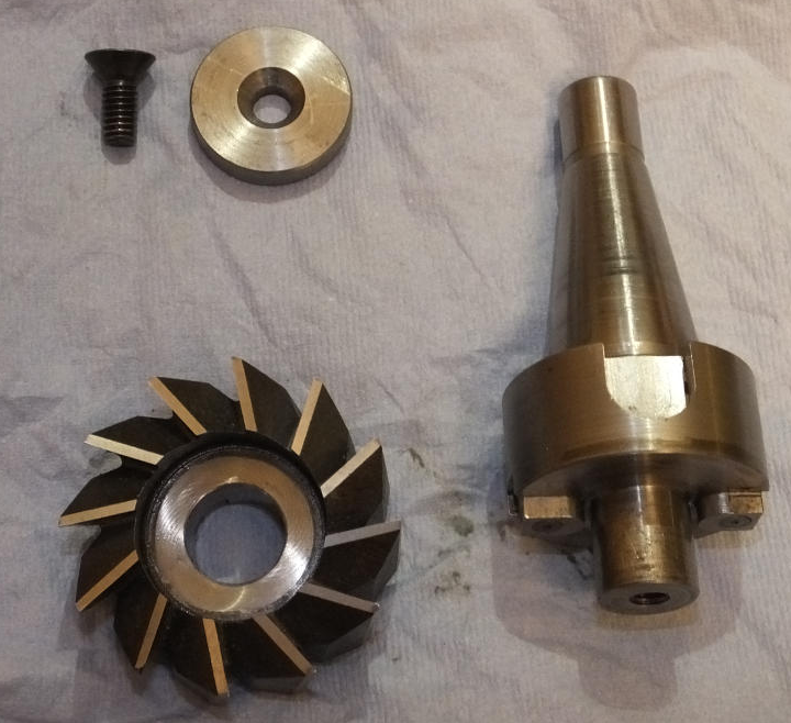

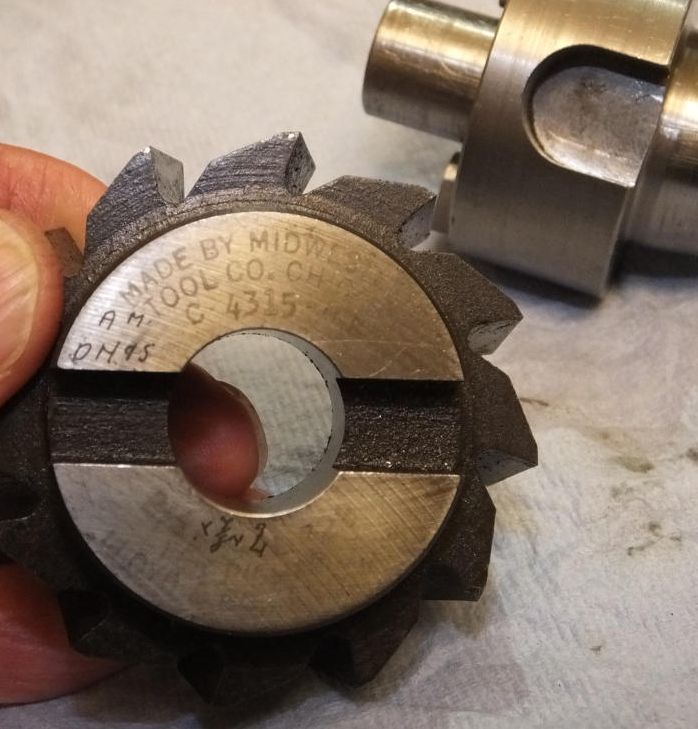

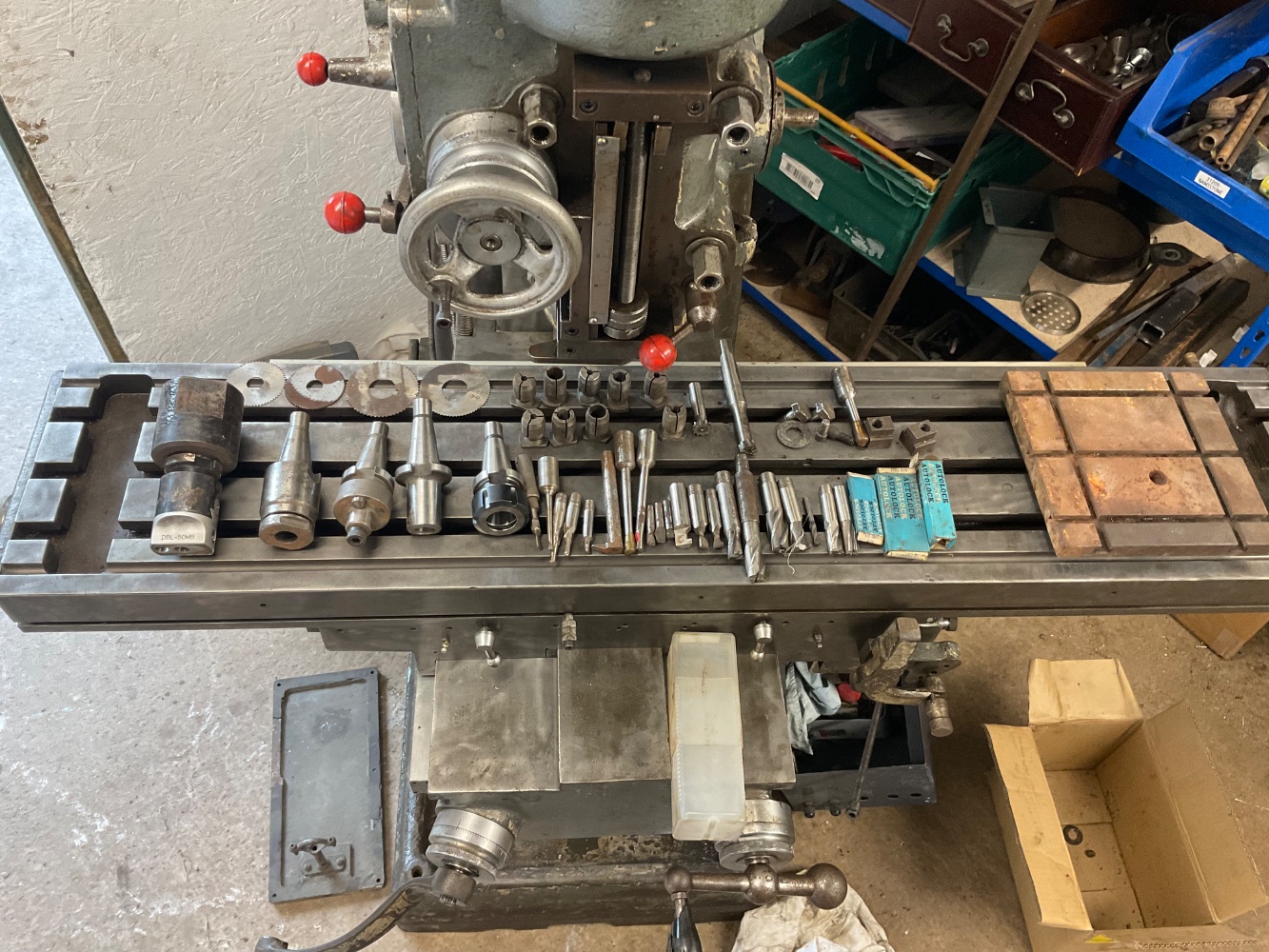

It came with some tooling, ISO 30 I think:

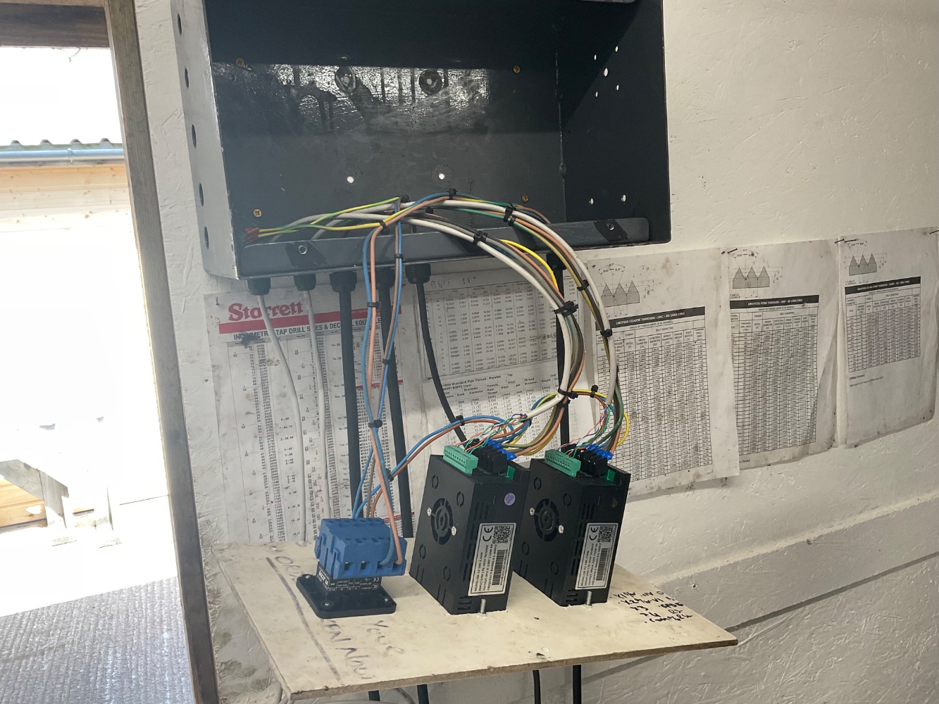

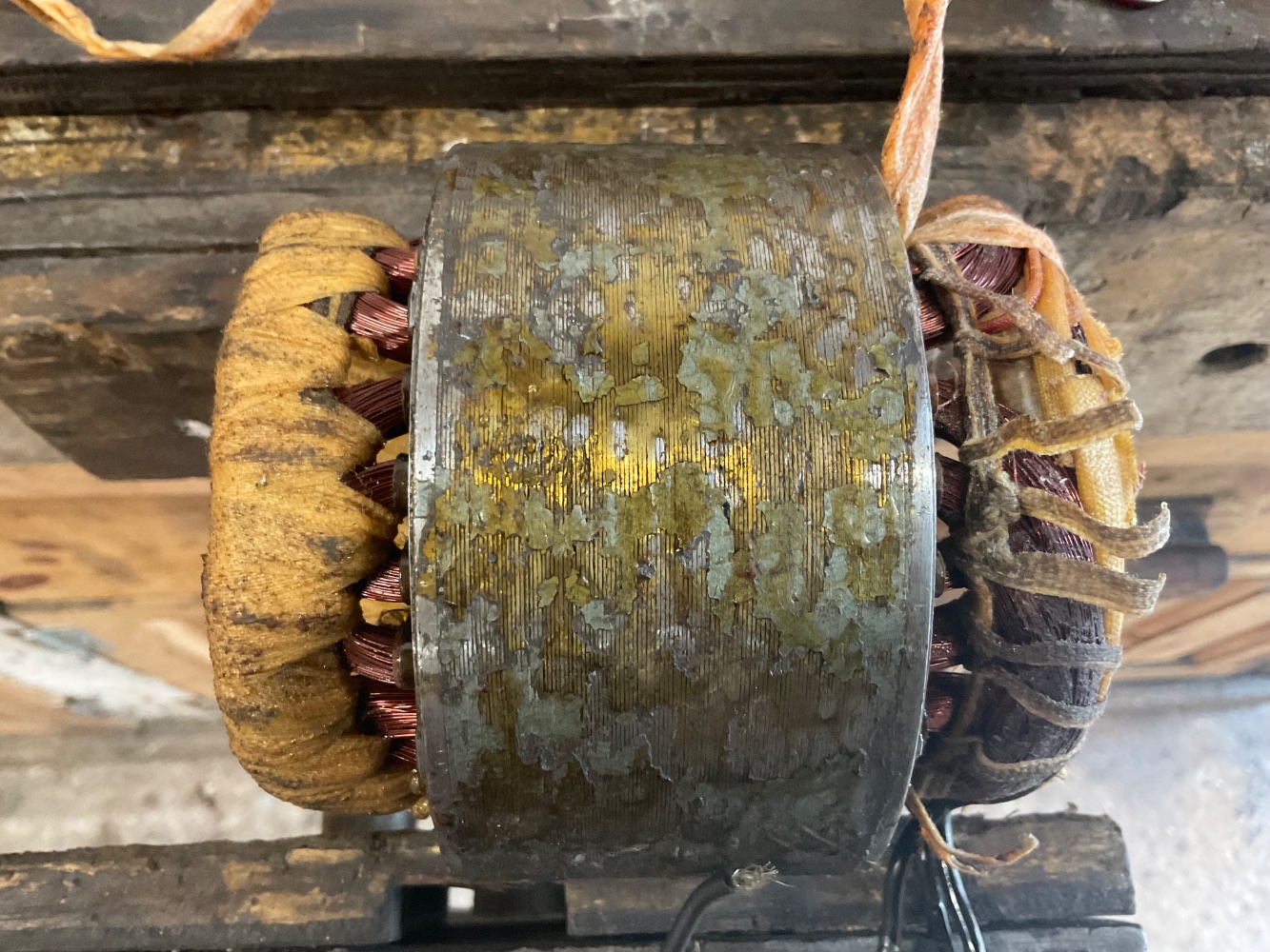

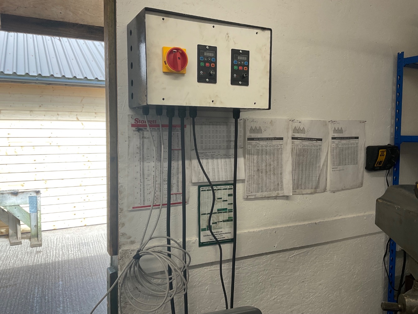

2. Newman 1 hp motor - a bit piddly for this size of mill? Anyway, extract star point and inverterise. Maybe power the table feed motor with one of those DPS units.
