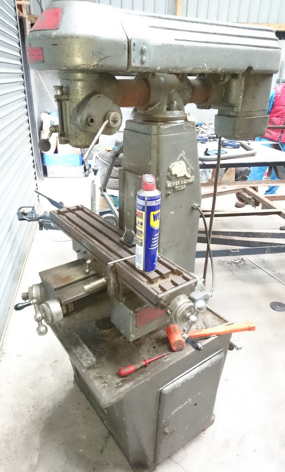

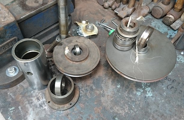

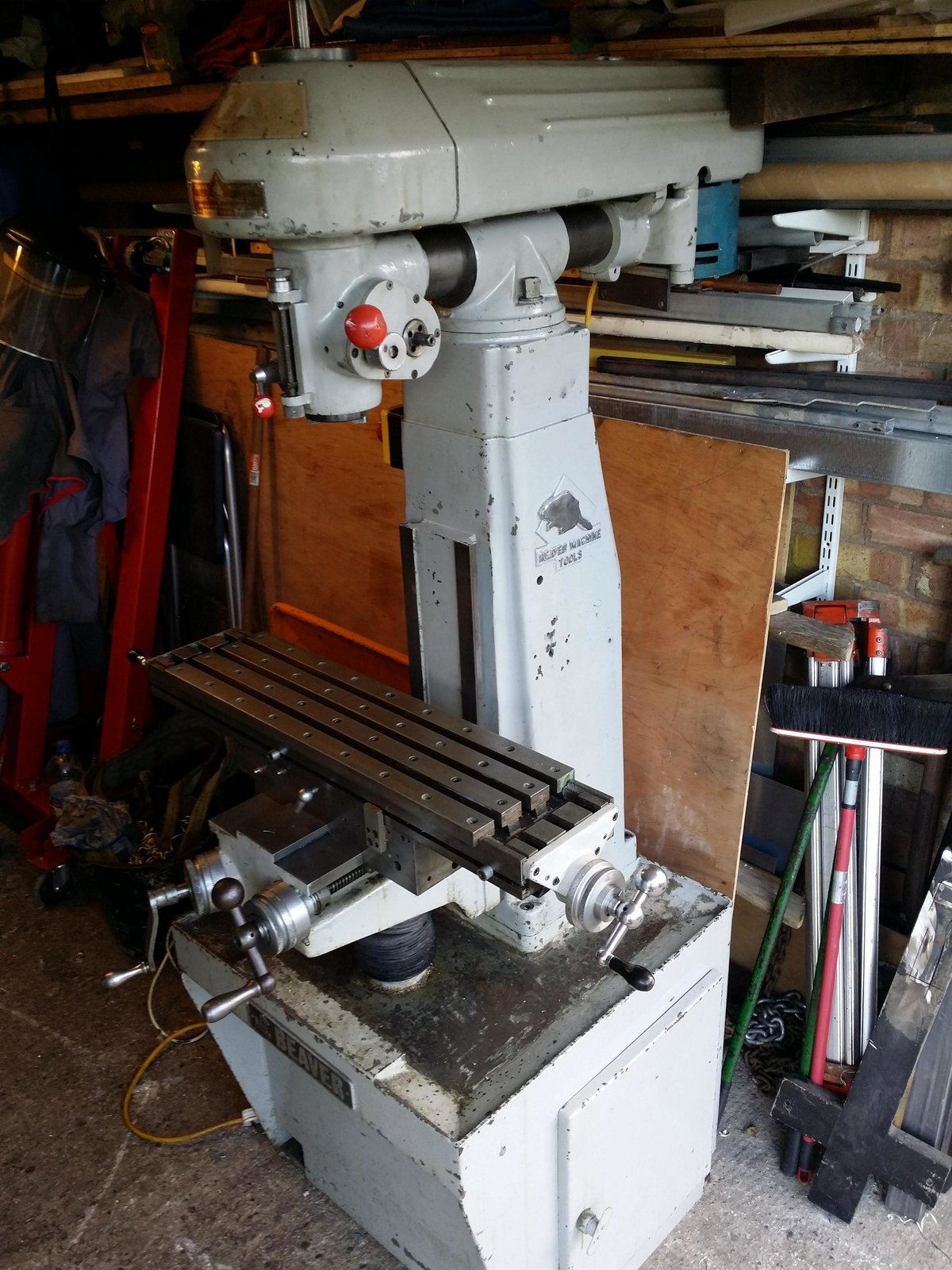

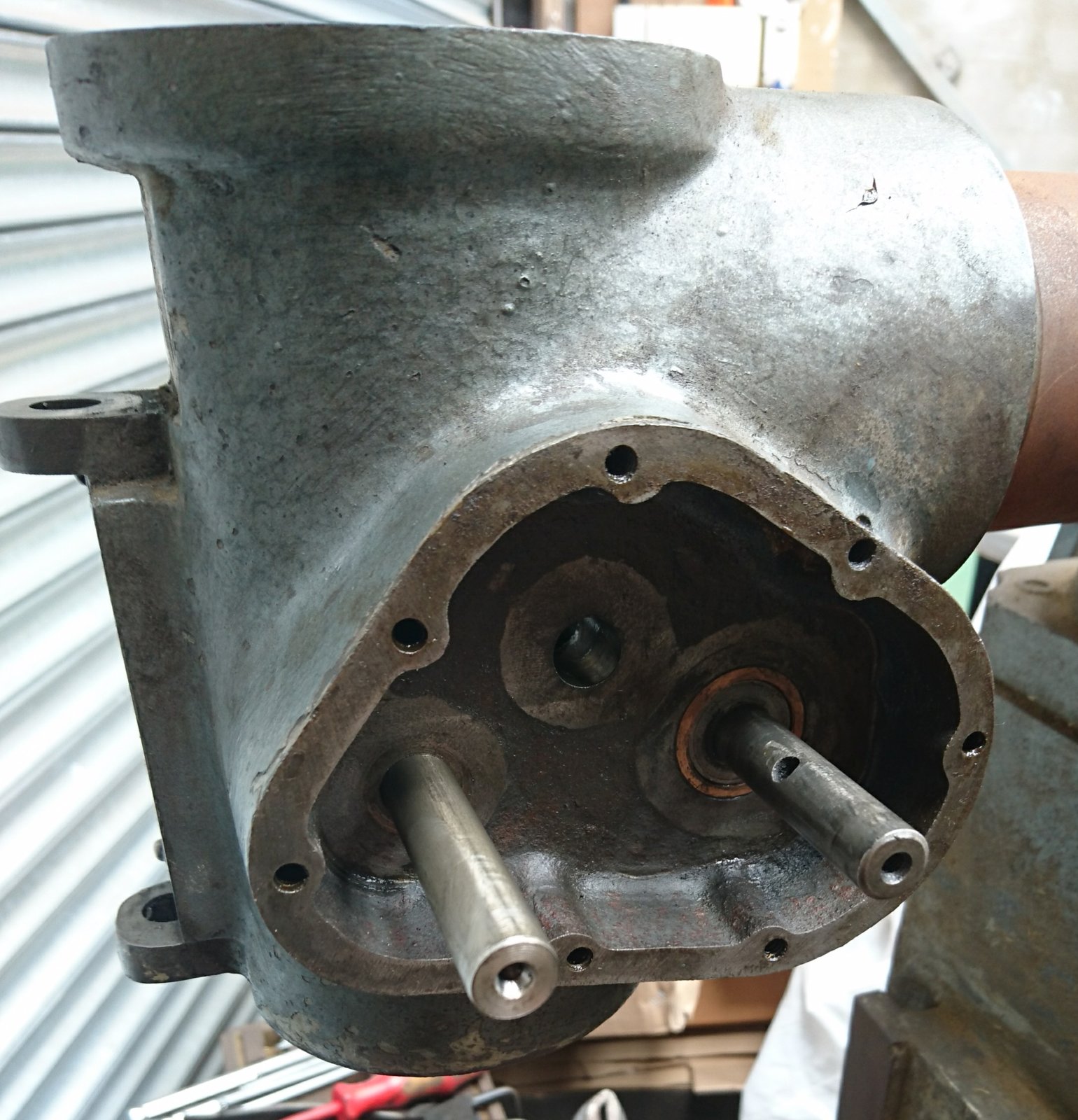

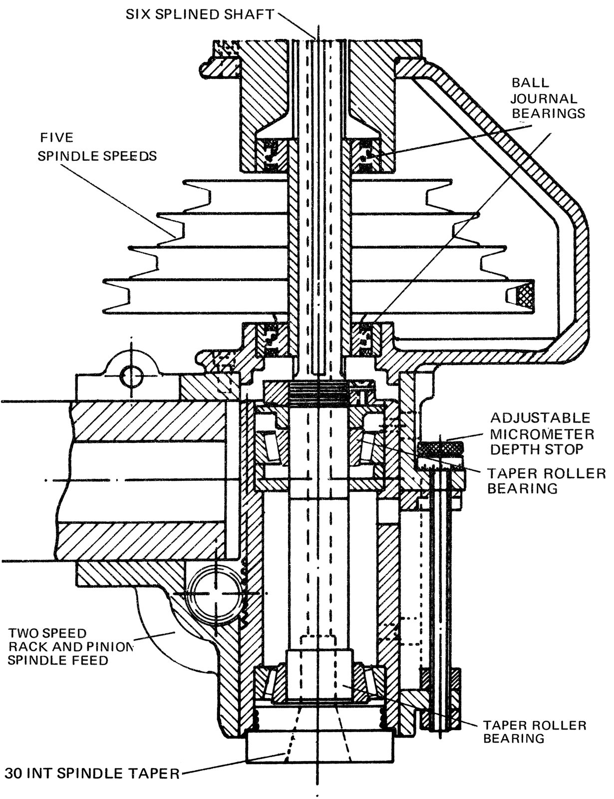

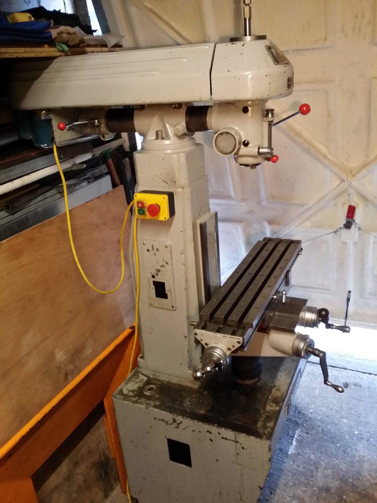

Hi folks,

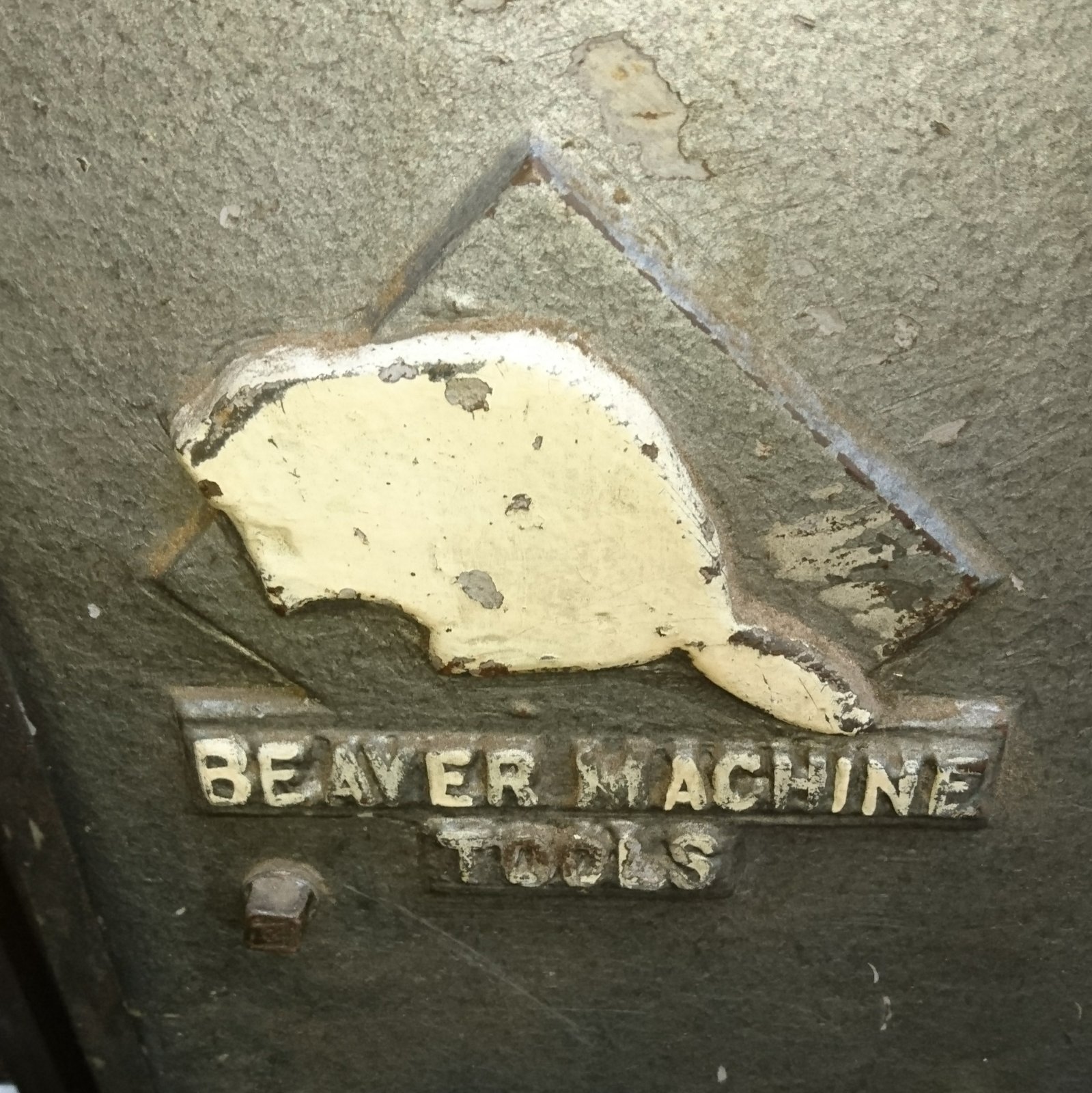

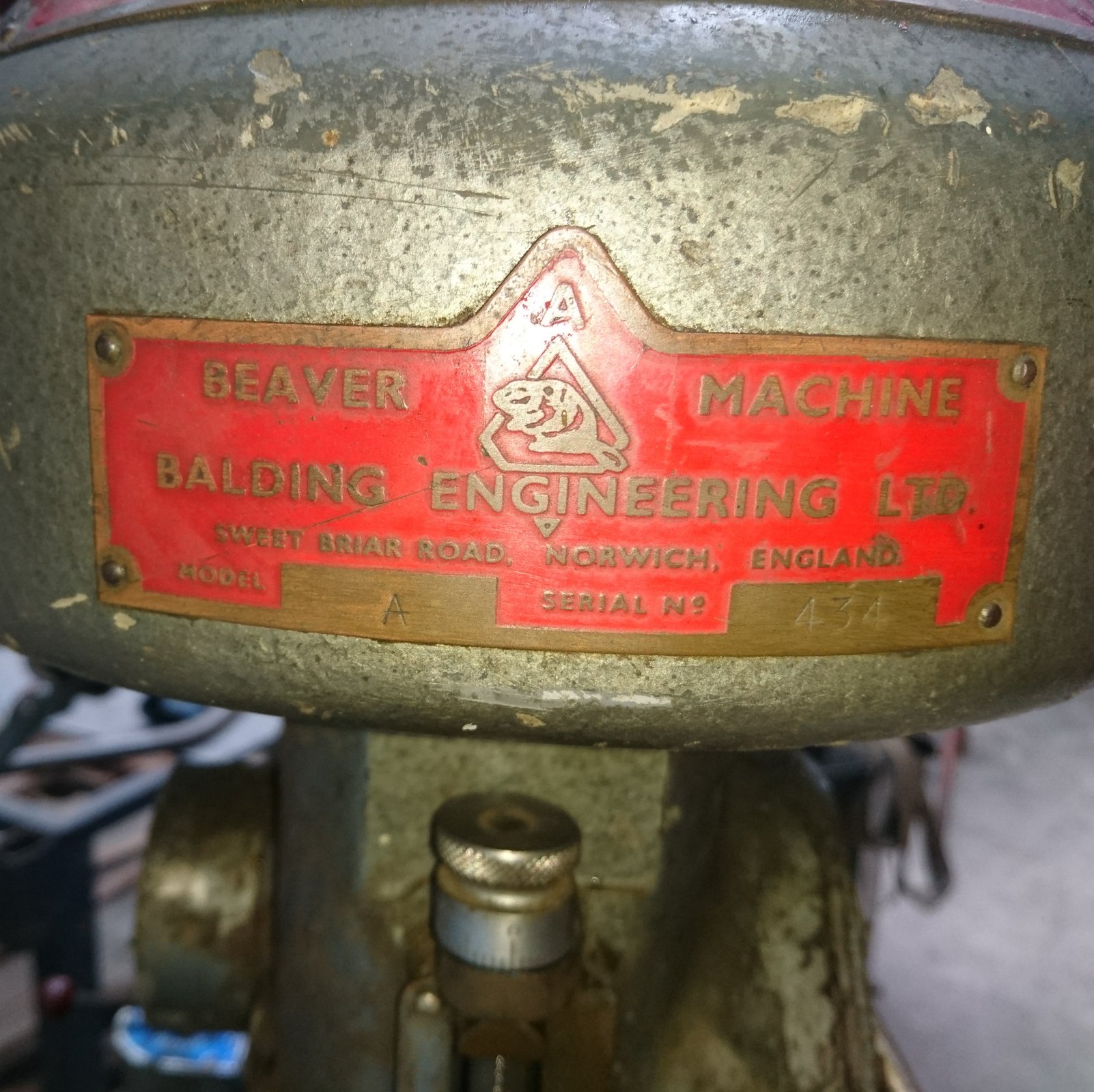

Struggling to find much info without buying the manual from lathes.co.uk which funds don't allow atm so I'm posting this as a place for me to put info I find for others to use if they have one of these machines (if you do have one let me know!!).

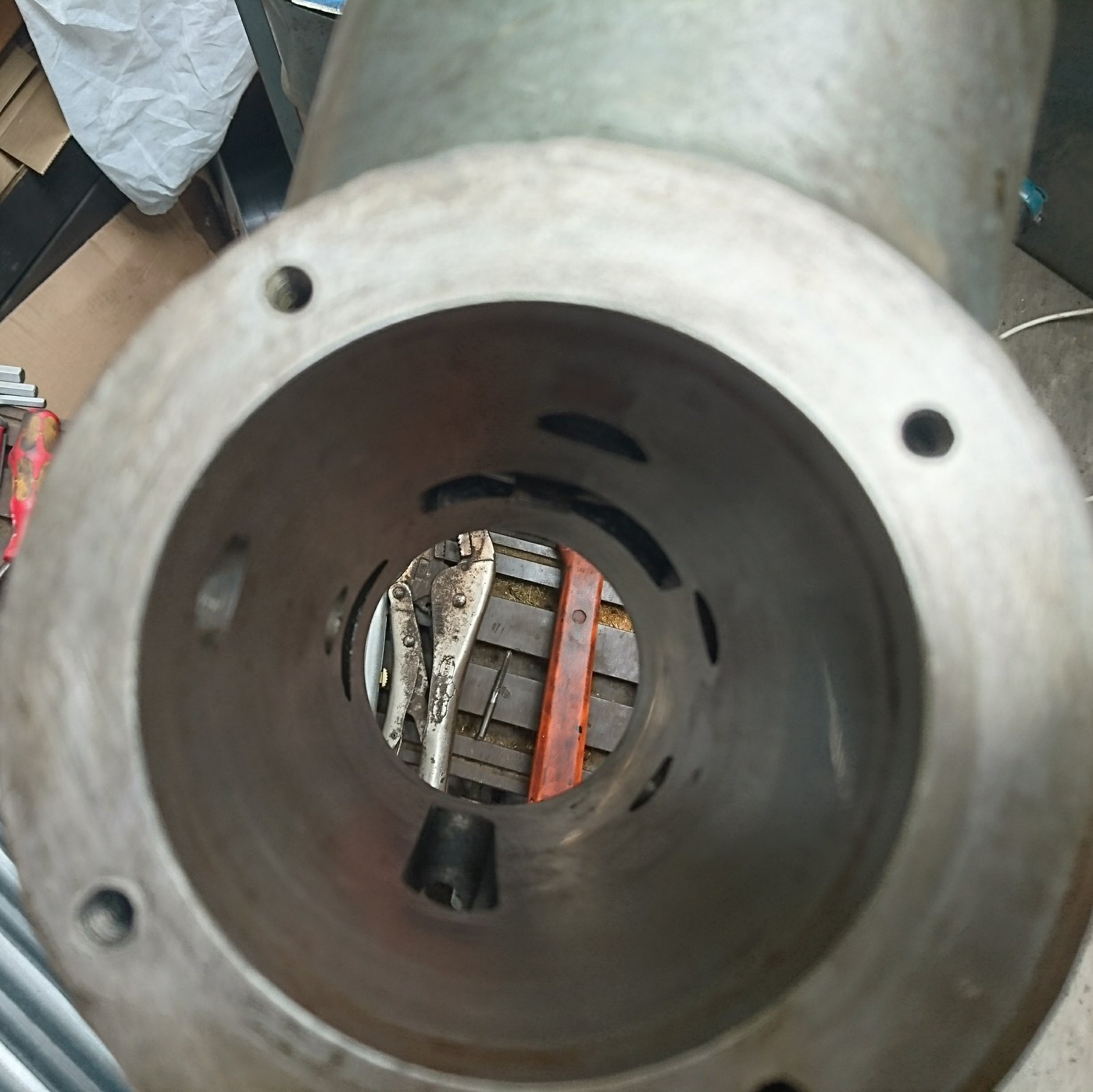

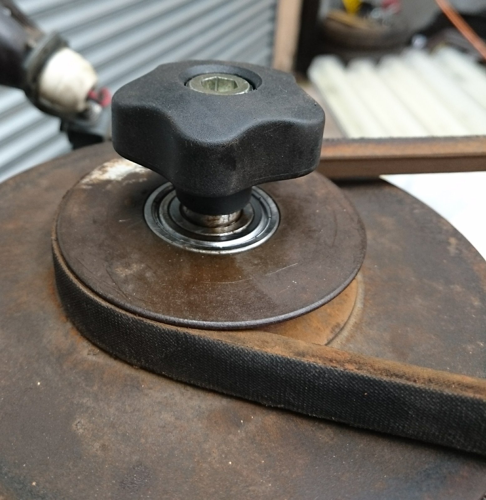

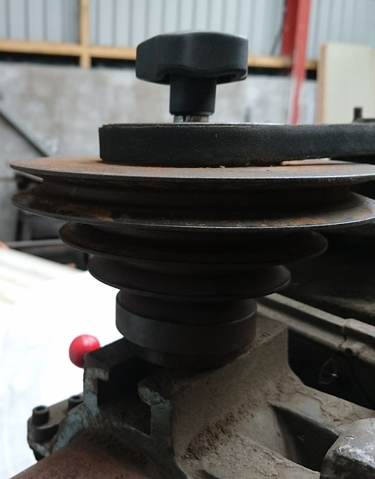

Here is the pics I have of mine so far, I've stripped the spindle as the bearings were noisy spinning by hand so figured at 2000rpm they'd be well gone!

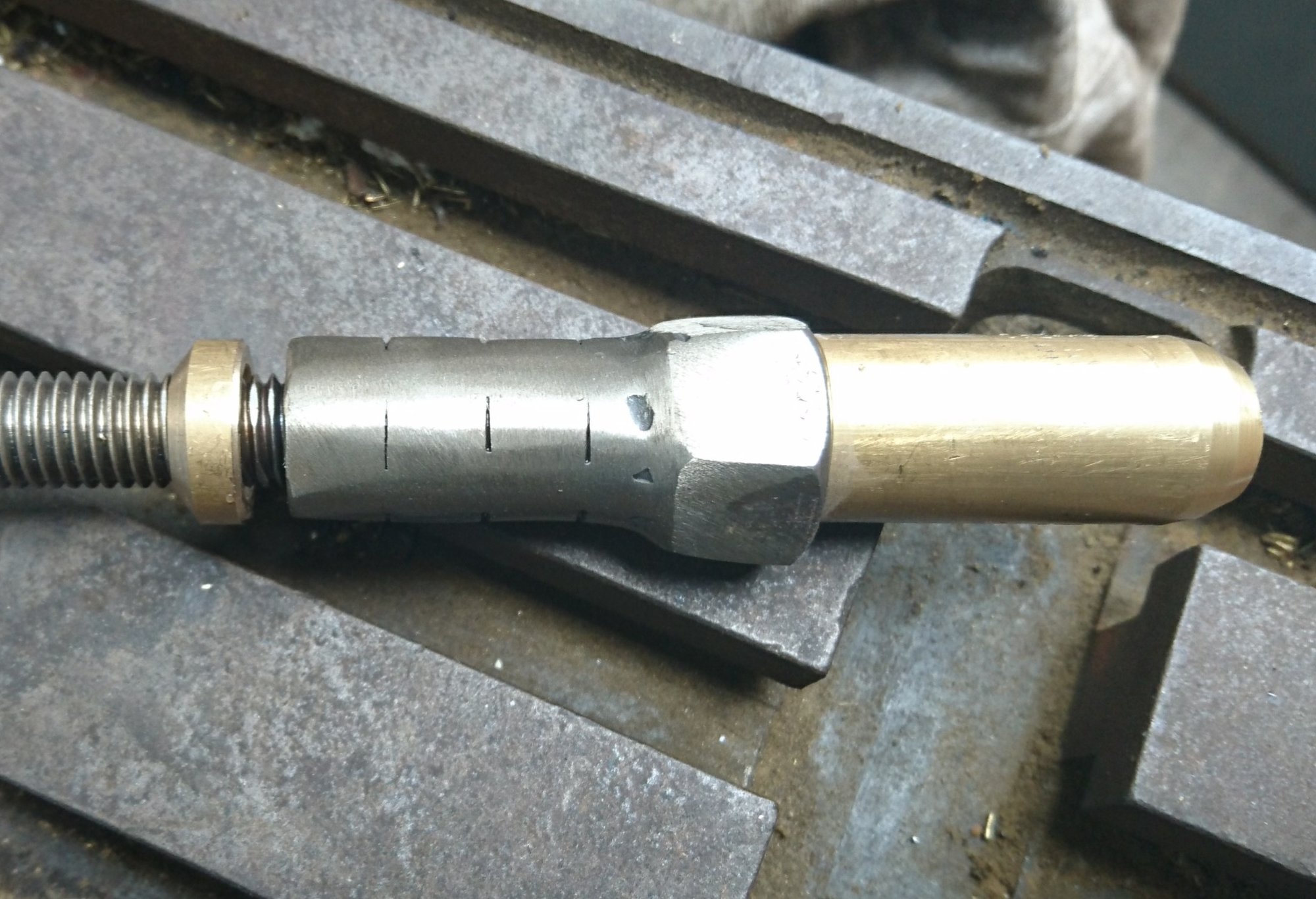

Also some pics of the drawbar I've made as mine was missing.
