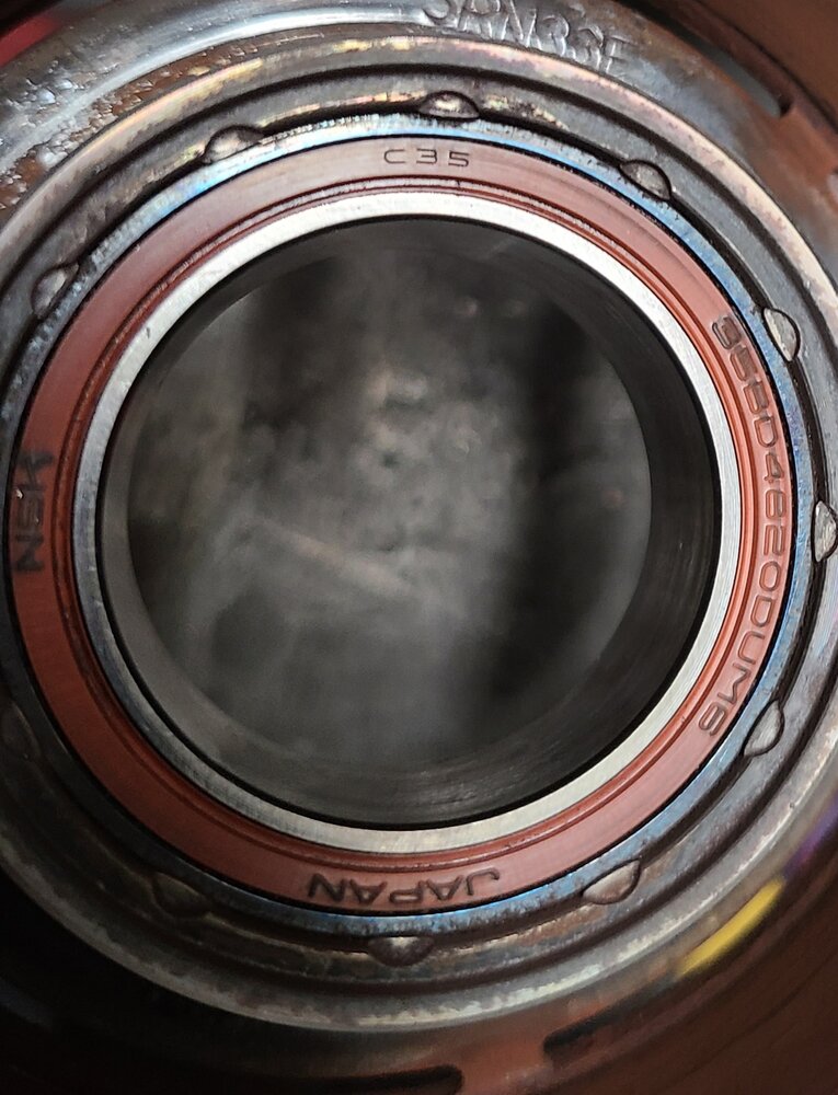

SWMBO's CR-V started making an odd noise this afternoon. The AC pulley was intermittently rattling and squawking. You could see it wasn't running true, then it'd shudder and have a bit of a gallop before settling down again for ~15 seconds.

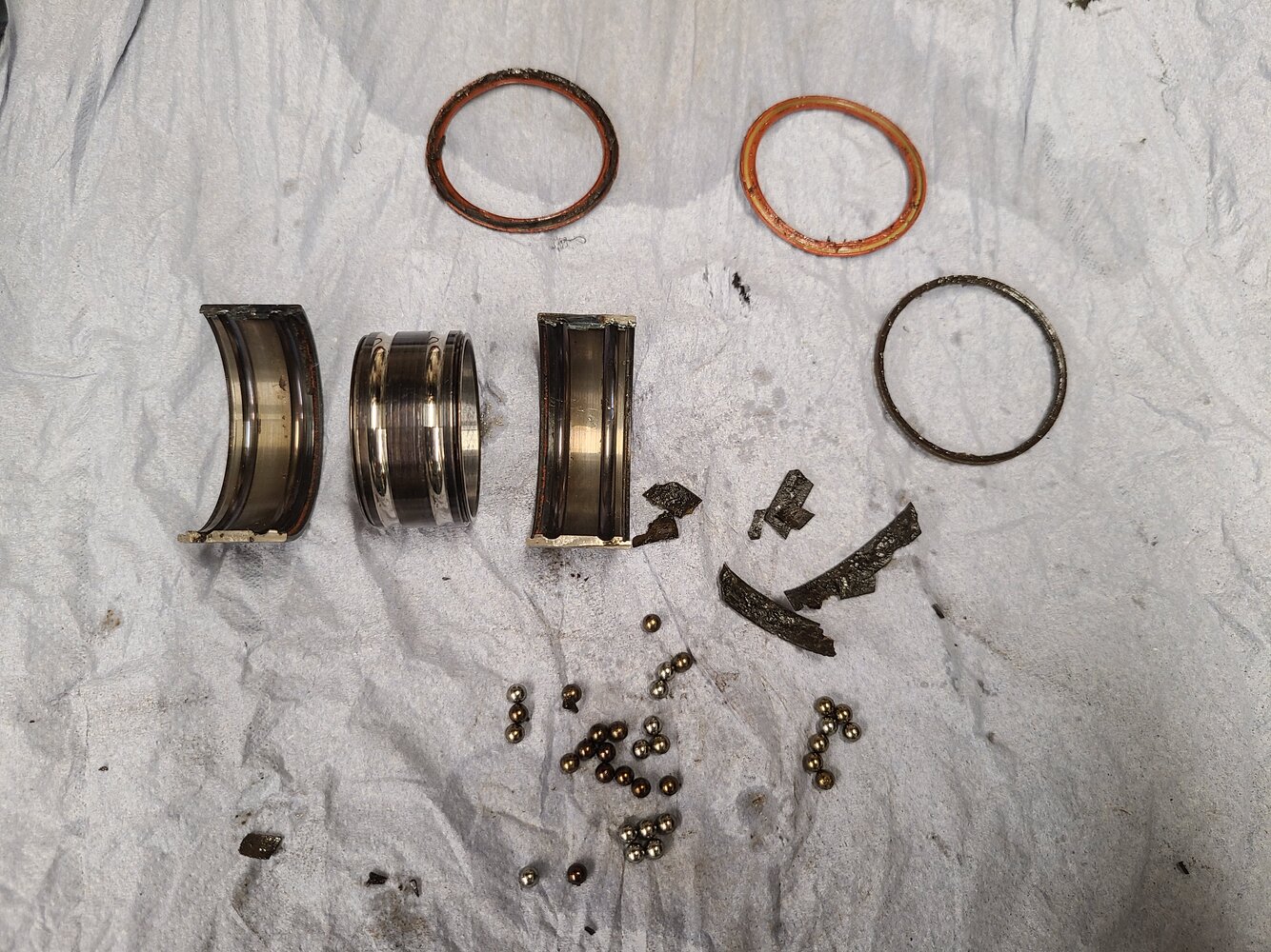

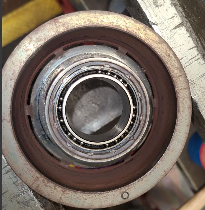

I've had it in bits this evening, the bearing felt ok but sounded like crap, but I knocked the pulley off (not trivial in itself) and pulled the inner seal to see if it wanted some grease. It's a special looking double row ball bearing but inside, there were no cages on either side. It looks like it might have been a polymer cage if anything, but there's not enough debris inside to convince me that there ever was a cage.
My question is......is this normal? it's not like any bearing I've ever seen before but I can't find a datasheet to see what it should look like. If the balls aren't evenly spread though, it would explain the movement and vibration in the pulley
I've given it a lick of grease, popped the seal back in and put it back together to see how it went and it seems happier, but I've left the clutch off for the time being so it's just running as an idler. The inner race isn't precessing so I'm not too concerned about it doing any damage to the compressor housing. I'll look to order a replacement pulley/clutch since the clutch has already had the shim stack reduced a couple of times, but I'm now wondering how close it is to grenading and whether I should send the boss to work in it....
