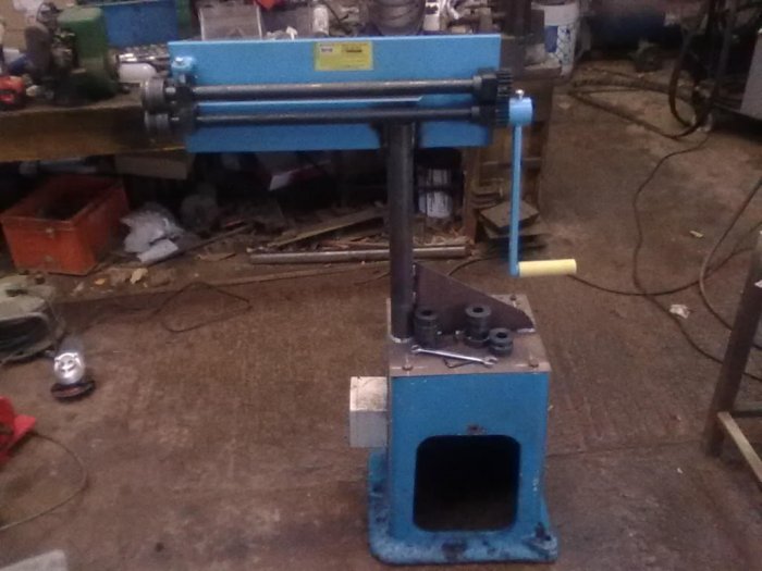

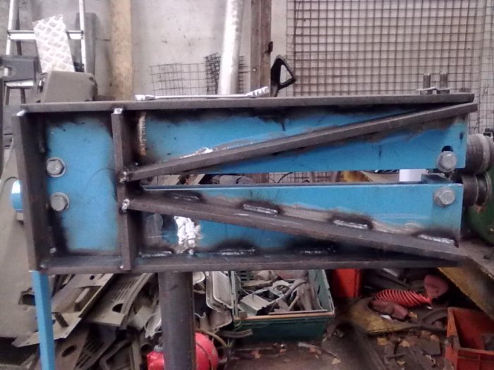

i bought one of these machines, it was delivered the other day. If you wan't to fanny about with .2mm sheet steel your laughing, anything over that your going to have to think about strengthening it!
I welded it to an old cast iron base, put a piece of 1.mm sheet through and all i got was deflection of the dies, and a **** e bead! pure crap!
