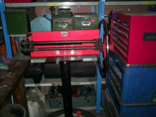

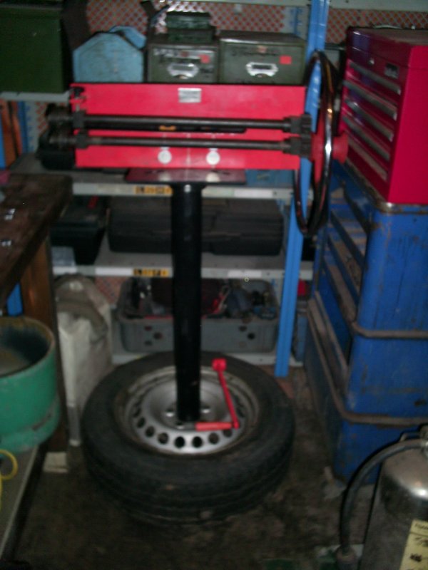

Instead of mounting my bead roller in a vice when I needed to use it I have utilised a Clarke stand to mount it to but also allow it to be dismantled easily if the stand is required for something else, like another grinder!
I utilised a piece of galvanised crash barrier as the mount between the stand and the bead roller. Modified a wheel to give a tight fit to the stands shaft to make it more stable and modified a bar stools foot rest to replace the handle to turn the bead roller. The modified wheel makes the turning a lot easier and more controllable.
