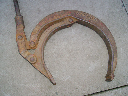

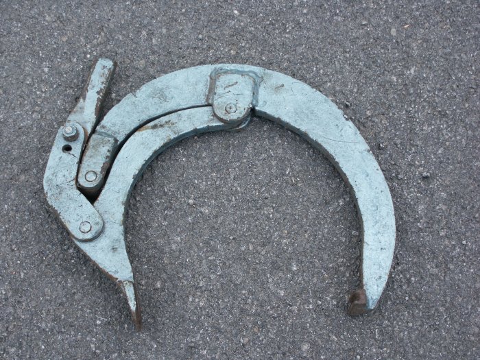

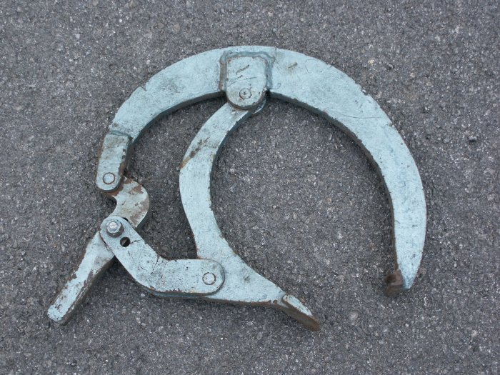

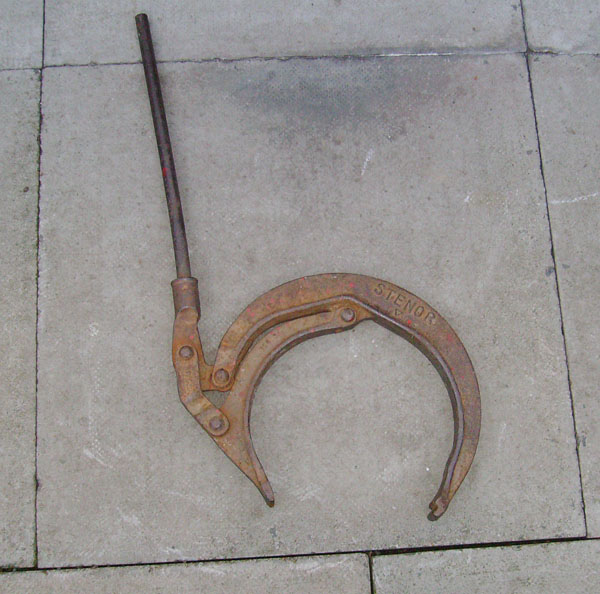

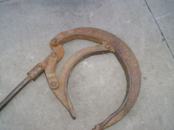

Noticed one of our new members is building a bead breaker, so thought I would show you this one I figured out and made over 40 years ago, Fits everything from a Mini to a Land rover on 750s, made a working model from thick cardboard to sort out the sizes and pivot points etc, with a 4 foot operating tube for leverage tyres sqeezed from the bead in seconds, and truly portable into the bargain.
