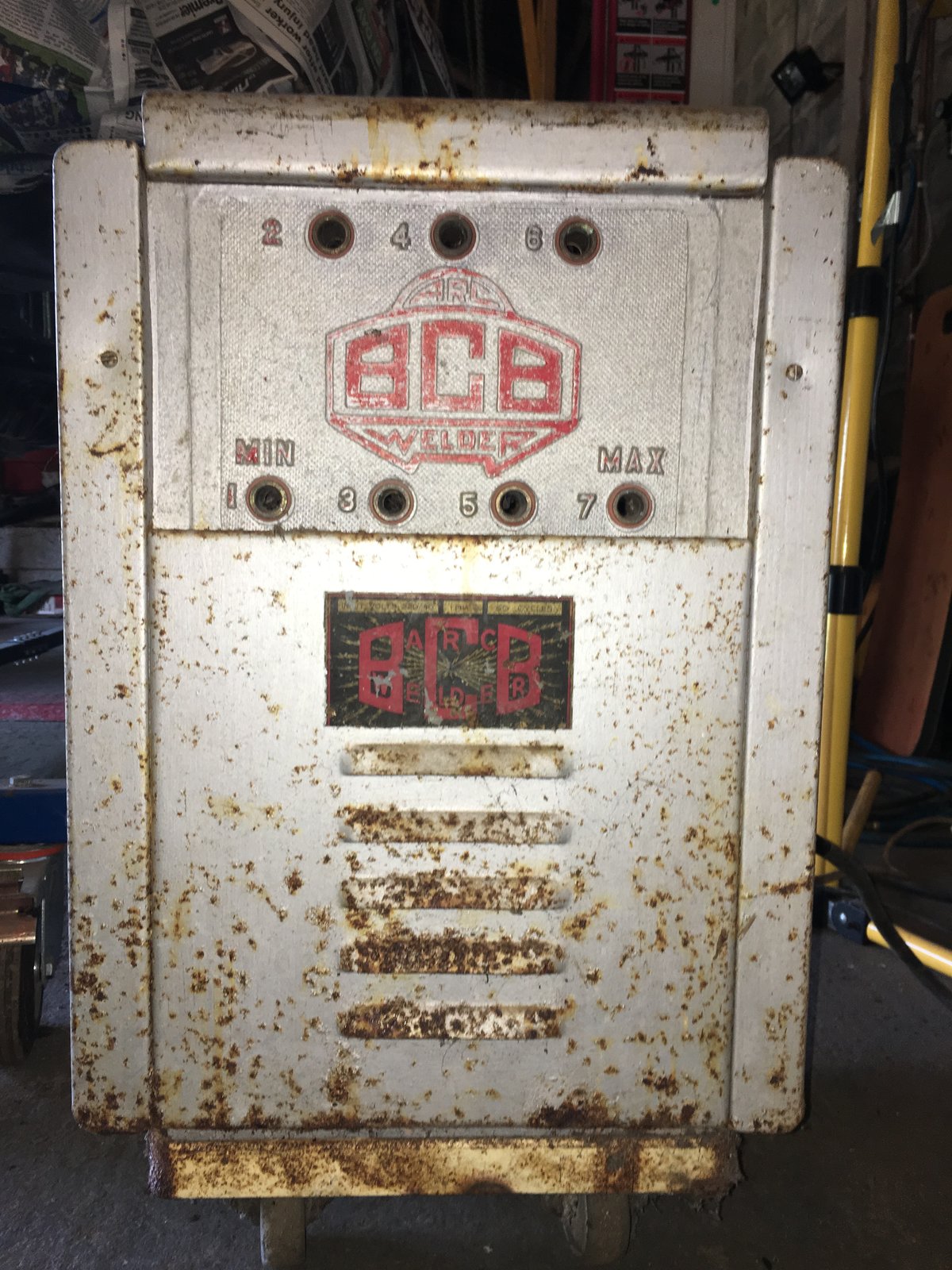

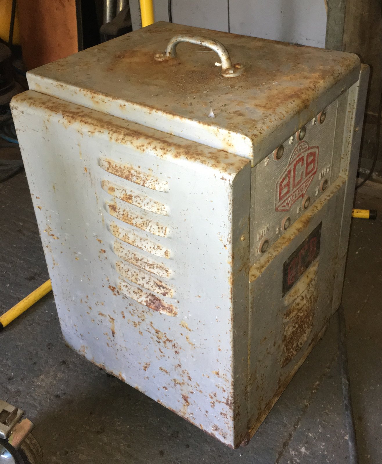

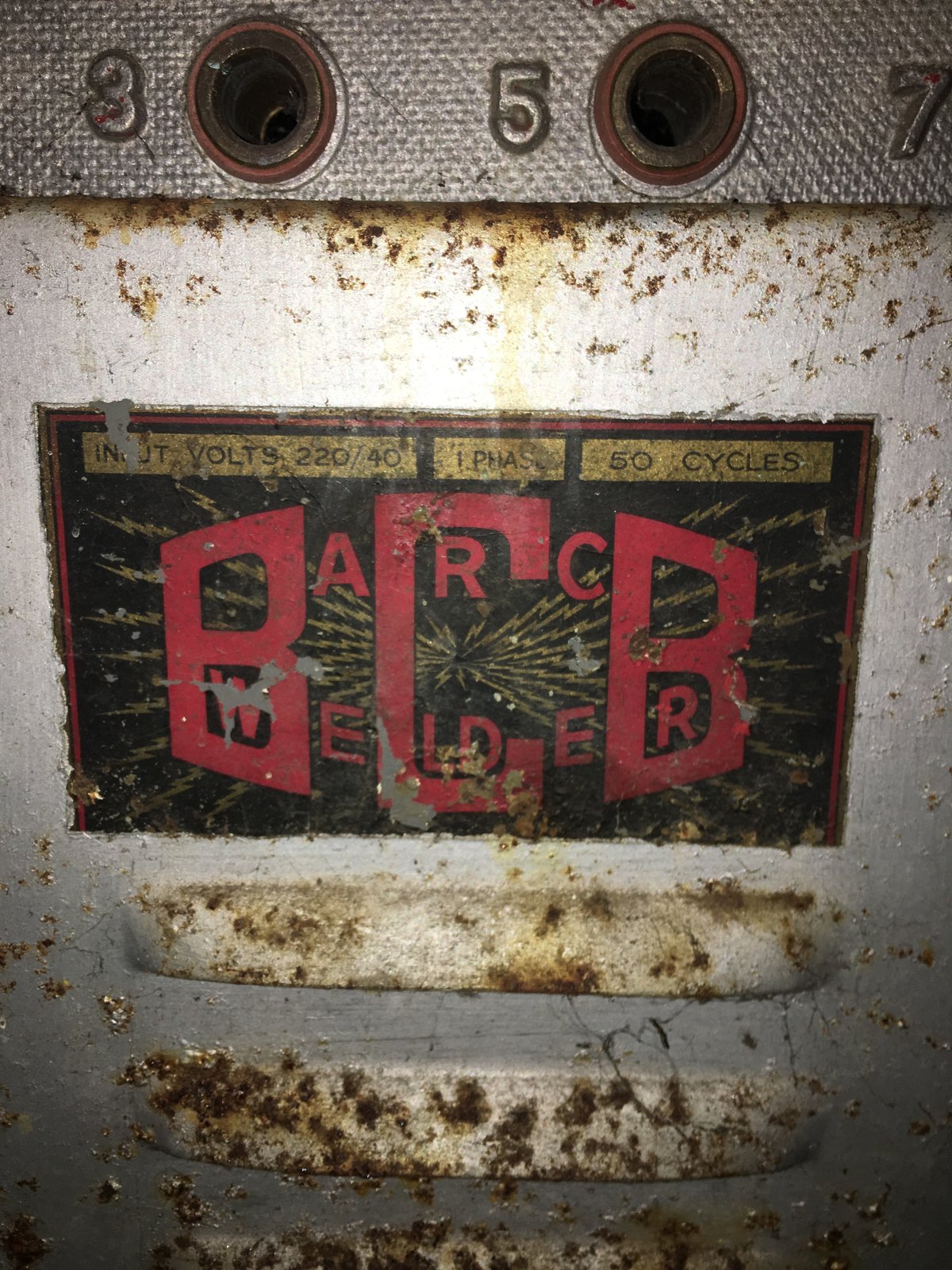

Jeez, I don't think I'd even plug that in! Maybe ought to be in a museum.
Probably is middle 30's or 40's

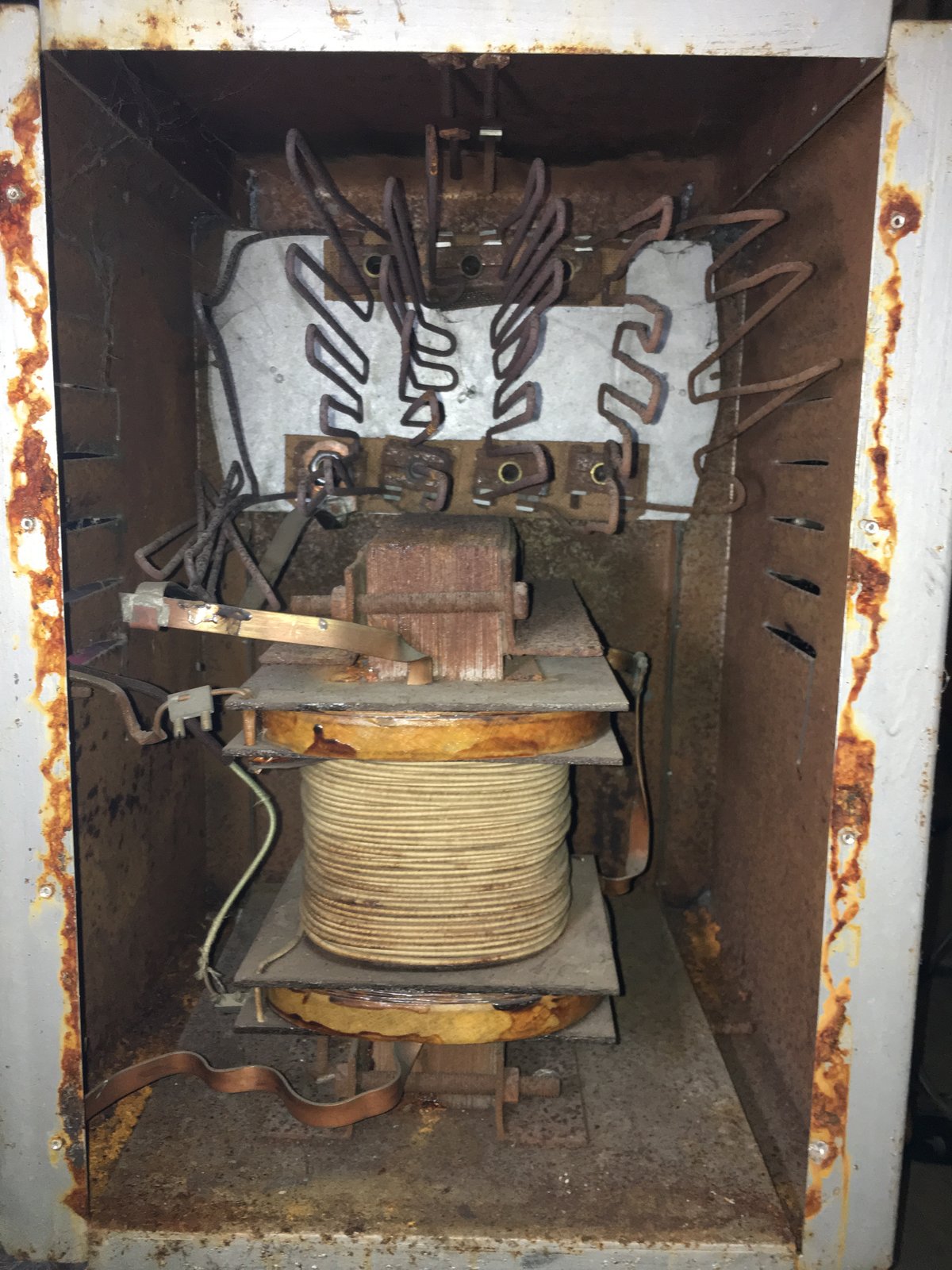

Thank you for the interesting photos from the inside.
With all those louvres on the cabinet, and the age of the machine, I doubt if it originally had a fan. It would have simply been "air cooled".

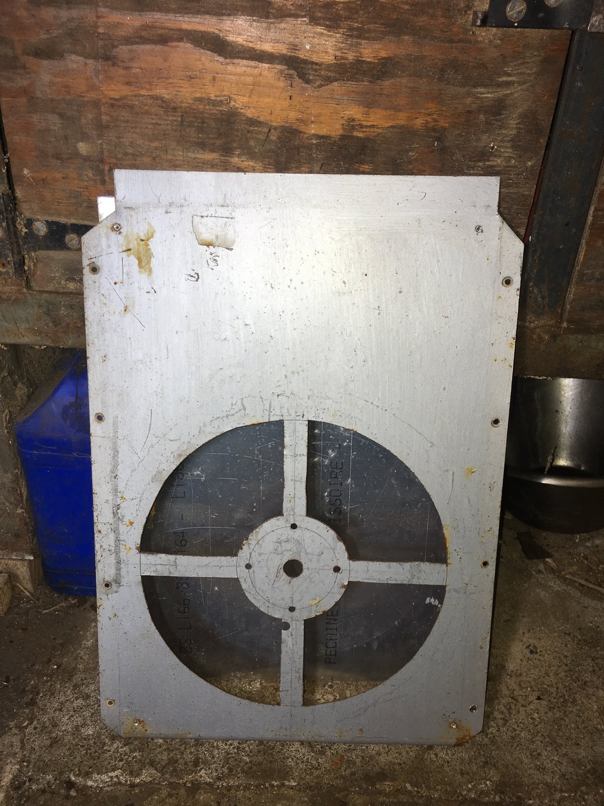

Only later do we get the "turbo" designation for fan-cooled welders. I think the aluminium plate was added to support a computer-type fan, but apparently the fan itself has gone missing....
The transformer secondary seems to be two linked sections wound with copper strip. Rather than tappings, the power selection sockets are wired to resistors. That is quite crude, wastes power, and explains why it gets hot! I agree with jinjahbiscuit - it belongs in a museum.
