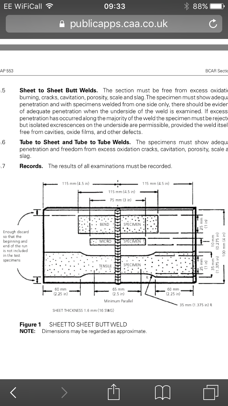

I’m new to this site and was looking for any useful information on Aviation welding BCAR A8-10.
I work in general aviation and was wondering if any body could advise me on what are the best/ most common codes people go for in aviation welding.
Any help would be great. I am new to welding also.
I suppose it depends where you are working, MRO or manufacture?
What sort of aircraft?
That might help decide what material types you submit and what sort of joints.
Hello.

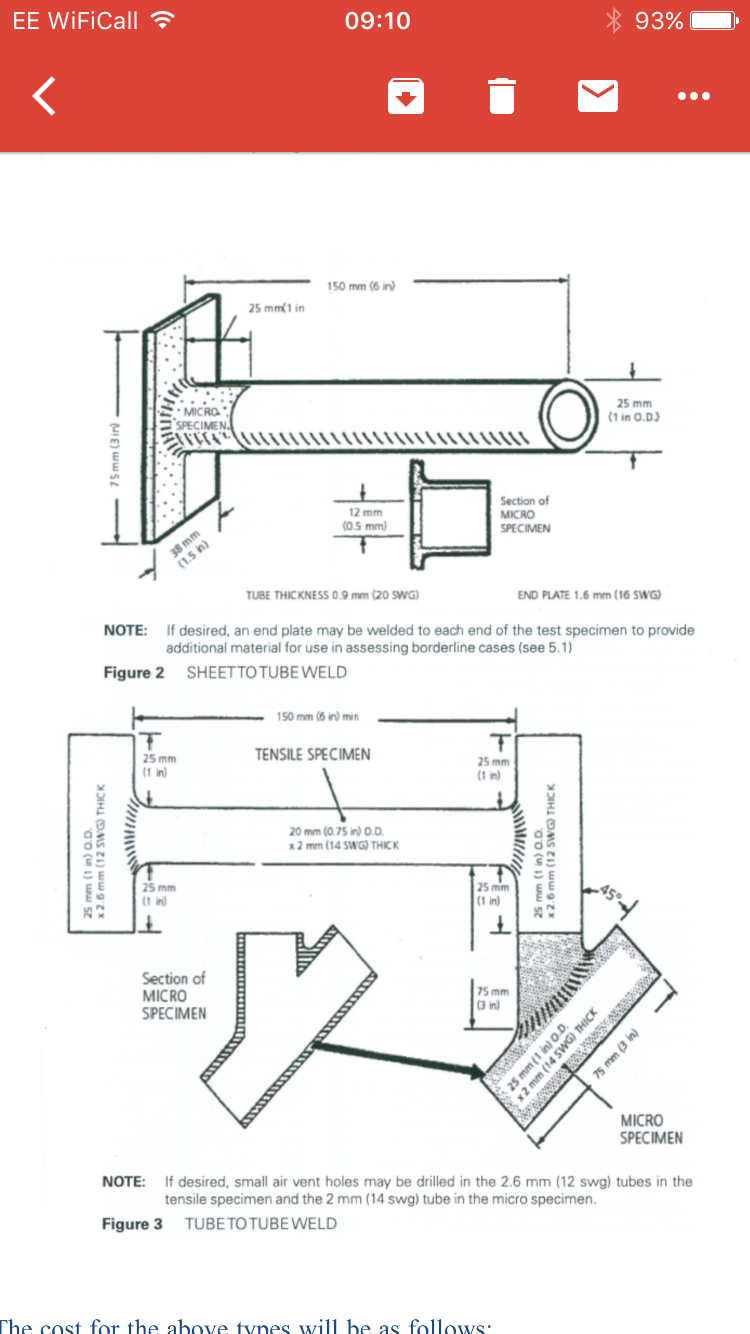

I’ve just been through this. You will need to supply the samples as listed in BCAR A8-10, to an approved test centre.
Once you receive the test results these need to be sent to The CAA. They will then issue docs to say you are approved to weld on the grades you had tested.
If you think the test samples will not cover the joints, and or thickness. then samples of those also need to be tested.
I used Keighley labs in the end, @£65ish per sample.
I was going to use someone else but they wanted a ridiculous amount (£100s per sample).
