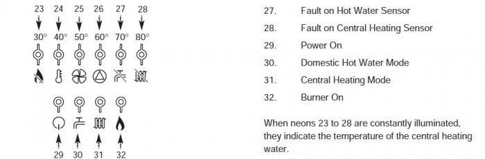

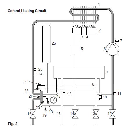

Now, when the programmer and the thermostat are shouting for heat the boiler fires up and runs till the CH water is up to boiler temperature, when it shuts down the CH pump shuts down as well, the effect is almost as soon as the rads get a bit heat the pump stops and they cool down again.
My question is -- should the CH pump not run continuosly as long as the the programmer and Room thermostat are asking for heat.
when the boiler detects the water cooling down it fires up and the pump runs again till the next time it senses hot water in the CH system.Then shuts boiler and pump down.
