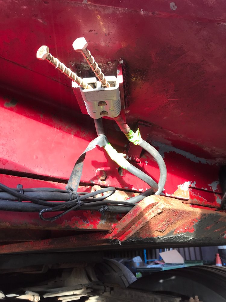

Even folded back the cable is still a loose fit in the connector. Just too big for the job.The easiest get out is to fold the strands back on themselves, you might have to pare (corrected as spotted by seadog) the folded lot down.
They have to be a good snug fit before crimping
The smaller ones are physically smaller as well as the pinsThe pins for the andersons are available in different cable sizes.
And these contacts are compatible with other so it’s possible to have different size cables connected together. But the smaller cable size will be the limiting factory for current capacityYou can get the pins to suit different cable sizes for the same housing.
Ah, Shed End Ding!There marked sheng ed di! That quality well known brand!
Are you leaving the power lead connected all the time?Ive a tipping trailer for the back of the quad, powered by the quad battery. Sick of these pants connectors
Any one any better suggestions?
No its on a trailer. Gets used every 2 or 3 days. Ill fit new genuine anderson later today. To both ends see, how long this on lasts.Are you leaving the power lead connected all the time?
We have hundreds of them at work, very rare for a grey anderson to go wrong, on the other hand the orange metal andersons are just plain crap.
Its just a crude version if this!You could always use an adapter…..
Not a mock up, some comedy genius presented this to me today for inspection![]()

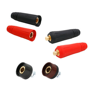

Crimping is preferred for production reasons chiefly. With a calibrated tool it's simple to make a reliable connection, you can get any monkey or robot to do it. Soldering takes skill just like welding so you need competent staff. Electrically soldering is usually better but perhaps not by much to matter. Its more important on high speed signals than power transfer.There is a lot of fakes out there.
How are you going to attach them? Crimping is the preferred method apparently.
If they are the ‘fixed’ end - ie the end bolted to the vehicle, I tend to solder them.
Not so. My old job we did extensive testing and found it didn't really matter (if you had skilled technicians doing the soldering). We tended to do both (crimp then solder). The ONLY think that matters for flexing is strain relief. For water it's waterproofing that connection, doesn't matter whether its crimped or soldered.For a connector exposed to vibration, water or regular flexing a crimp is far more reliable than a soldered connection.
