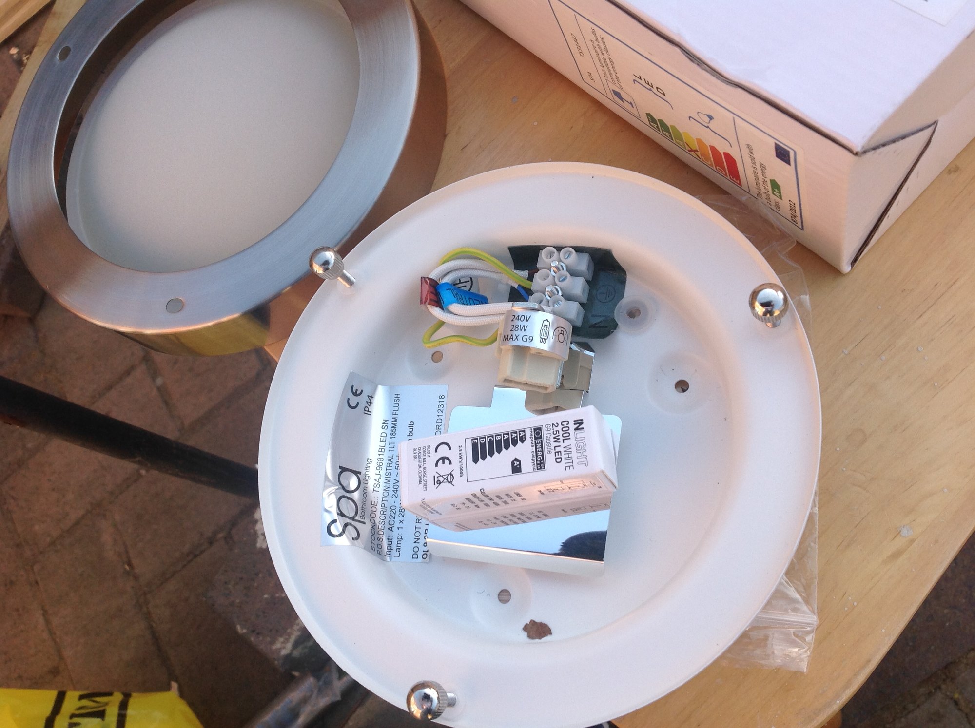

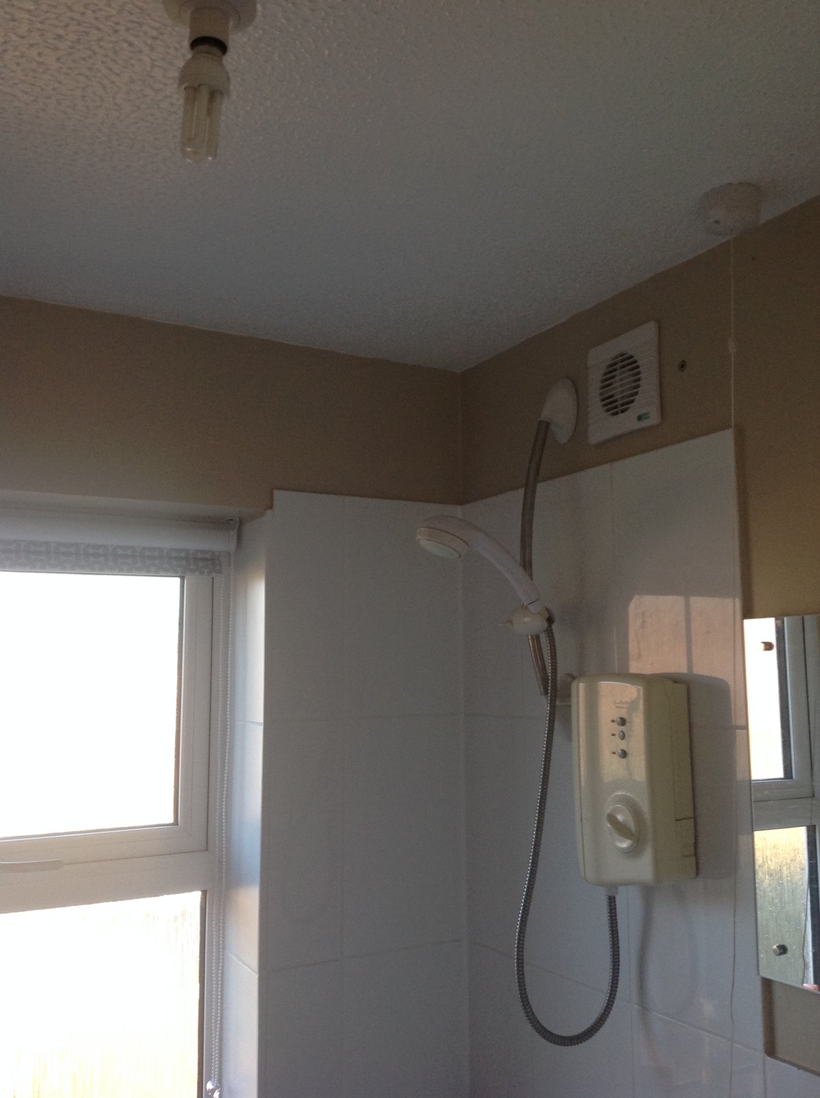

This bathroom light is this within the regs built in 1995 ?I could potentially reach it from the shower although there is a shower curtain . I'm thinking of changing it for a proper bathroom fitting

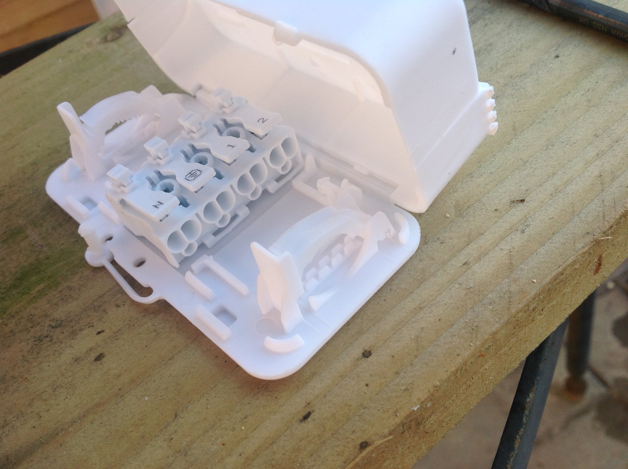

Obviously the existing batten fitting has the 'loop in ' terminals (is that the correct term ?

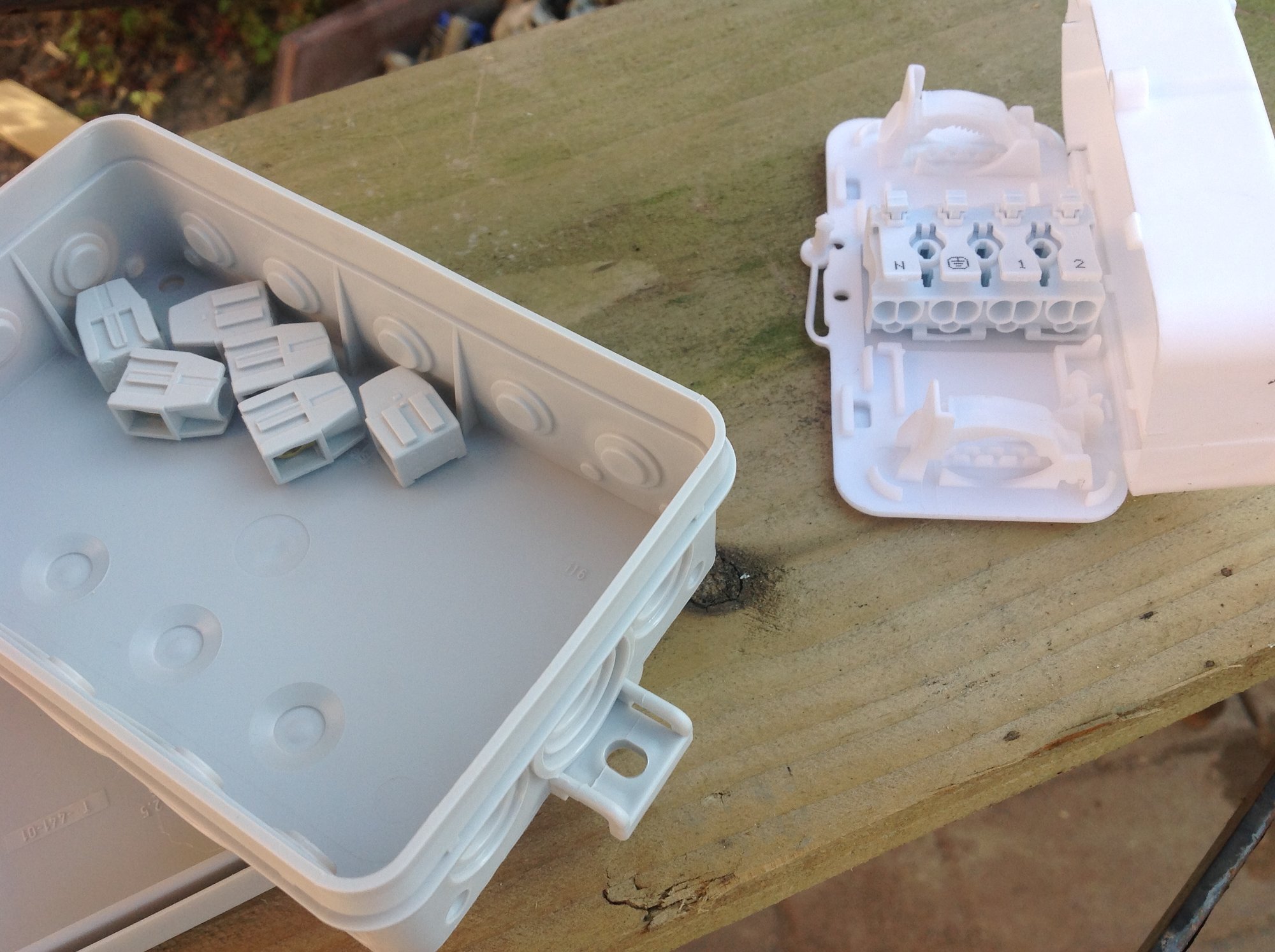

) I can join the cables in the loft can someone recommend a wago type terminal junction box. Or can I just get a pvc enclosure and use the wagos I already have ??The extractor is a low voltage one btw
Second query got a fire rated downlighter what's the closest I can install it next too a 3x2 section of timber ,and plaster board ? Cheers fellas
I did look in to it as I had to replace a few that were above the bath. I thought you could but I asked my mate who is an inspector and he confirmed it
