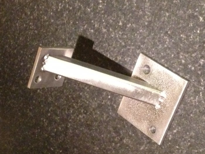

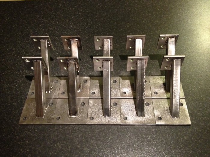

Here's a batch of supercharger support braces I have made for some members of a car forum.
They are all made using a simple little jig I fabbed up to clamp the 2 plates in whilst I tack the diagonal in place.

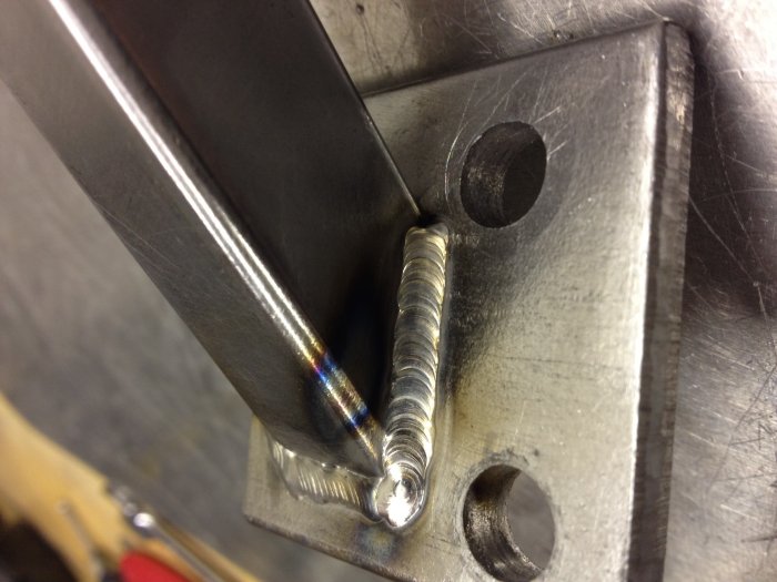

All tacked up now and I have fully welded 2 trying different heat settings, weld sequence's etc to find out what give's the best weld with minimal distortion. I have come to the conclusion that hot and fast is the best way to go in this respect, so will use 125amps on the pedal flat out for the rest of these as that produced nice consistent welds.
The plates are 6mm flat stock, and the diagonal is 25x25x2mm box section.
If anyone has any input as to the the best sequence of welding to use on these (after tacking) I'd love to hear what you have to say. Or any other suggestions you may have. I'm always looking to learn something.
