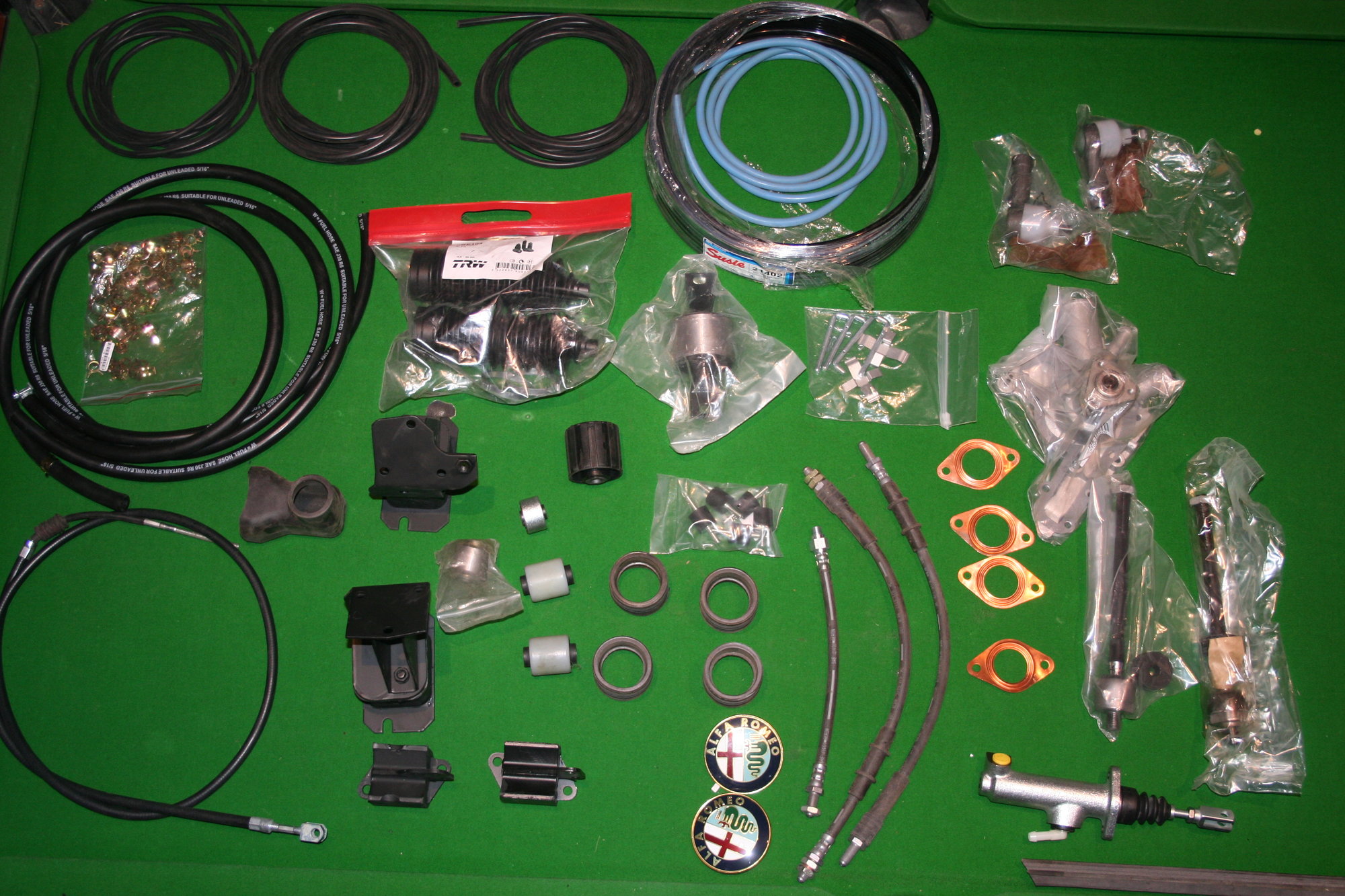

Starting to gather the parts I need to get this back on the road.

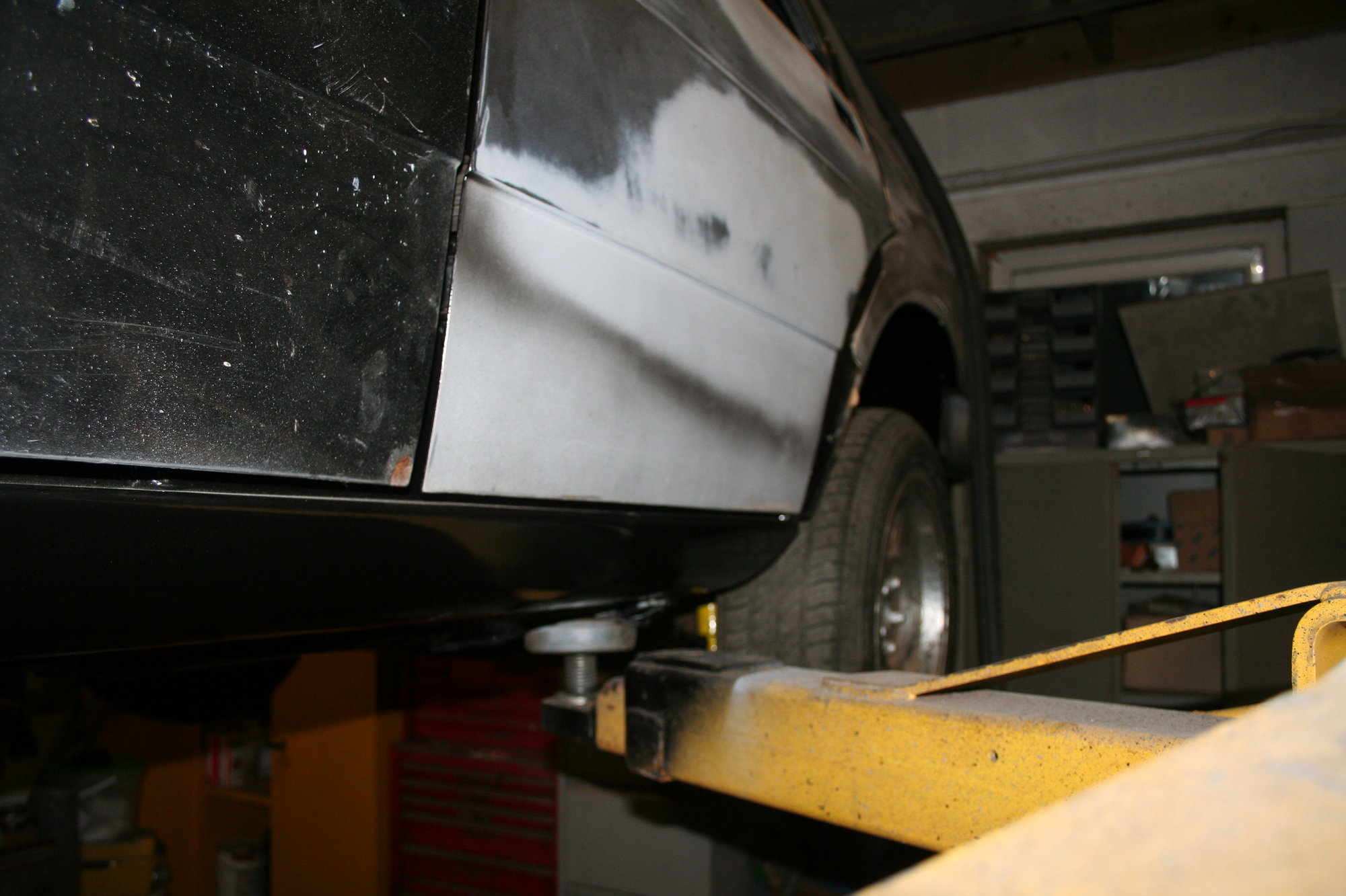

Some minor progress in rebuilding the shell.
Suspension back in so at least I can push it about the place.
Doors back on so I can line everything up and make a start prepping the body work for paint.

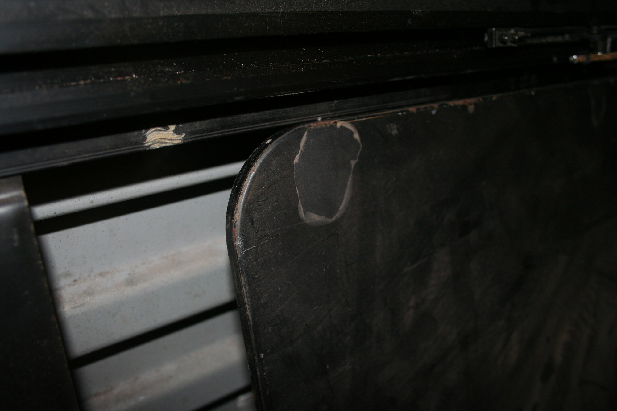

I noticed a few spots where the lacquer was lifting on the horizontal surfaces (bonnet, roof and boot lid)
The bit below is a corner of the sunroof.

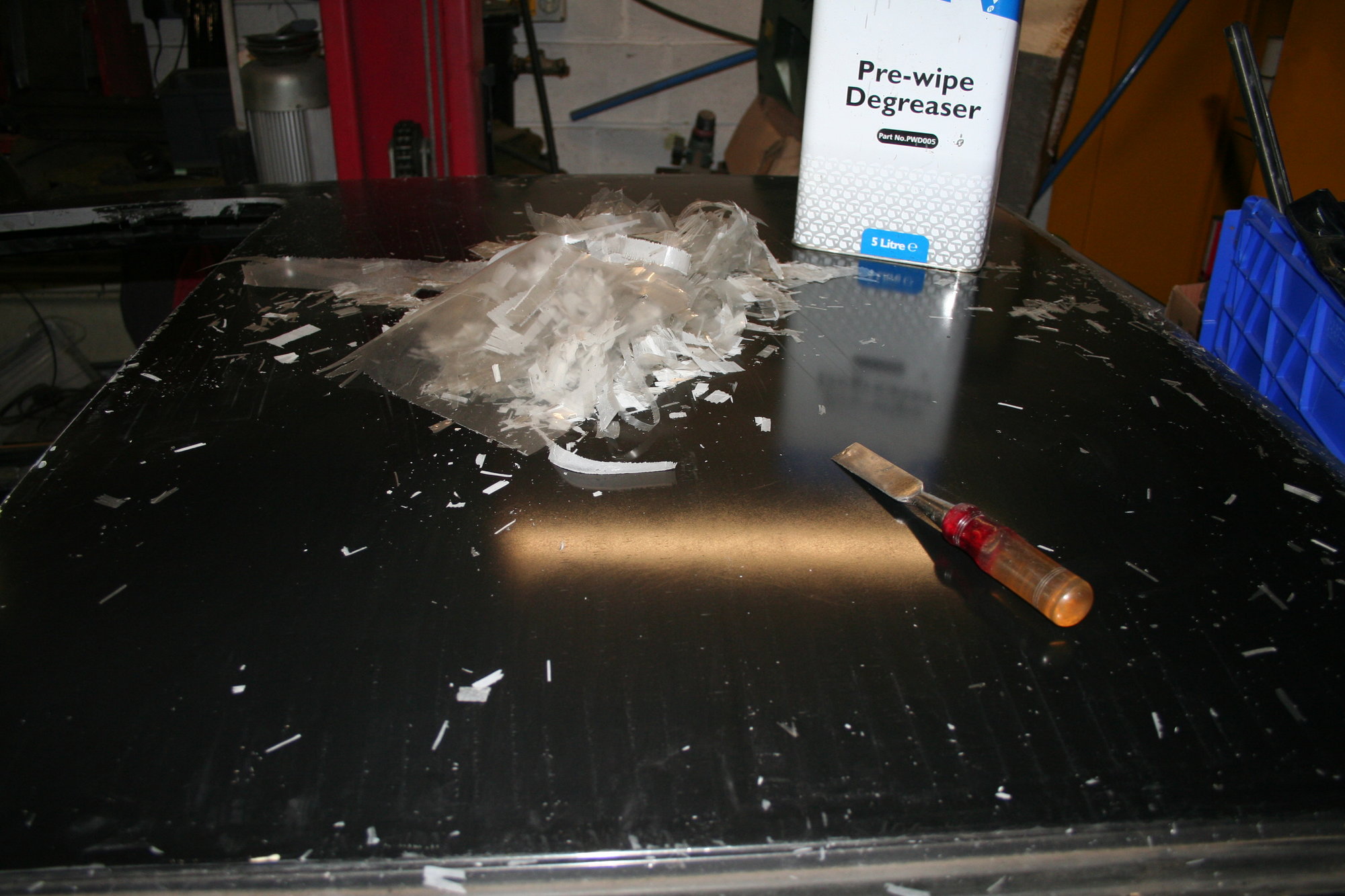

No big deal I thought but I ended up scraping "all" the lacquer off the flat areas, leaving the base coat behind.
I don't intend to take it back to bare metal and I am going to try and seal it with epoxy primer.

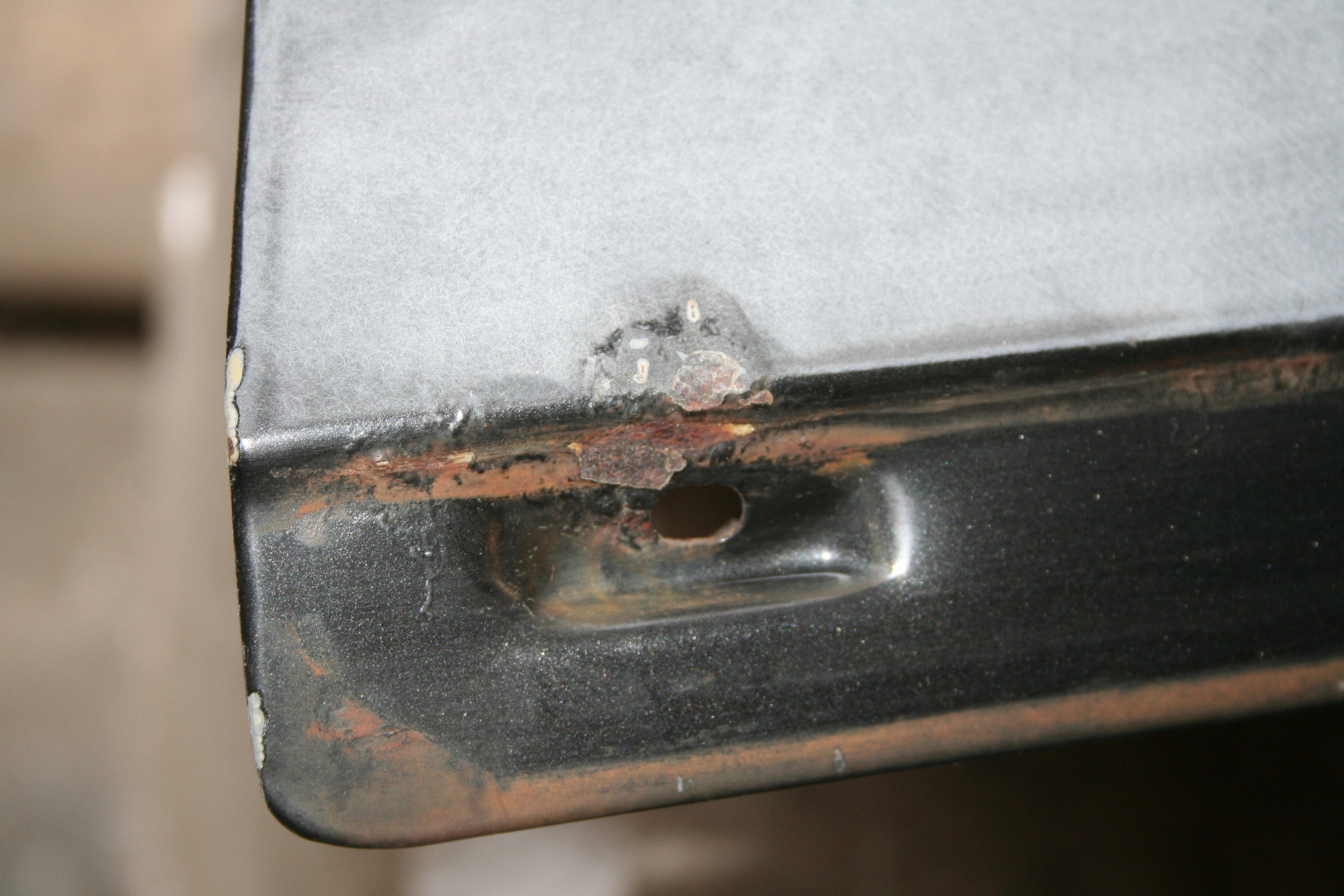

Bits of the car have been repainted.
From what I can tell it was to repair rust spots starting around the front and back screens, sun roof and trim fixings.
I will spot blast any rust before priming.

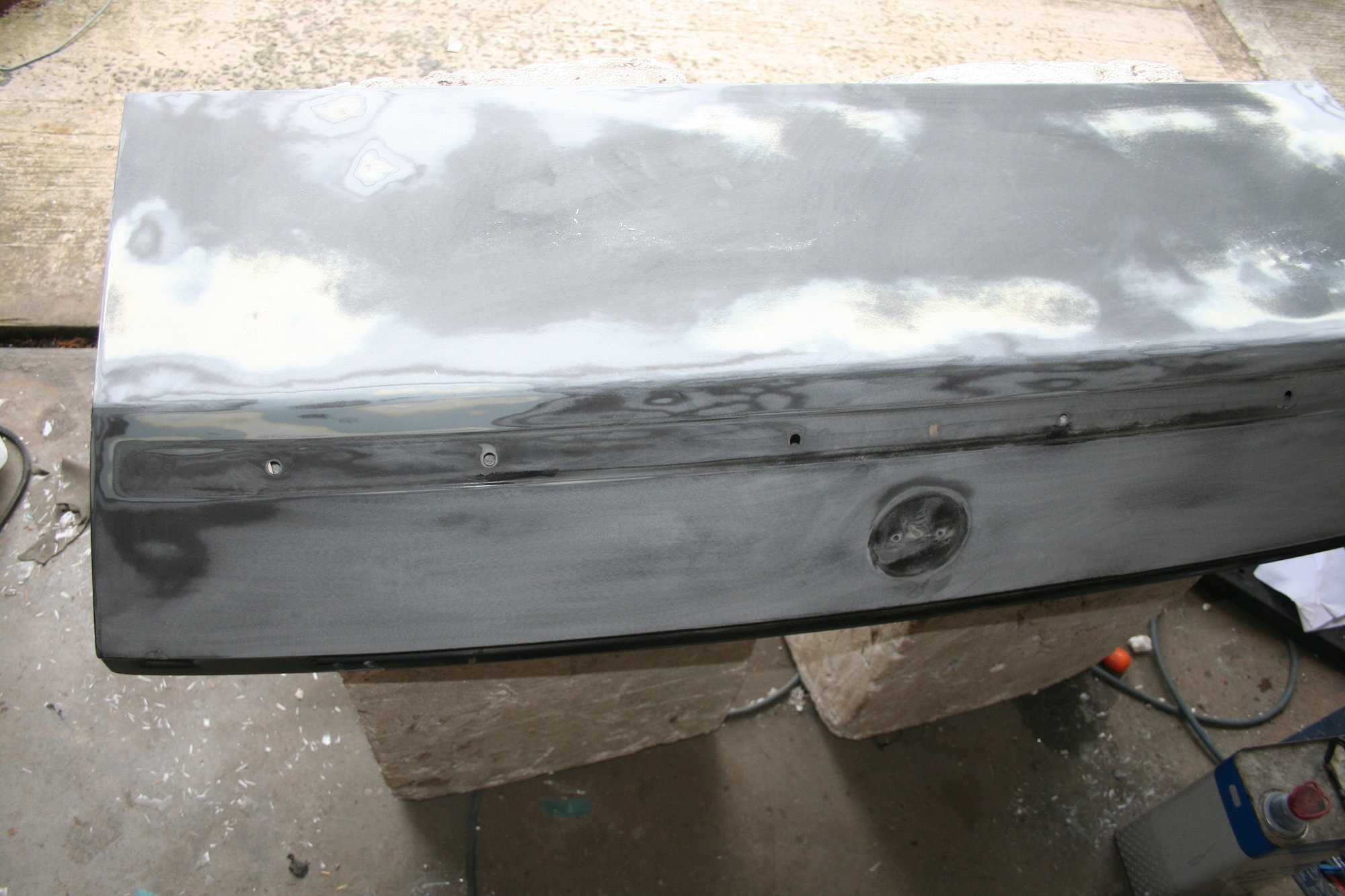

Boot lid wasn't too bad but is a pain to do as there are so many fixing holes that need sorting.
