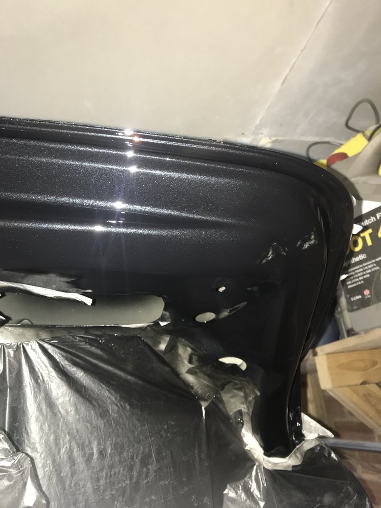

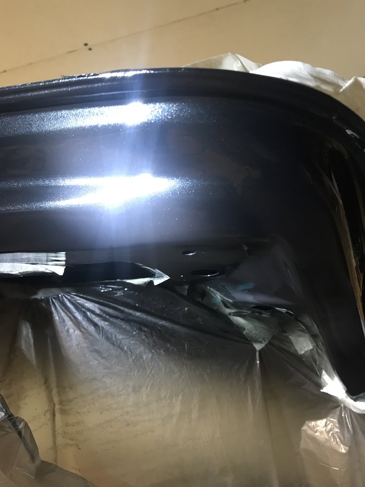

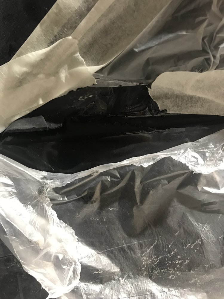

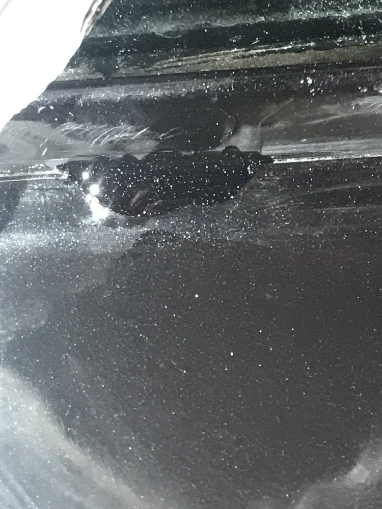

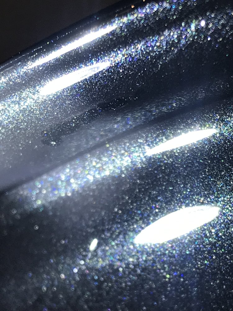

Very little work got done. I’ve now got half the panels done, now my energy levels are back. I’m noticing my basecoat has a blue tint to it when sprayed. When the exact same basecoat is applied by touch up brush/pen it looks a lot darker.

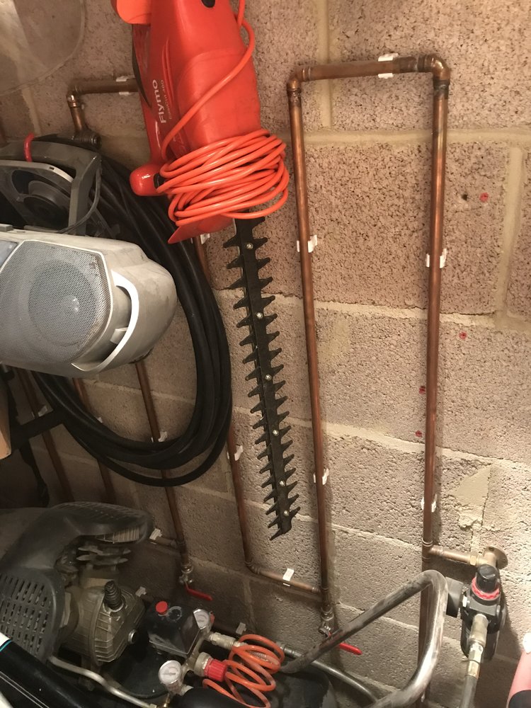

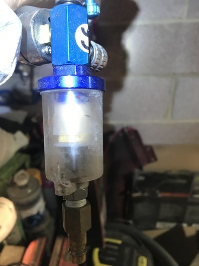

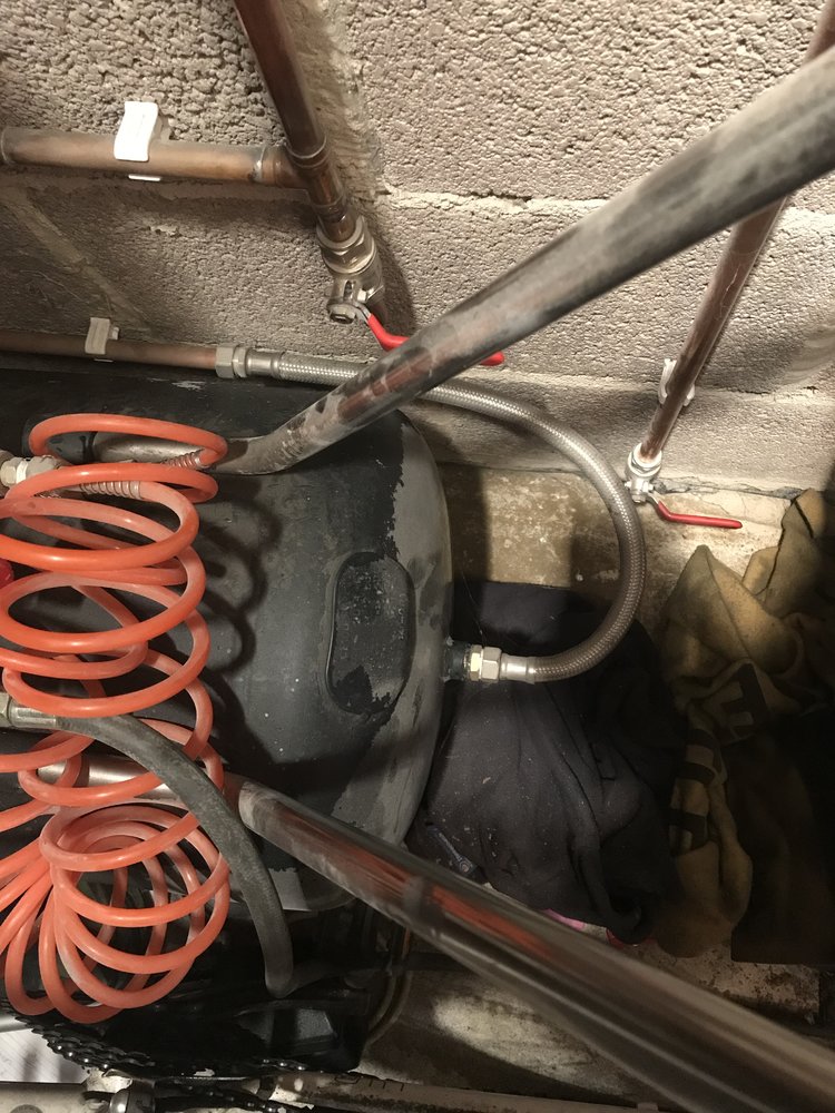

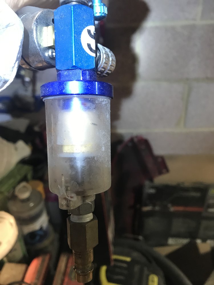

This colour difference is only noticeable under certain led lights. Under normal light conditions there’s no difference. I have a lot of plumbing from my compressor to catch water.
I’m wondering if perhaps oil vapour is passing down the lines and causing it?
