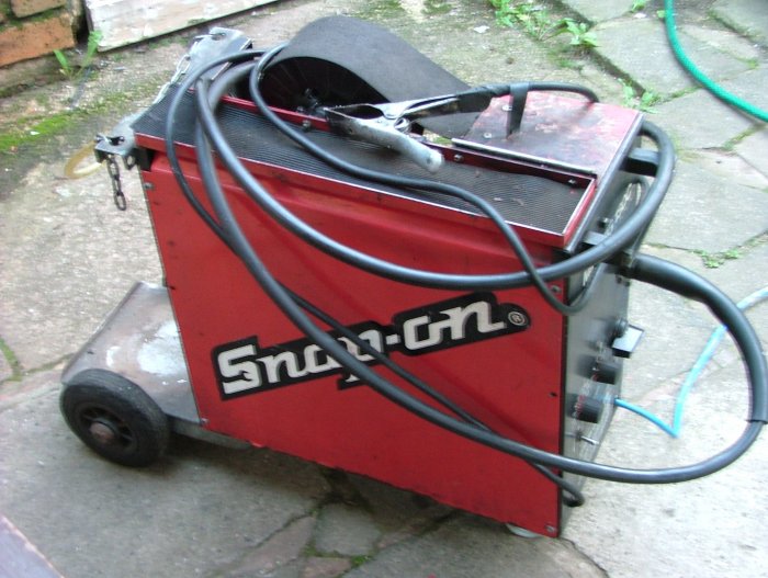

My fleabay purchase spares or repair .
It spent its life in a sports car specialist garage and no doubt as had a full working life.

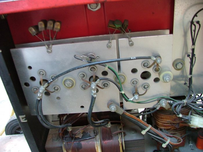

The Transformer shows signs over heating but the static output voltages seem ok .
at 21,23,25,28,32.36, 42 volts

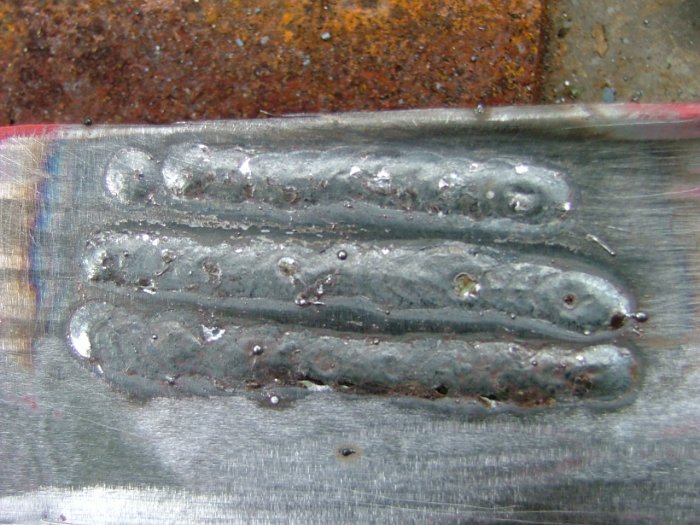

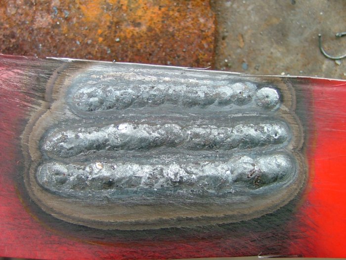

It welds ok 0.8 wire on v3.
The spot stitch switch as been bypast .
Could do with a loading box to monitor it properly,
I would also like to put an ammeter on it useing part of the internal welding wire as a shunt and measure the volt drop across the resistance of the shunt?
Waiting for my volkszone deal form then away we go, hopefully not with a bang and a puff of smoke.
