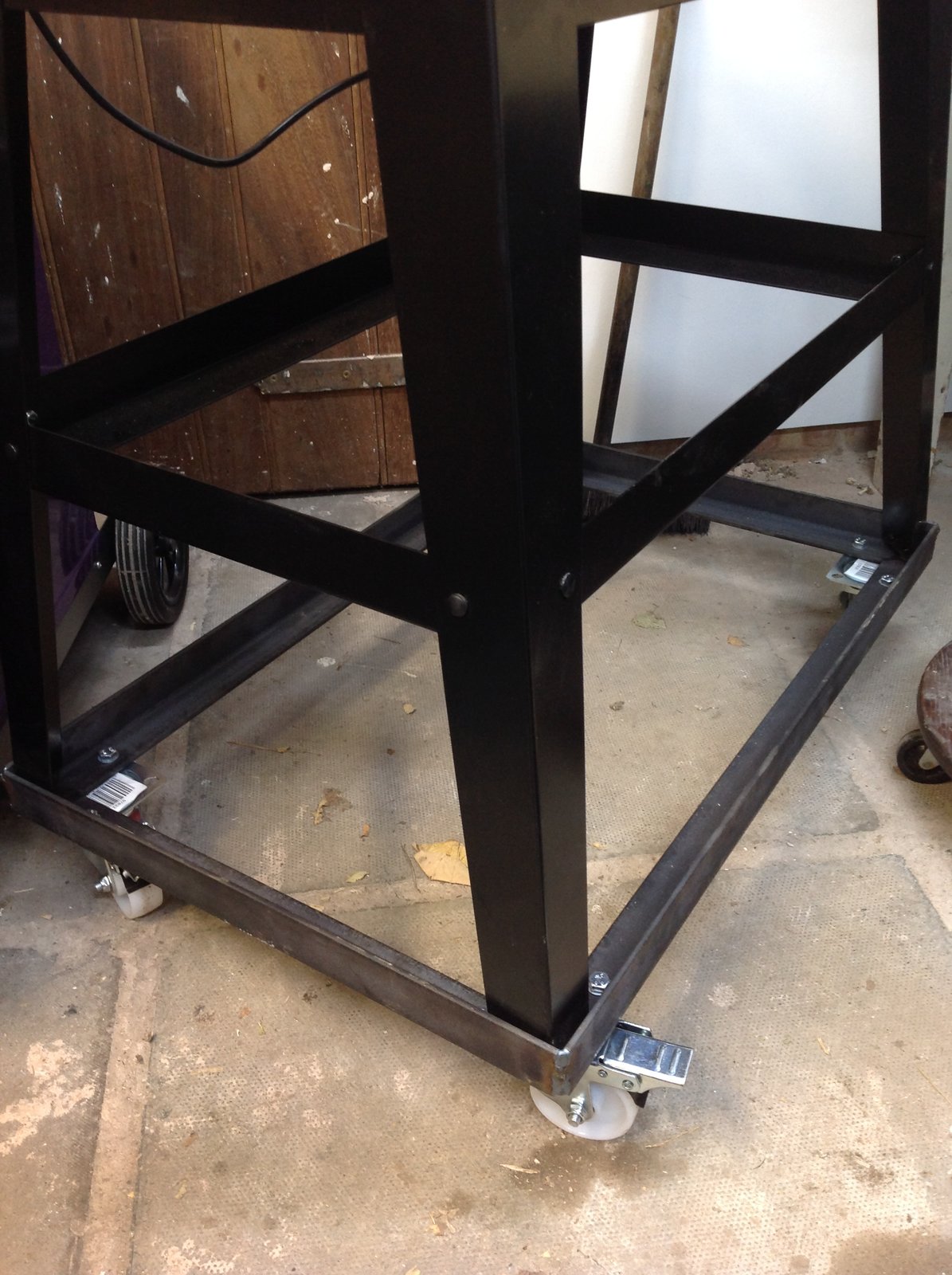

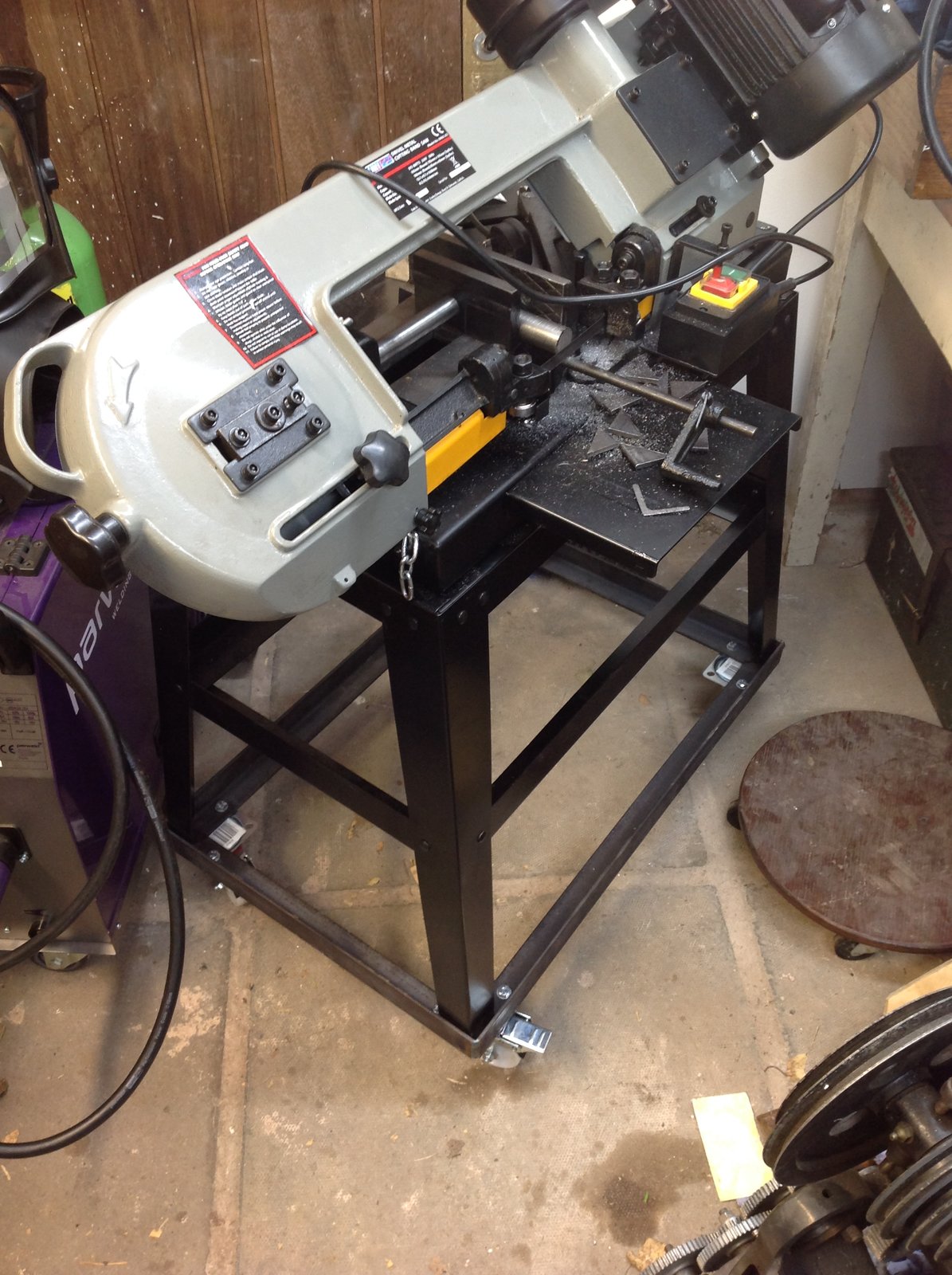

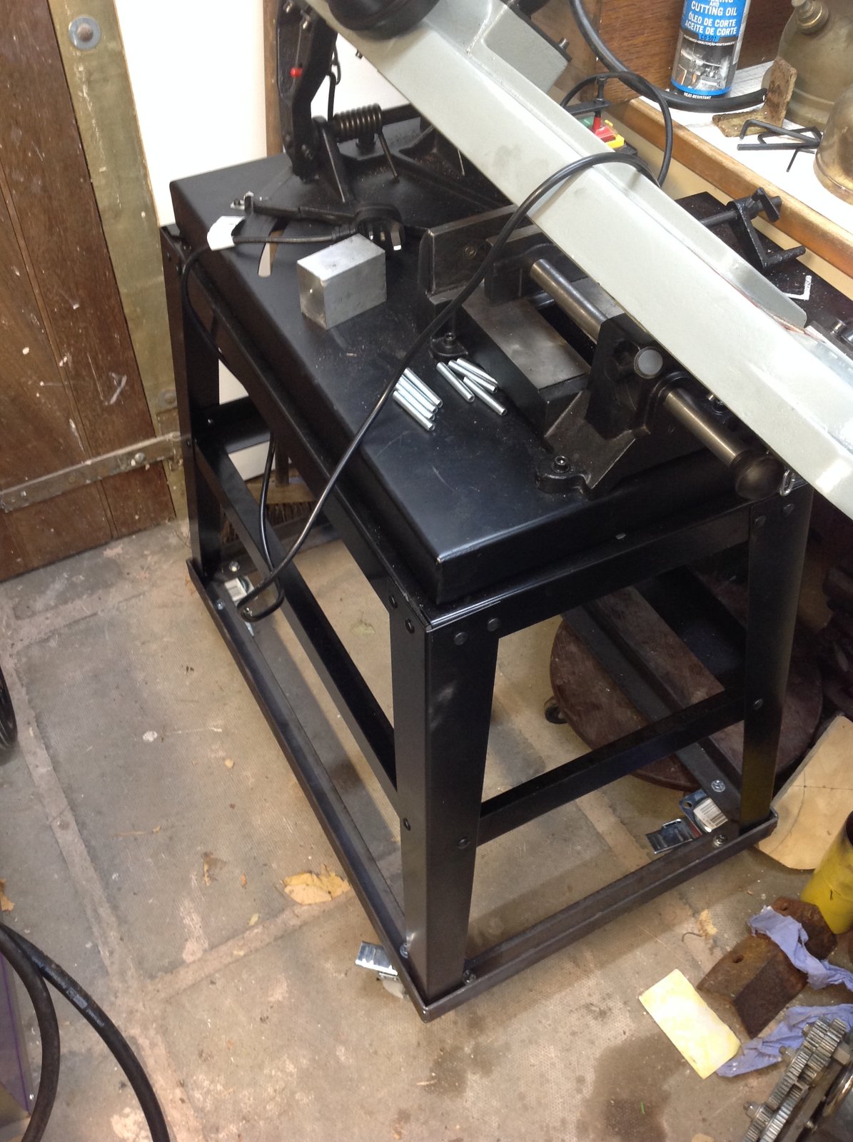

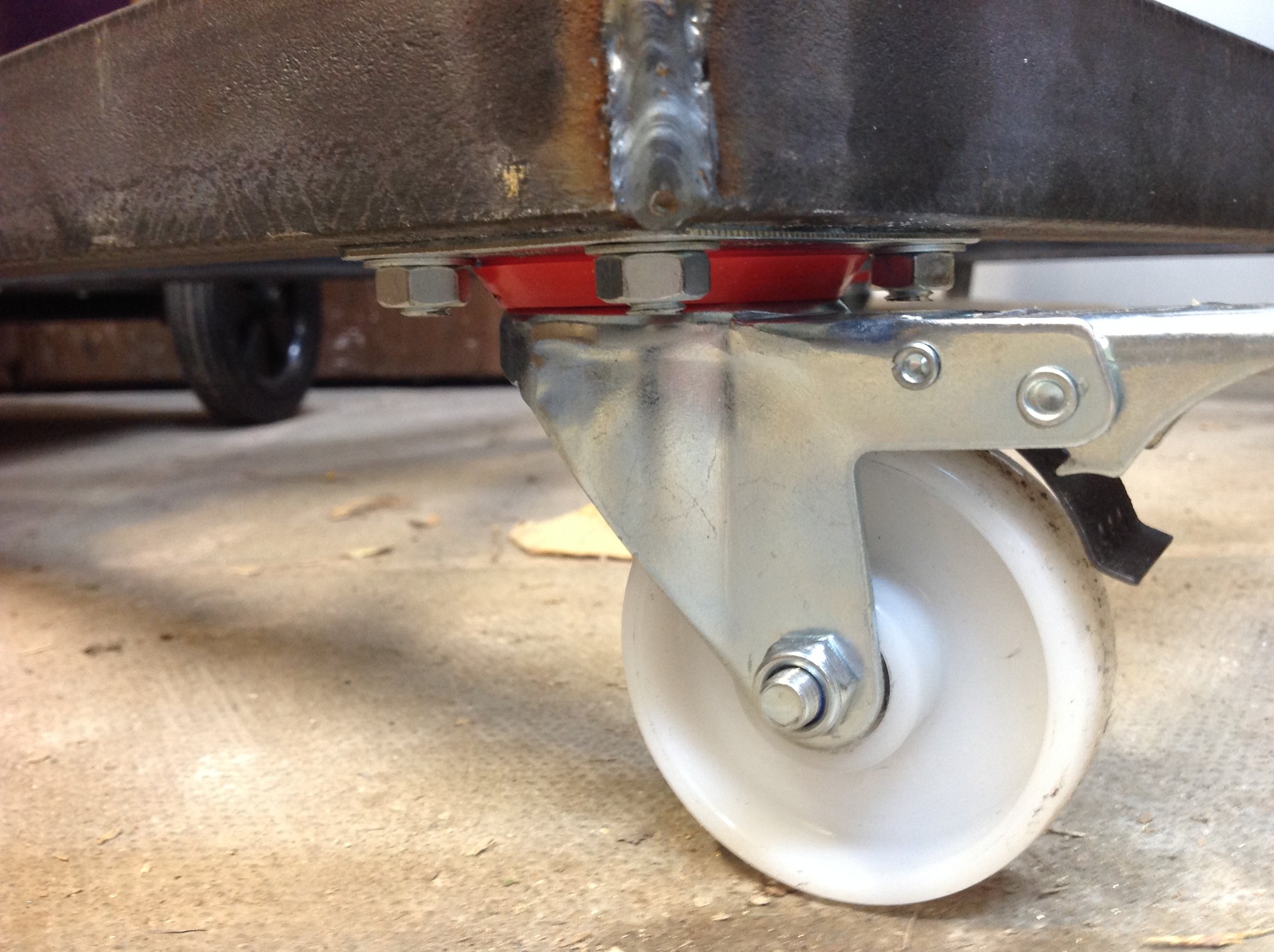

Built this up over the last couple of days. For some reason I decided to buy one of these band saws without wheels, right pita when it needs moving to cut something long and no ones around to help lift it. All four castors swivel with brakes, it locks up really solid with brakes on and moves lovely around the shed into position, or outside for really long lengths. Frame is made up using 40x40mm by 5mm angle, castors are the 75mm ones from toolstation.
