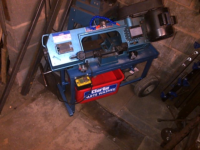

N naughtyboy Guest Sep 9, 2013 #1 started this while ago and eldest finished it whilst i was out of action by fitting switch and painting it. its made from 30x30 box with tray out of 16g, drain is plug unit from a bath. uses a parts washer as coolant pump. phone pics 002.jpg 73.1 KB · Views: 290
