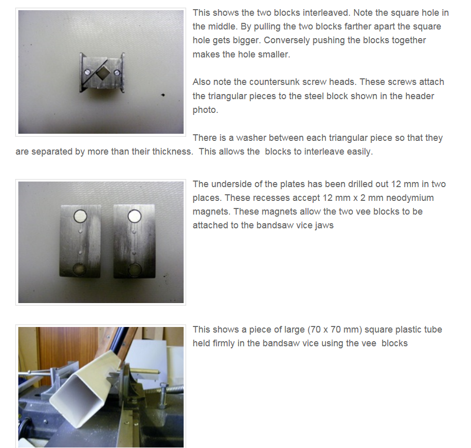

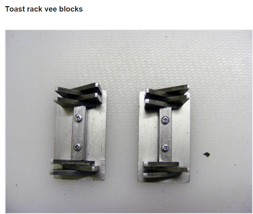

http://mikesworkshop.weebly.com/toast-rack-vee-blocks.html
Very simple idea but I think a great accessory so in the process of making a set for my bandsaw.
