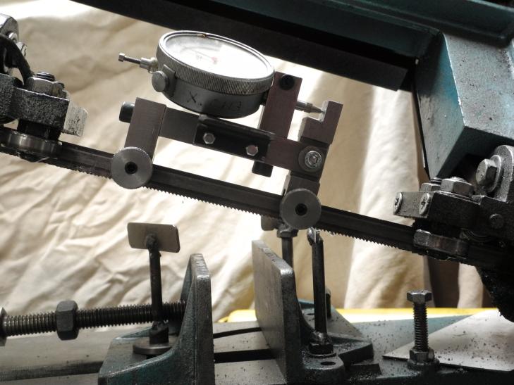

The stress in the blade can be easily determined by measuring the elongation of
the blade over a known distance as it is tightened. This can be done with a
simply made gauge. A pic of one I made in 2016 installed on my 6x4 bandsaw:
My thanks go to Jaques Maurel for the gauge design in an article in
Engineering in Minature (June 2016). Basically a simple frame clamped to the
blade. The lever arm at the right hand end is pivoted in the horizontal member
thus driving the dti plunger as the blade elongates. The frame is clamped to
the blade with pointed grub screws either side of the blade. Dimensions are
not critical. A search of the web will even turn up a similar device made from
wood.
When the blade bends around the blade wheels, the stress increases somewhat in
that area. Therefore I would suggest sticking to about 18,000psi on the small
hobby type bandsaws.
Now for some maths to find the elongation for your chosen stress level:
Tension strain = elongation / distance between gauge clamping screws
Hooke's law: tension stress = Modulus of elasticity x tension strain
The modulus of elasticity for steel is about 29,000,000 psi at room
temperature. It varies insignificantly, for our purposes, with different steel
alloys.
Thus elongation = (tension strain x distance between clamping screws)
For my gauge the distance between clamping screws is 3.150"
so: elongation = (18000 x 3.150)/29000000 = 0.001955"
For convenience, round up to 0.002"
This equates to 1.3/4 turns of the tension handwheel, on my saw, with it's
16tpi tensioning screw. I normally don't bother with the gauge and just use the
1.3/4 turns. But I do use the gauge after fitting a new blade
For my gauge I use a 0.0001" div dti to get a reasonable needle movement.
