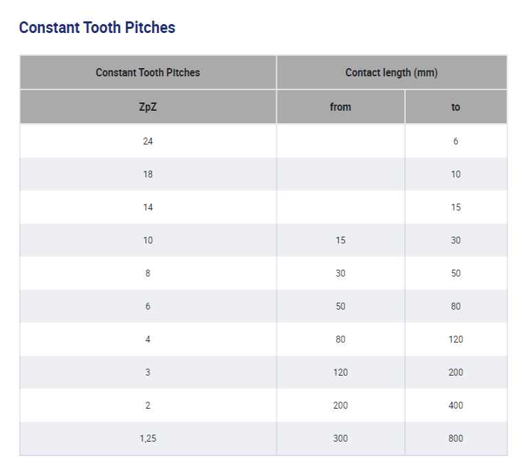

I was going to get a 14TPI but according to the link I am cutting much thicker stuff 2 1/2" etc so 8TPI would be better suited according to that table.. Read a bit about the tooth shapes and sets that I didn't know..

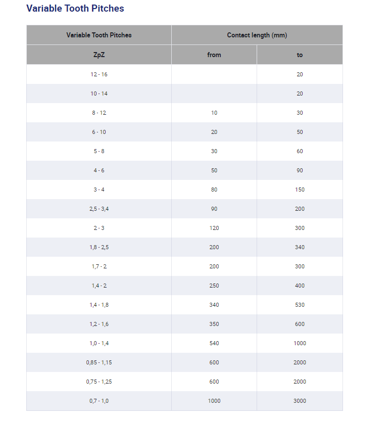

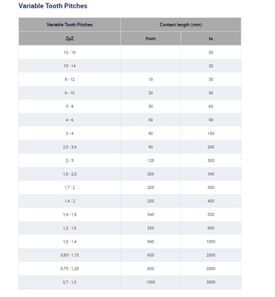

But I've come across some variable types e.g. 8-12TPI, but viewing the table there does not seem to be much benefit in thickness cut range with a variable unless you are going really small (constant) or massive (variable)
https://www.wikus.de/en/guidebook/technical-principles/blade-selection
