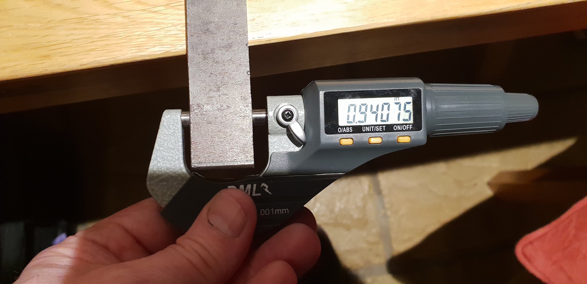

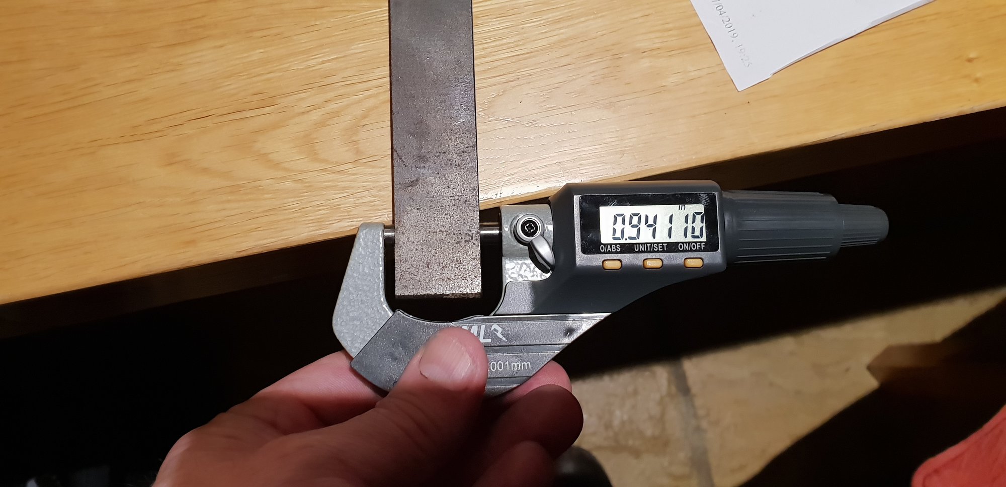

Yes it is a new blade. But the accuracy is better than many mills and lathes!wait till the blade dull's down a bit......I alow anything cut on the vert/bandsaw to be remachined for accuracy.....
horizontals seem to fare better tho......
I am still astonished by it![]()
Yes solid guides.You really can't make that comparison because of the finish. Proper saws set up properly will cut very accurately, again the finish is not to be compared. I think from pics i recall seeing, your startrite has solid guides and not roller? Solid guides are far superior to roller guides in accuracy terms.
