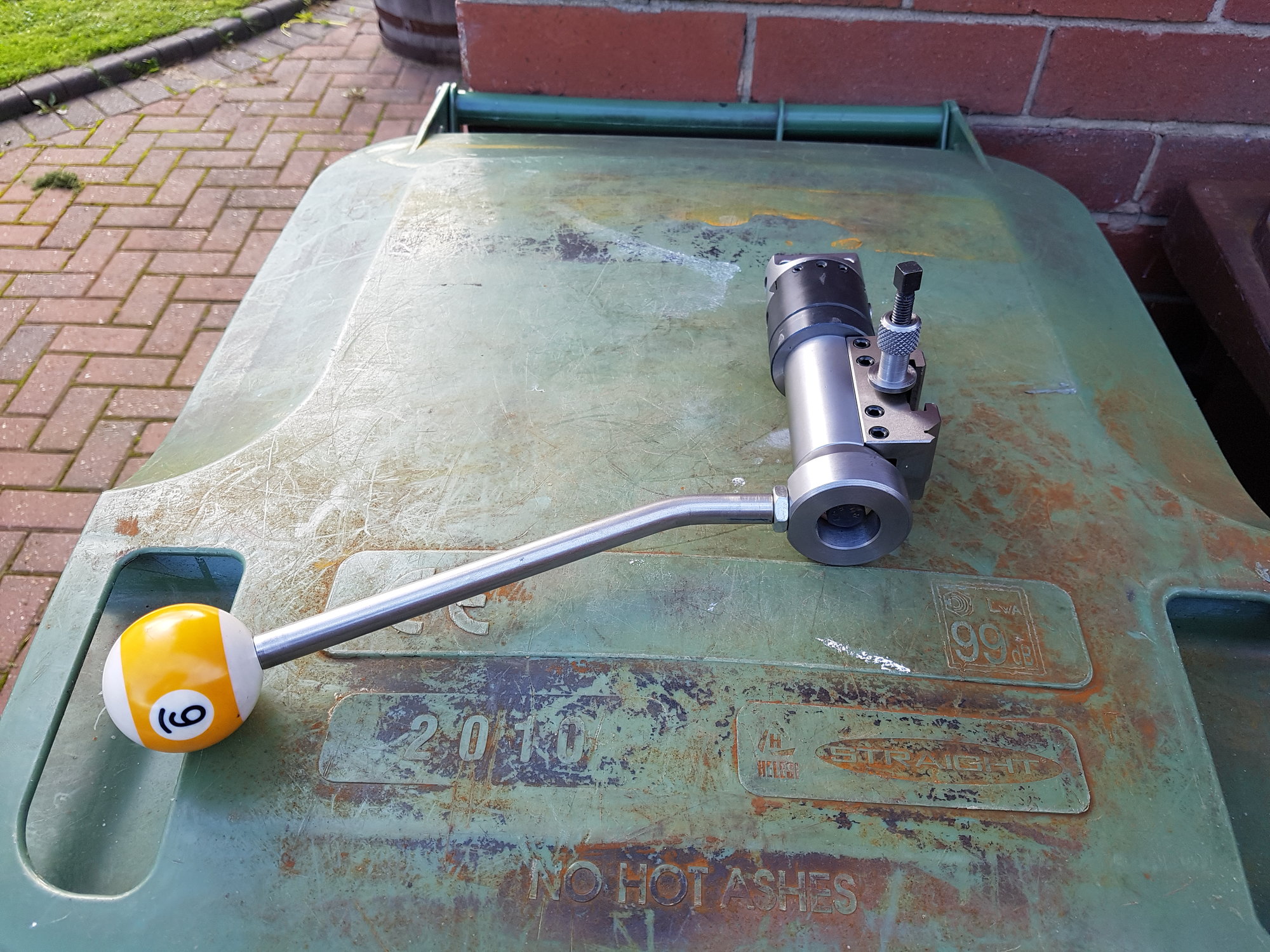

atconut Member Messages 521 Jan 5, 2018 #1 I've been watching a few vids on people making ball turners so i fancied making one for myself. I can't take any credit for the design i have more or less copied other ones i have seen. it works very vell

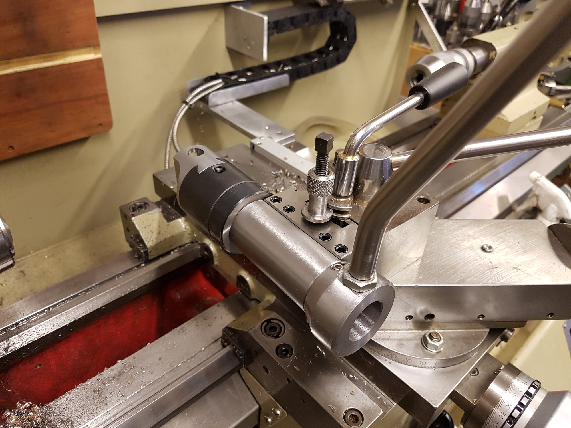

atconut Member Messages 521 Jan 5, 2018 #2 Here's one on the lathe. i could post some pics of the tool holder if anyones interested
Richard. Member Messages 18,344 Location Cambridgeshire Jan 5, 2018 #3 Yeah post the pics. I’d be interested in more of it.
brightspark Member Messages 41,234 Location yarm stockton on tees Jan 5, 2018 #4 is that the one u have made on the wheely bin
eSCHEn Bit Wrangler Staff member Messages 6,199 Location SW Scotland Jan 5, 2018 #5 I'd be interested to see/hear how you got on with the tapping of the ball (assuming you did). Am doing the same soon more than likely.

atconut Member Messages 521 Jan 5, 2018 #6 Yes the one on the weely bin is the same one on the lathe, no I didn't make the pool ball
atconut Member Messages 521 Jan 5, 2018 #7 You tap it first then turn it into a ball, I'll take some pics to exxplain better and I'll show the tool holder

atconut Member Messages 521 Jan 5, 2018 #8 There are some vids on you tube of them in action, I think john doubleboost ha made one
