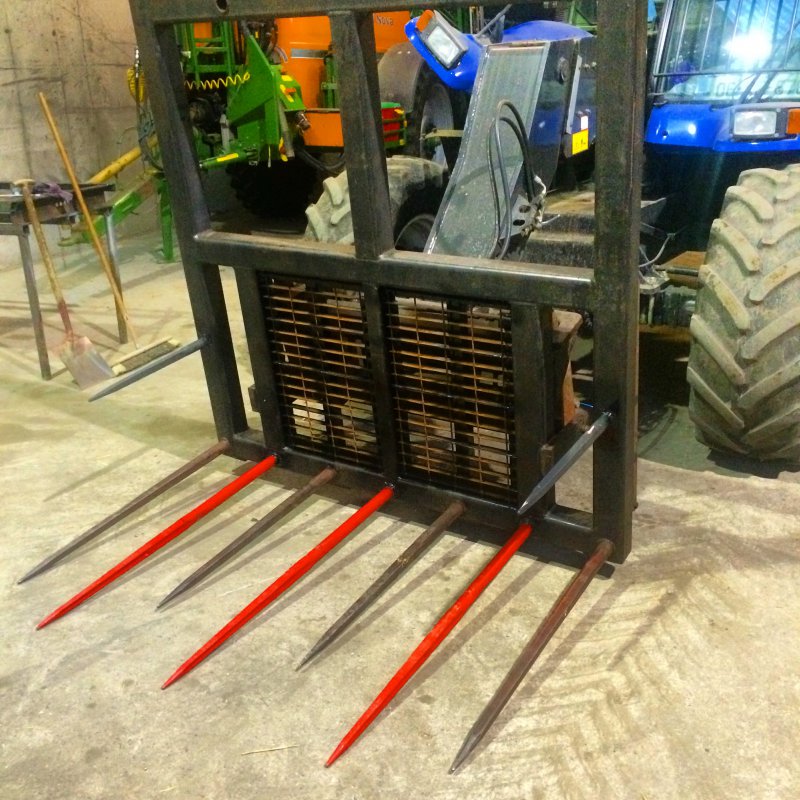

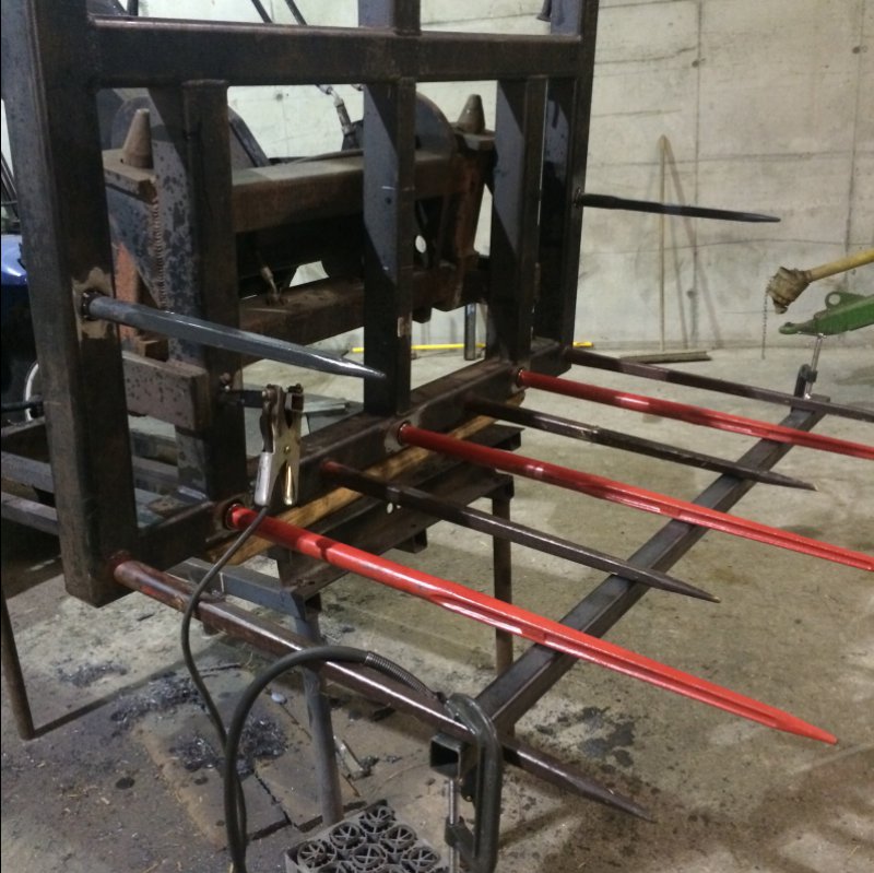

job I did a few weeks back. I had to make a bale spike into a dual purpose one bale spike / dung fork

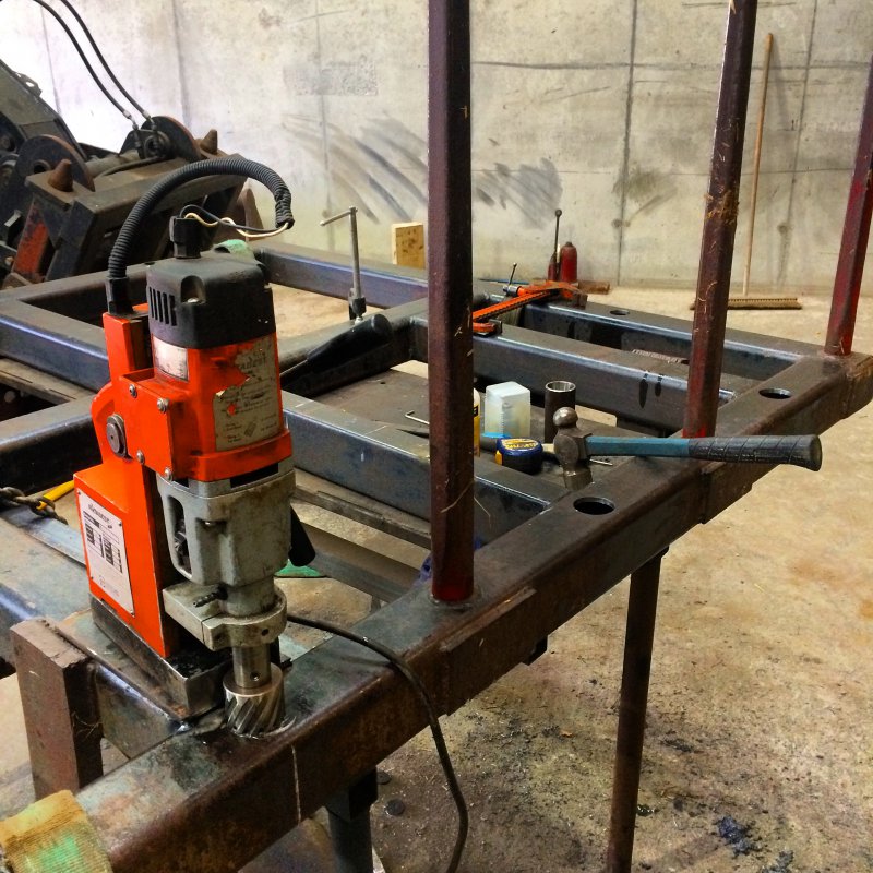

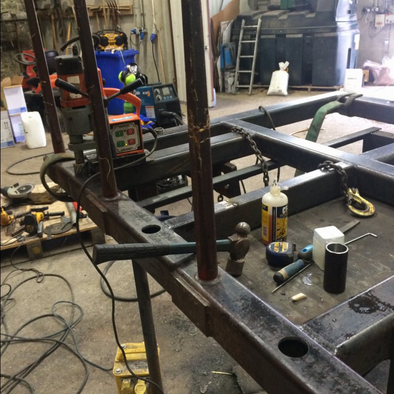

I Mag drilled out the holes with a 52mm bit instead of using gas axe as I would require little or no clean up for welding
