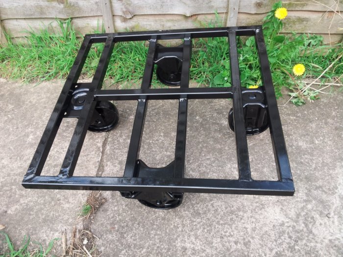

My latest creation to save my back and legs on an upcoming job
Its a 2ft x 2ft balance trolley to move a fish tank and cabinet on their ends down a narrow corridor and round a corner for a customer
The trolley spins on its axis and has a steering castor on the front.
used 6" nylon castors and 25mm x 25mm steel tube
It will have a changeable board and rubber mat to go on the top
