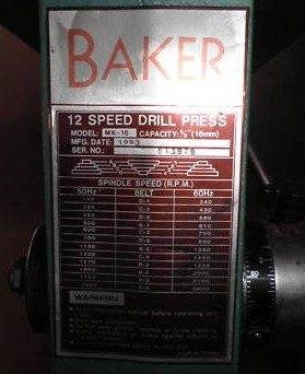

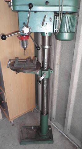

well its got enough speeds is it single phase ?and how much can u get it forAnyone heard of them?, just wondering if they are any good.![]()
thats the governing factorwell its got enough speeds is it single phase ?and how much can u get it forthats the governing factor
It looks fairly low-end to mid-range from the pic, IMHO. But would probably be fine for most general use. The state of the bearings will make all the difference - if you can find out, but in short, no, its not amazing, 'probably ok'.
The throat depth doesn't look enormous, which could get annoying. It has double pulleys, which is a benefit, but not as good as 2 pulleys and a gear selector. The lower the speed and the bigger the hole, the more likely you are to get belt slippage. The main column looks fairly small diameter - which isn't great, but at least it has a support at the base. The rack-driven rise/fall & pivot table is useful.
The main question is - what are you going to use it for. If its just 'general farting about in the garage' then its plenty.
