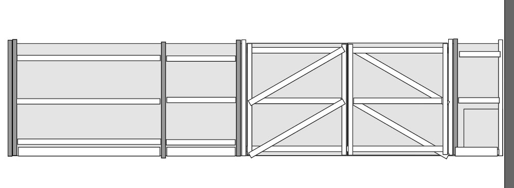

Planning a quick fence with vehicle access gate. Something I can put up in a couple of days. Thinking 8 foot 4 inch concrete mortice posts sunk about 20 inches into the ground, 6 foot close boarded fence, and a pair of close boarded doors with 4 x 2 frame.
Problem is I want the door opening to be over 3m so I can get skip trucks and grabbers past them, so each door is going to be maybe 1.6m. Do you reckon 4 x 2 will be up to the job? Guess I'll need 3 horizontal to mount the boarding,and 2 vertical. Also do the posts sound up to the job?
