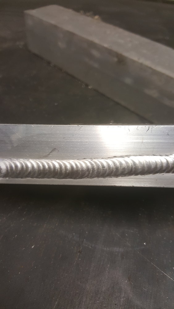

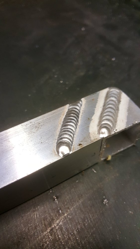

C Cheesie Member Messages 1,259 Location Lisburn Aug 2, 2021 #1 weld on right is an old weld you can clearly see the etching I put a new one beside to show even at 40% ep no etching then another I tried with larger cup#7 on 3mm wall box, still crap

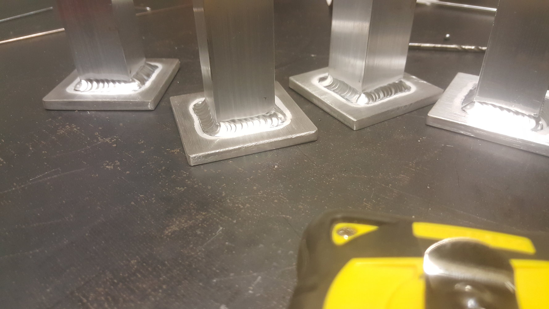

C Cheesie Member Messages 1,259 Location Lisburn Aug 3, 2021 #3 the weld itself is dirty I done these on Thursday with the old bottle, I like them to shine
