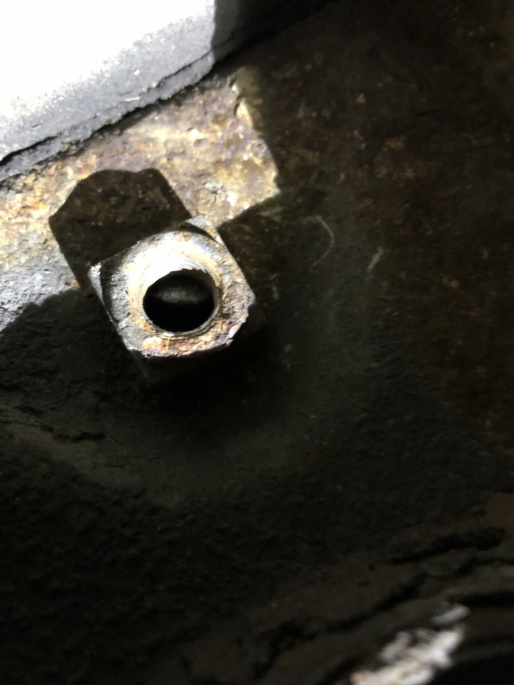

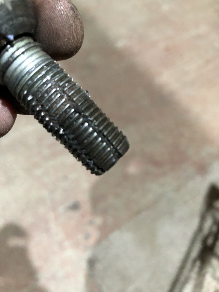

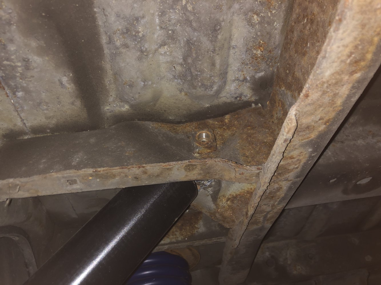

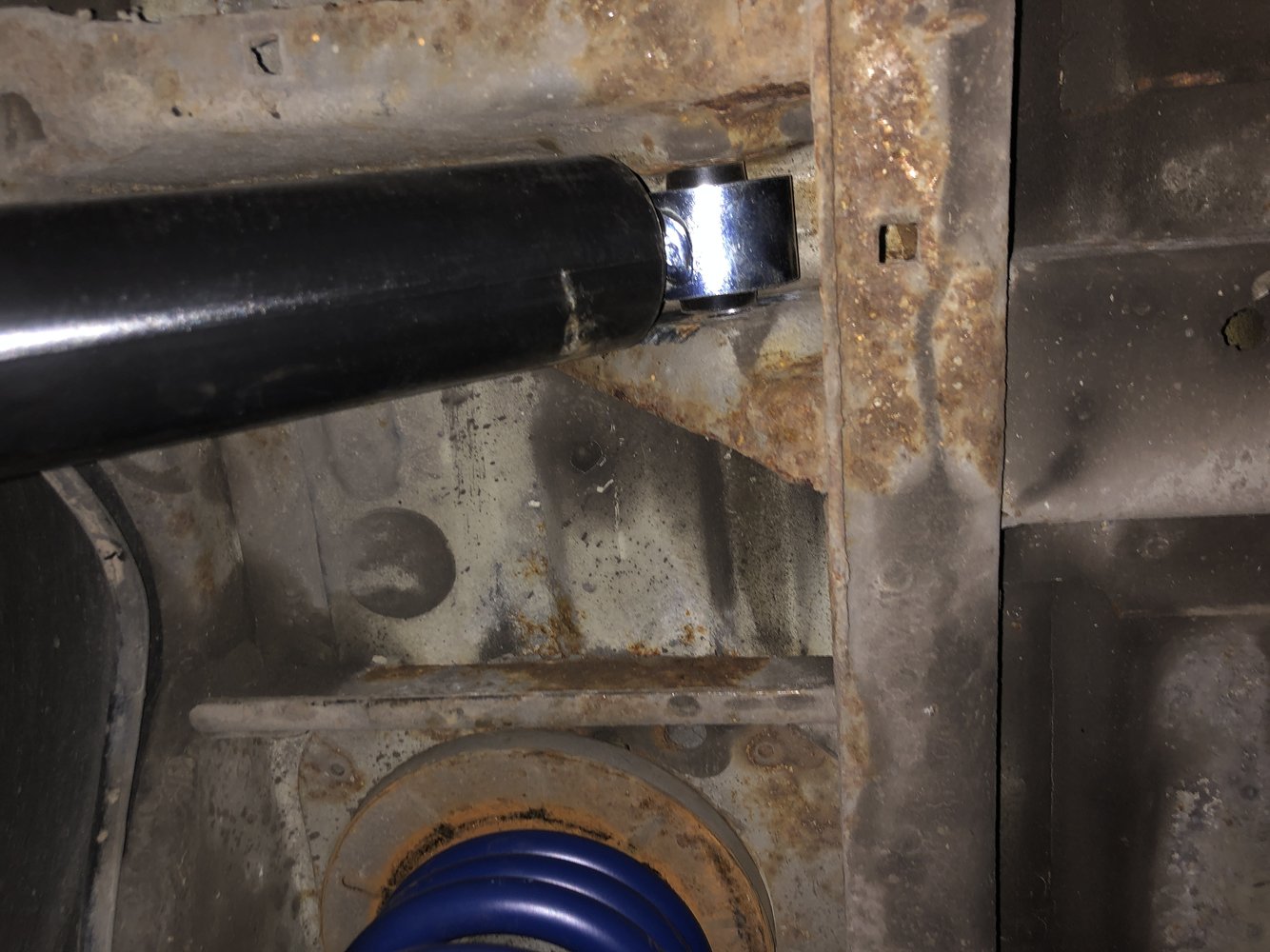

On the way home from my mothers birthday meal hear a knocking from vans rear suspension. Check and find that one of the brand new dampers installed by garage is no longer connected at the top. Drive carefully down to work, jack the van up, tap cut the mangled captive nut and put a new bolt and nyloc in place. Replace the rear wheel and cross thread one of the wheel nuts. No tap that fits. Steal some wheel nuts from a neighbours van (sorry Rick) and grind one as a tap to clean the threads up in the hub.
Finish up at 10:30. Now I can use my van for all the weekends planned activities.
