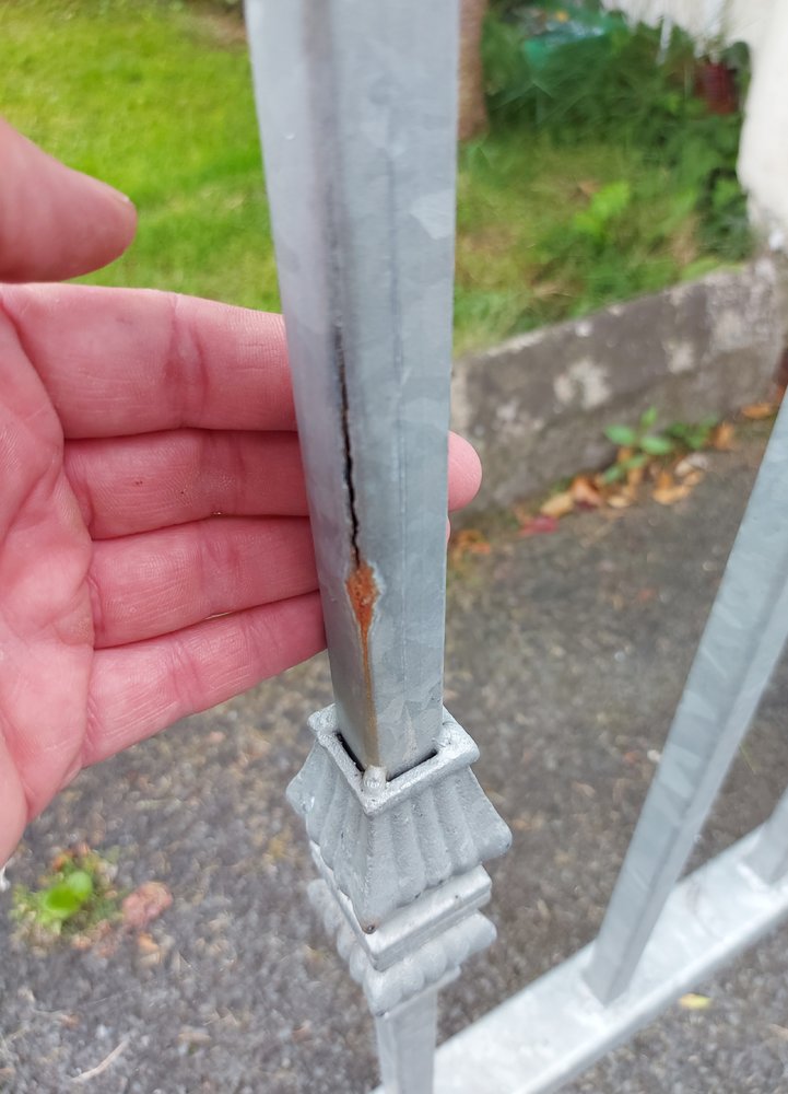

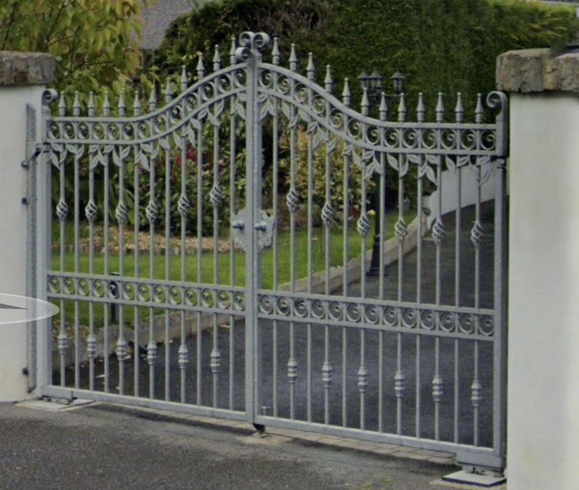

I made my own gates about 5 years ago. Hollow section on the gates for weight as they are large and they were hot dip galvanised.

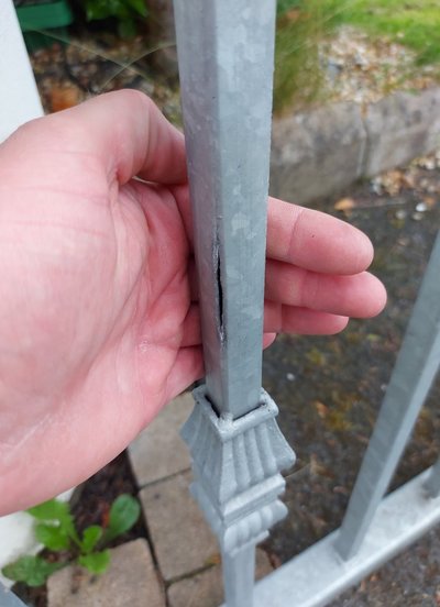

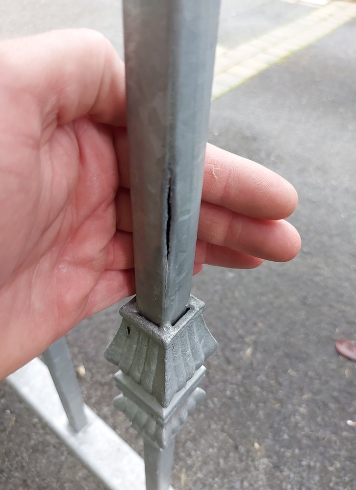

I just noticed today there are splits in 3 or 4 of the lower section of vertical bars:
This has surprised me a little, the box sections are also locally bulging a bit.

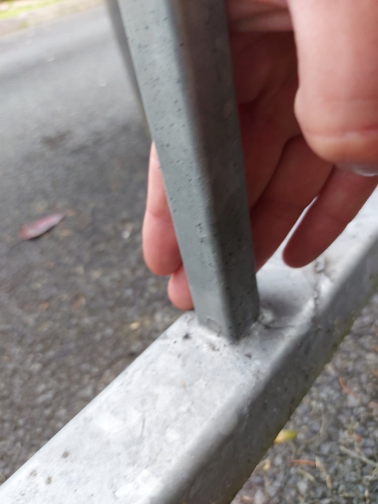

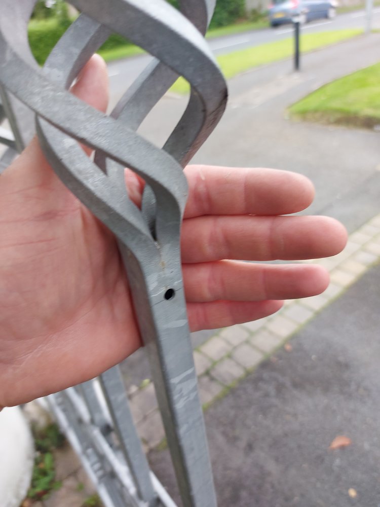

Looking closer I see that these box sections have a galv drain hole at the top and bottom. And the bottom holes are blocked by the galv.
The most likely cause I can think of is water filling up inside these SHS's and frost having caused the split damage.
Anyone any better ideas on this EGS case? I will need to open up these lower drain holes on all affected bars then and probably will have to weld up and galvafroid the splits.
