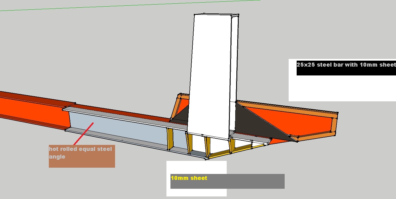

Hi i have a old russian backhoe dozer Jumz eo2621 i want to put Front loader to it.
I have complete front loader from this backhoe its polish "ostrowek k162"
The main frame (lower part) of jumz is steel chanel 180x70 welded in to rectangle and 9mm sheet metal on the front (upper part)
I want to weld another 180 steel chanel on frame and put sheet metal 10mm reinfocments under loader column, and weld square bar 25x25mm with 10mm thick plate on uppper frame.
How do you think it will be ok? the loader capacity is 1500kg
