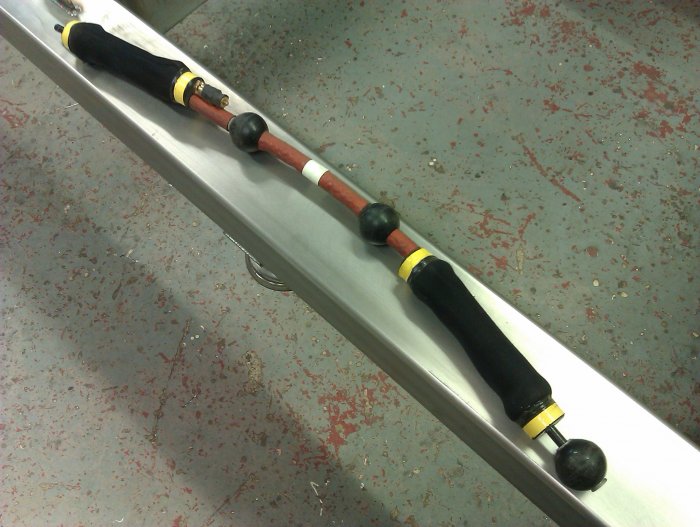

For a small job a ball of cooking foil shoved up the pipe with a hole through for the gas feed works well, I have a posh self inflating setup for dairy pipe.
A video of how it works here http://www.youtube.com/watch?v=Zky7IwWuXiw&feature=related, perhaps a bit expensive for most Diy'ers but nice to use
