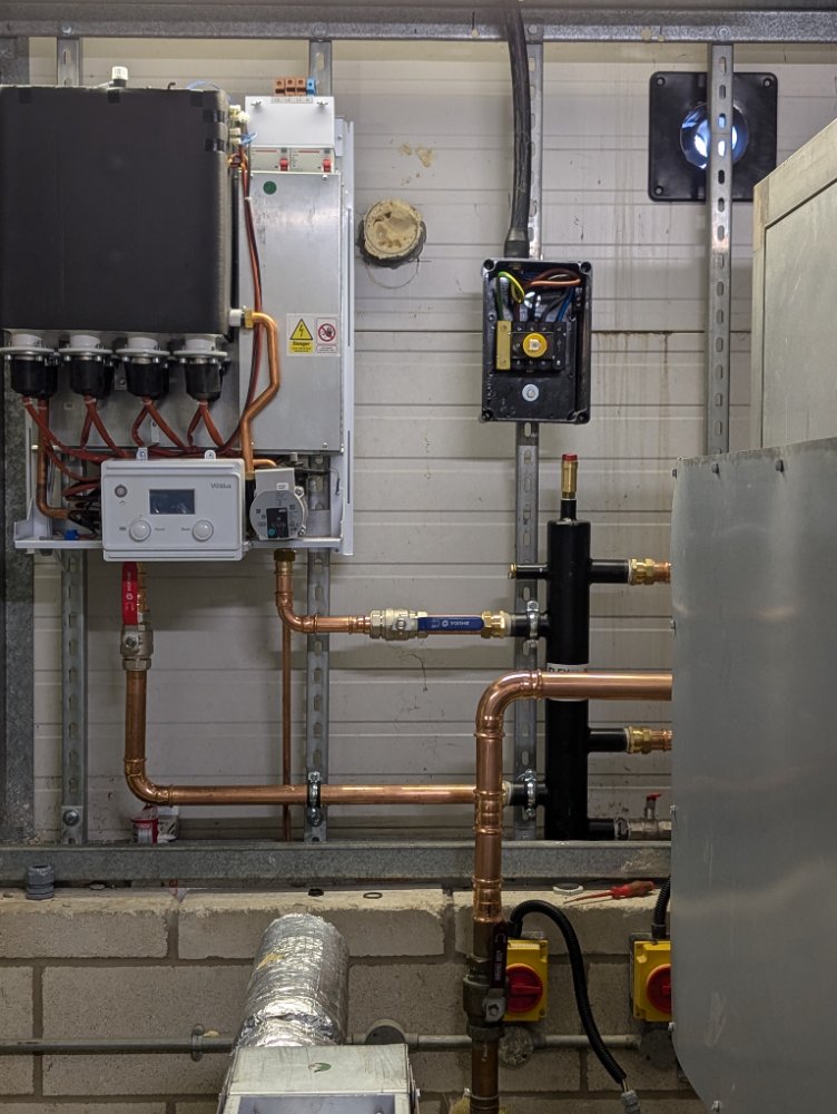

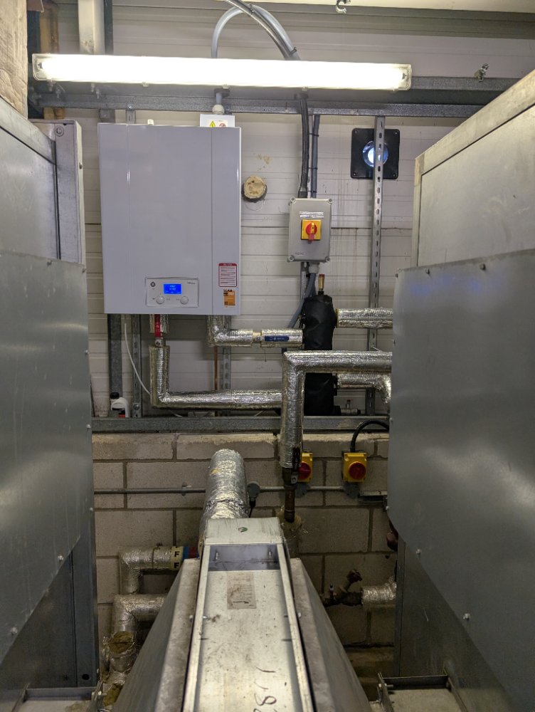

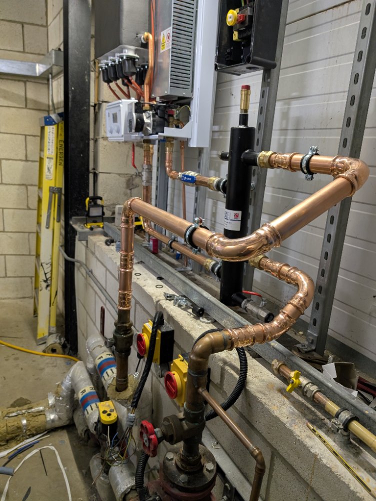

This job has been on and off since November, last week it came back with urgency, my fitters are tied up so I decided to do it
80kw electric boiler, full site is being degassed and moving to heat pumps, only place for a heat pump here is the roof and structural engineer said no
They do have 400kWp of PV and 200kWh of storage
Hire company cocked up with the press gun or it would be done now, just need to lag it once the boiler is wired (125a 3 phase supply)
Pipework is 35mm to the header turn 42mm existing. The AHU coil has also been replaced
