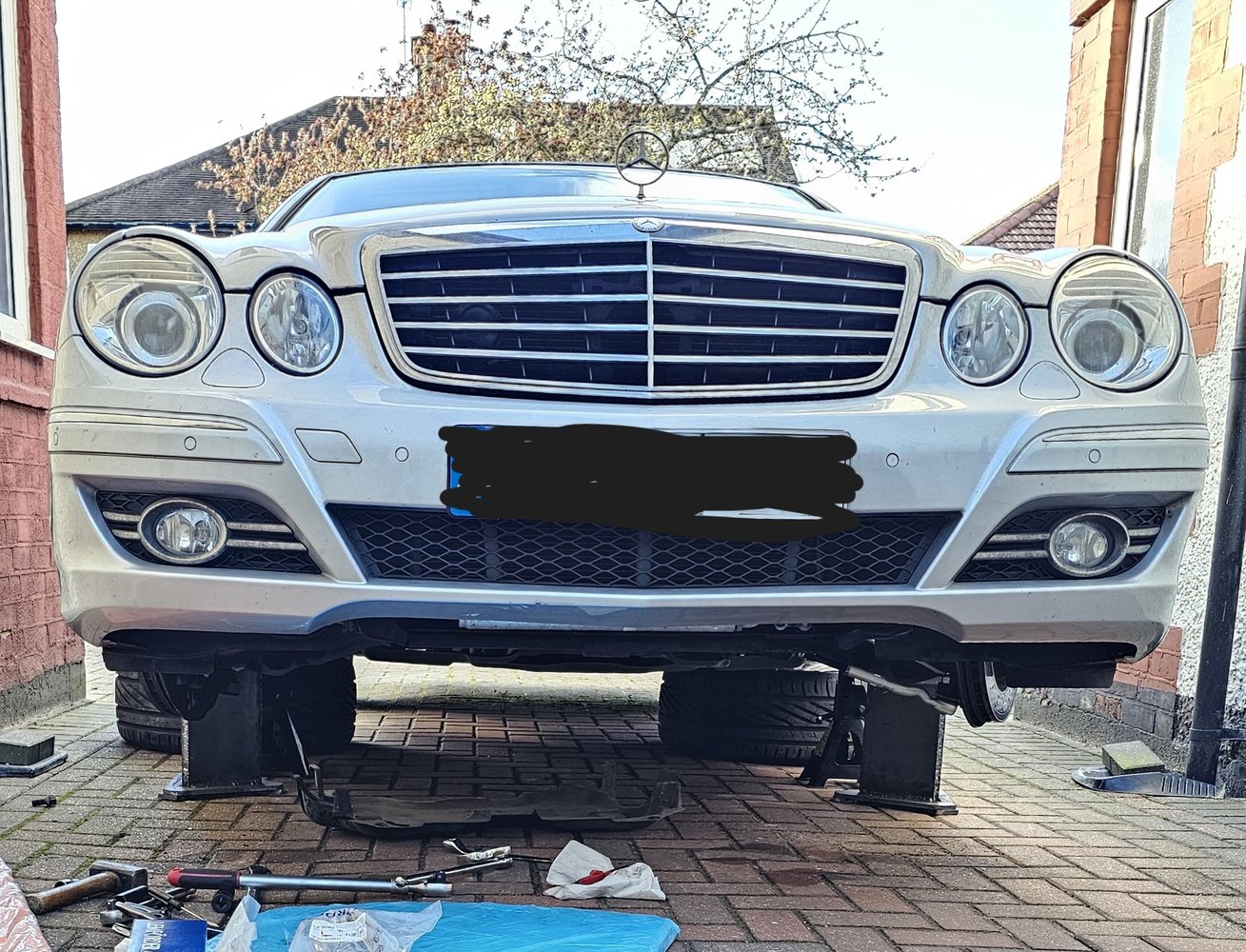

I've seen some of the recent posts about axles stand, jack posts etc. and thought I post this separately rather than hijack those threads.

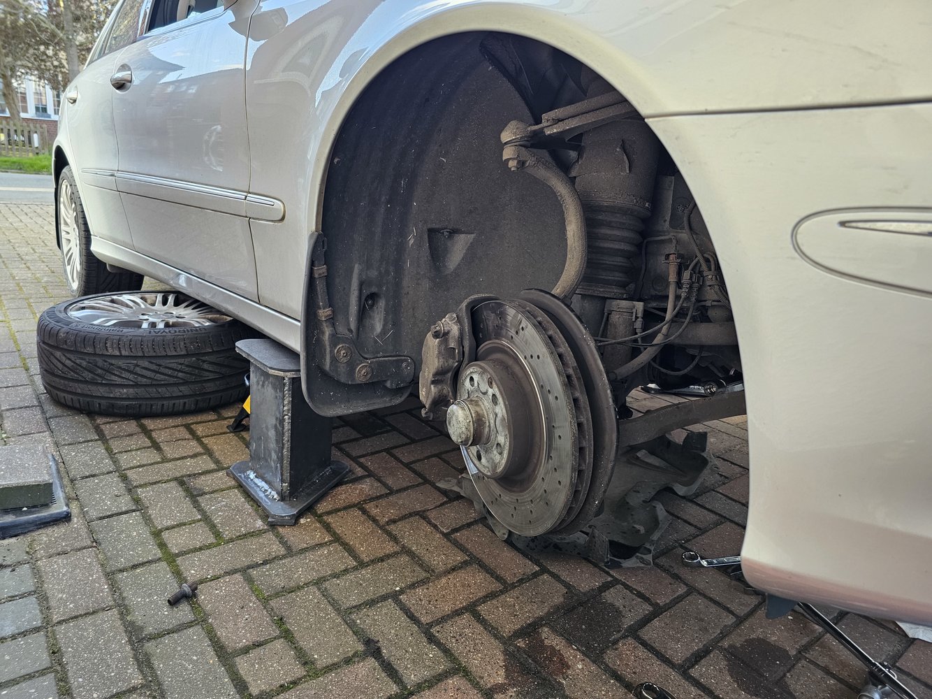

I'm paranoid about safety when under a car so I took the over the top approach of making a pair of stands out of 10mm plate - I didn't need the height adjustment so they are 350mm high and I still used a wheel and axle stands under the car when changing brakes and suspension arms. Since making them I have tidied up the welds - they still don't look great visually but I am confident with them, especially when compared to commercially made stands and the amount of weld on them.
The vehicle jack pads are in the center of the stands with an adapter to fit into the jacking pockets. Luckily the car has a central jacking point as part of the front subframe so it is easy to jack the front end up completely and lower onto the stands on both sides simultaneously.
