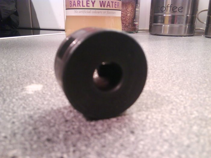

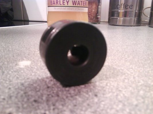

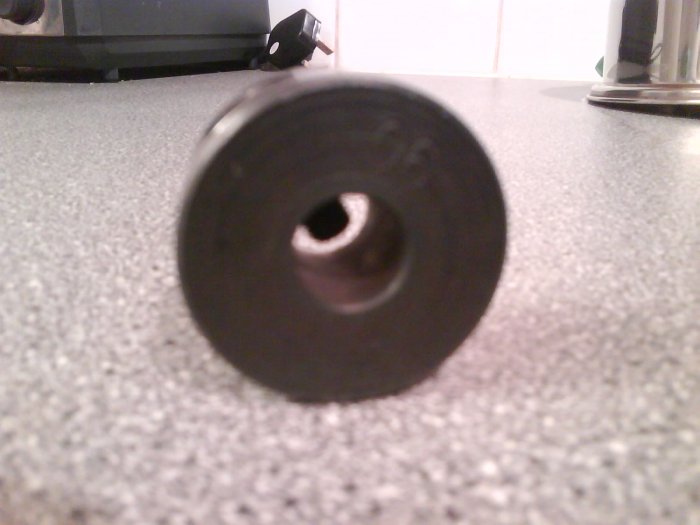

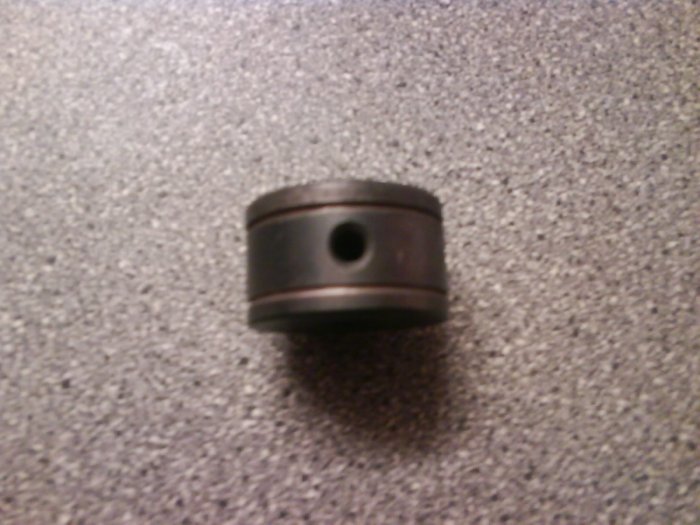

wish i could get my hands on another euro torch off somebody that i know is working well so i am sure that my problem will be solved .i have a lovely supply of wire coming from welder by bridging the two connections with torch removed .but soon has i put torch back on the poor little feeder adjusting screw has to be wound right down to get a continuous wire coming out nozzle .and i have now learnt this is not right cos has soon has i start welding the wire is going to snap because the ROLLER CANT SLIP ? cant take it to my local repair shop cos dont trust them cos they said i cant use knurled rollers i think they just wanted to sell me one of their mono migs .ok they are good cos thats what i use at my garage where i work .but this is my mc and would like to get it sorted for home . dont really want spend money on new torch if not going to solve problem for sure .all components on torch look like new and seems waste to change it for the sake of badly fitted liner .so which way should i go now folks ??
