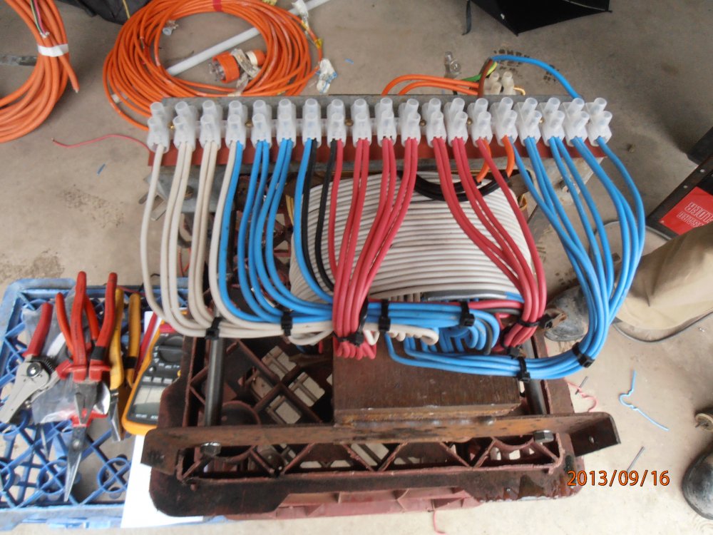

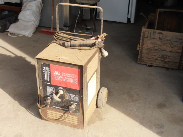

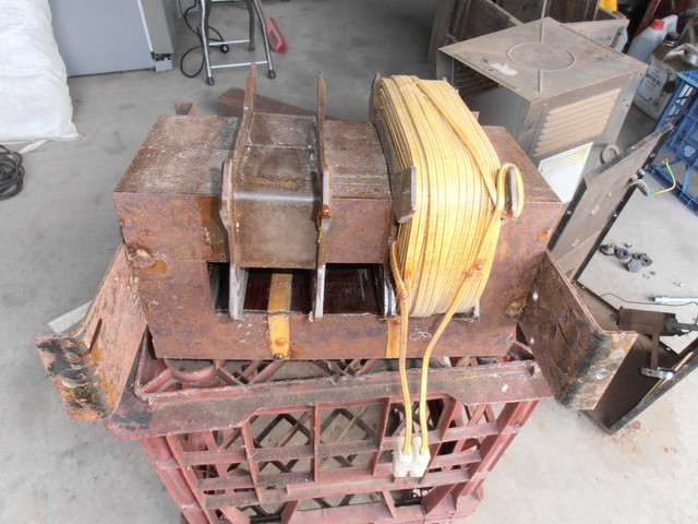

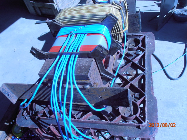

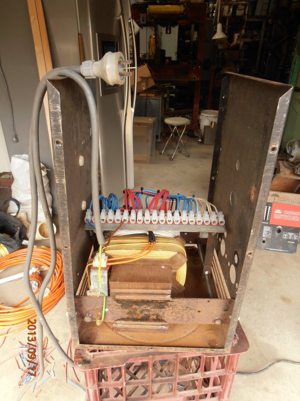

I would like to talk about the High Voltage Transformer Method for running 3phase motors from a single phase supply. I have built several converters of this type using used components like wire, relays, switches, terminals, capacitors etc. The most recent, an air compressor converter where I modified a 240v 140A choke welder by rewinding the secondary winding, only about 180 turns of 2.5mm squared building wire.
This motor is 2 pole (2860 R.P.M.). If the motor had been 4 pole (1420 R.P.M.) I would have only needed about 80 turns. Some advantages of this method are you can start a heavily loaded motor (like an air compressor) easily and you can run a motor at full load amps to get it's full name plate HP.
Also to modify, most welding transformers, say 240v to 415v is not very difficult or costly.
