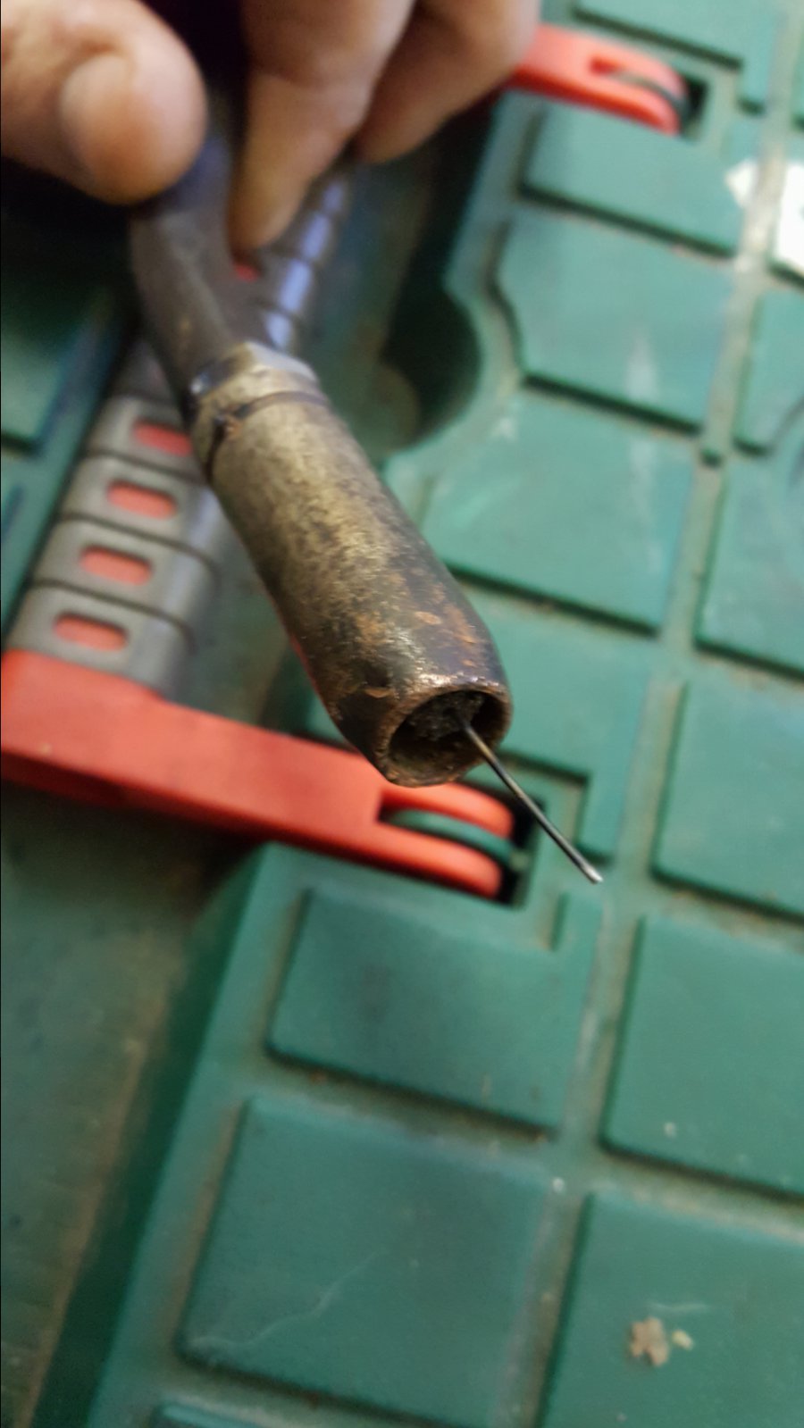

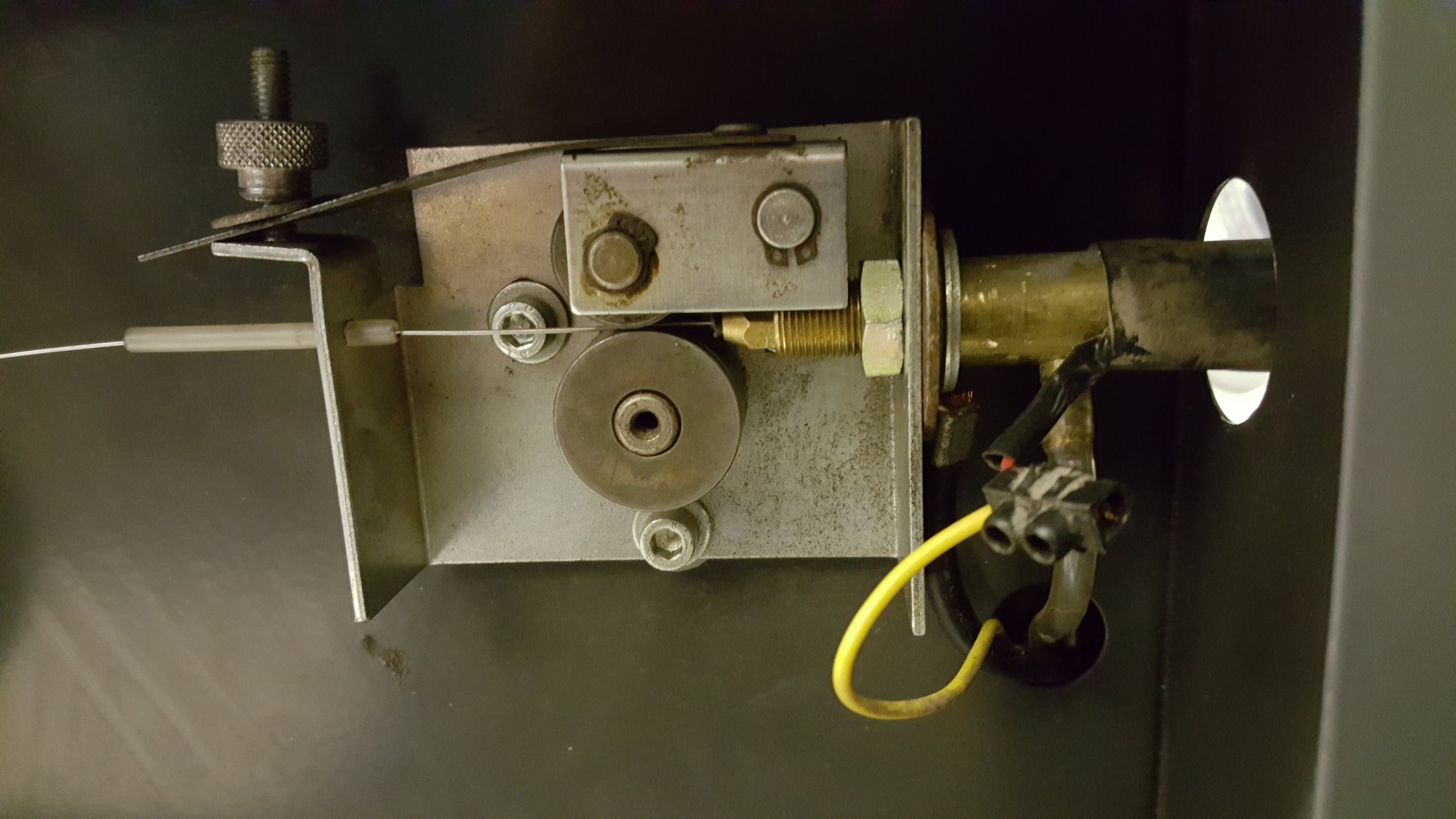

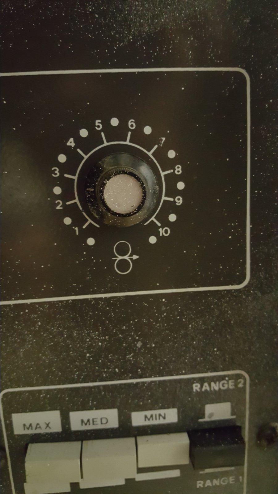

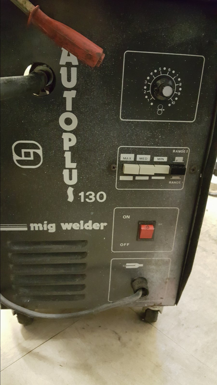

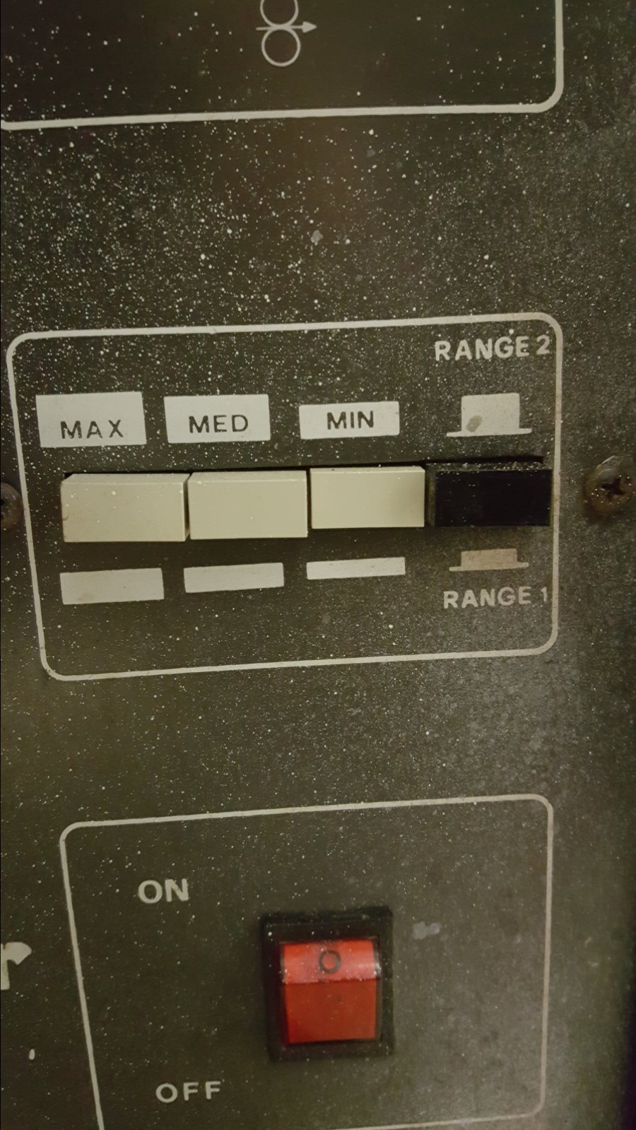

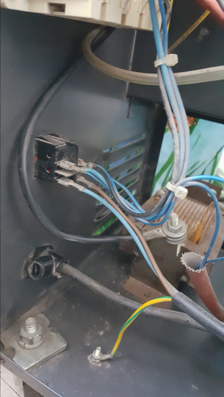

Hi I'm a complete newbie and I bought a autoplus 130 mig.I made the made the mistake by trusting the seller saying "it's ready to run" it wasn't after burning 3 lengths of flux core wire because it was buckling at the novel entrance in front of the wire feed. Turned out it was missing a tip so I got one and tried again and the wire was jamming. I had to undo the wire feed and re adjust the novel so it was 1 cm from the wire feed wheel as it was just under 3cm away and weirdly off set from the wire feed groove.tried again and perfect it runs much better and no buckling.but now my problem is bad welds and I don't know anything about the welder I have no manual and as you can see by the photos the buttons and dials tell me nothing.have I got the settings right, Can any give any advice? Thanks
