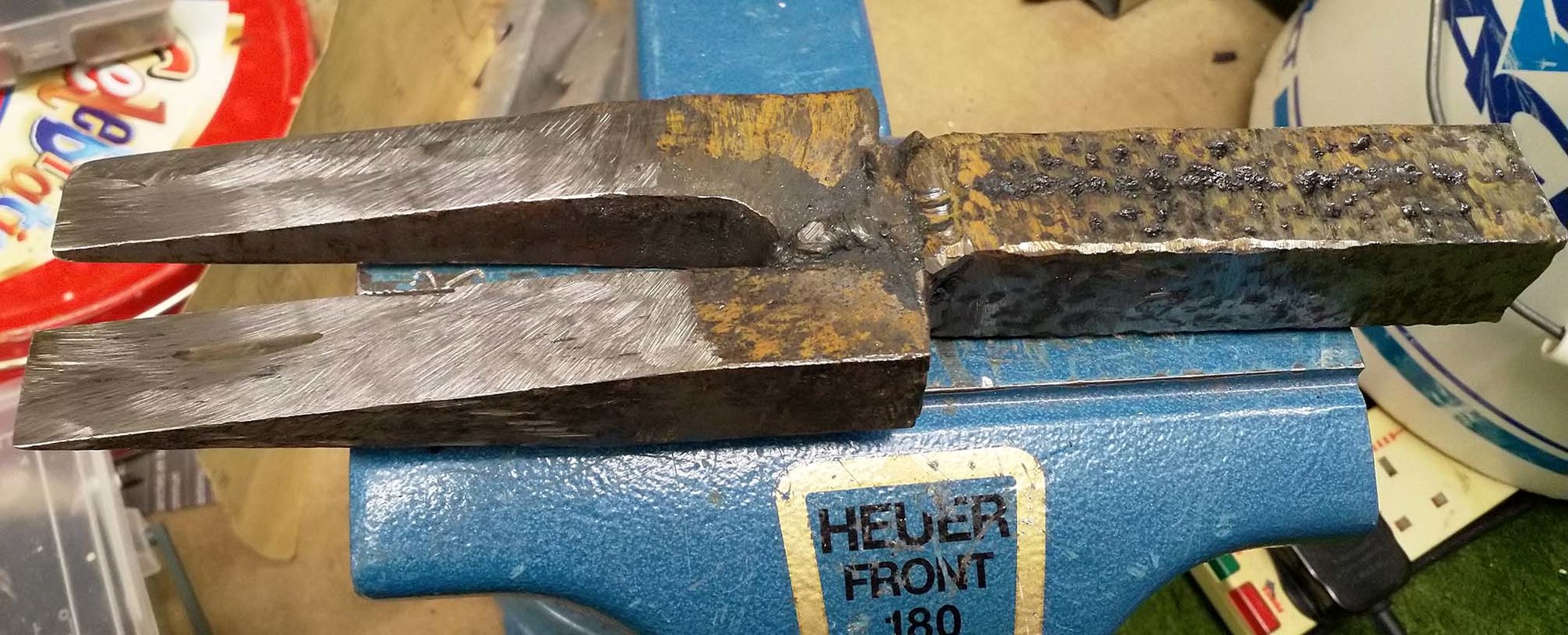

I need to replace the suspension arm on my car, so I thought I would make a pickle fork to help pry it off. The toughest part was cutting the angles with a hacksaw as the angle grinder would hardly cut it. I tapered the parts to be welded like you would do if welding pipe and gradually built up the weld.
