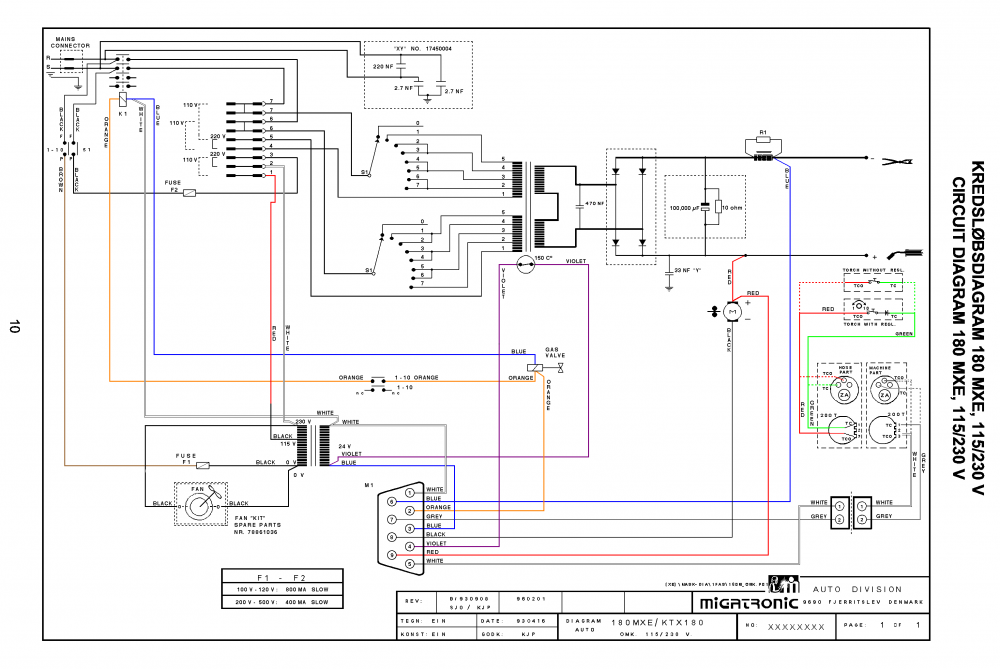

Hi, I've lately taken on an MXE 180. It came with a blown circuit board (now repaired) and missing a torch (4 Metre Binzel 150 bought) and a mains lead (found the correct rubber-sheathed cable to match original, and wired it in with a 16A plug. Annoyingly, the little Camloc catches for the feed door were missing, but I've found the means to make new ones - the original type is no longer made by Camloc.
