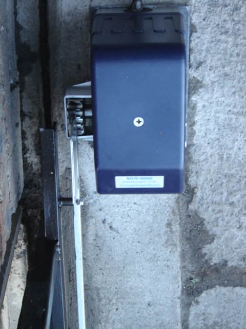

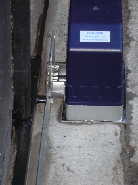

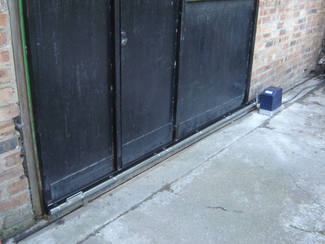

One less task on my "to do list" glides effortlessly, which did surprise me as it is heavy gate. had to add unequal angle along the length of gate to accommodate weld nuts to attach tooth bar. I hard wired in using armor cable, will knock up some lengths of stainless steel top hat sections to go over the cable viewed in one of the pics, although not really necessary as it runs along dead space. I have to admit, this is a task not for the faint hearted, took me two working days to install from start to finish. I took a clip via my camera, unfortunately it wont upload, if anyone who is maybe interested installing such a device would like to see my clip, pm me an email addy.
