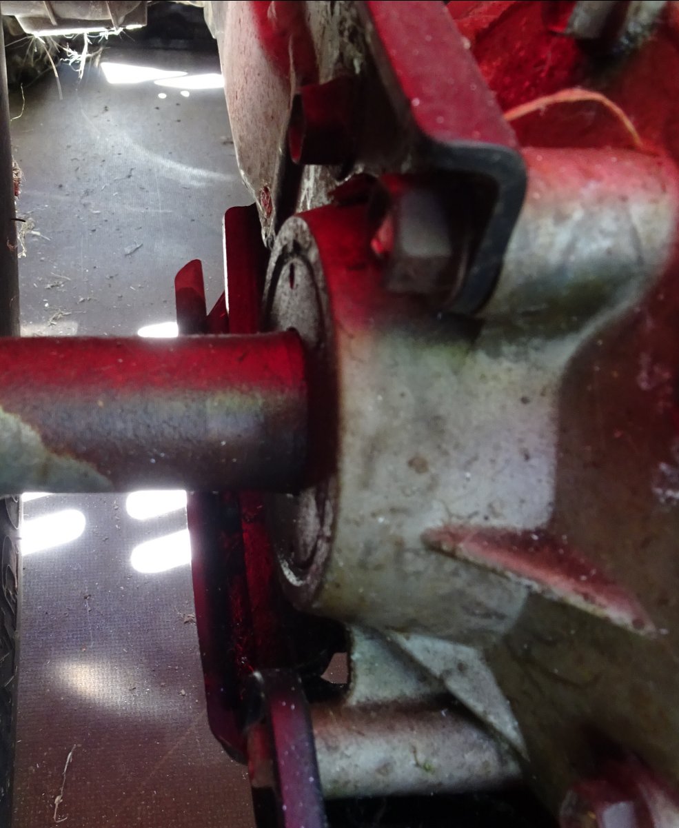

The rear axle oil seal has failed on Mrs Robo's quad (no comments about overloading it

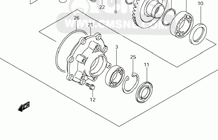

Part No.11 here

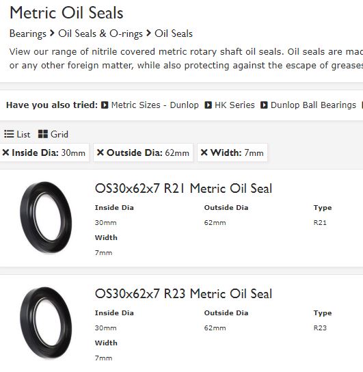

I could pay £16 plus postage for a genuine one or a couple of quid from a bearing supplier, but do I need a single (R21) or double lip (R23) type?
