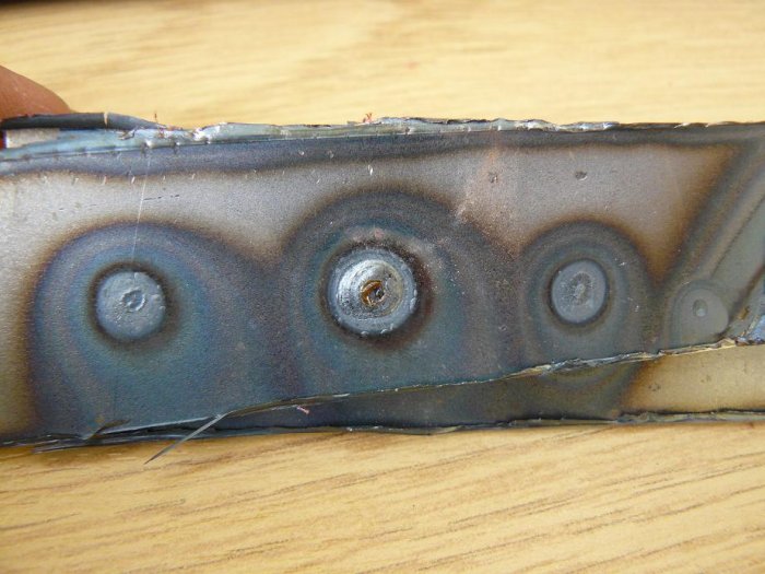

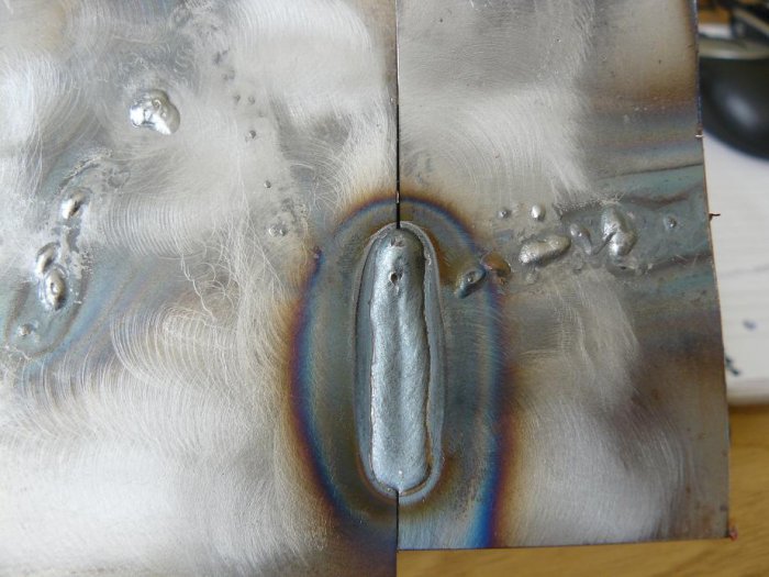

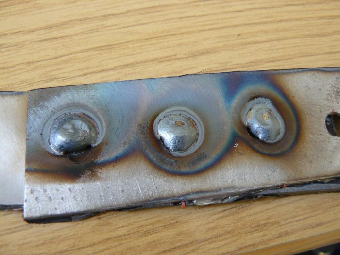

Just spent a few hours in the garage practicing the butt & seam welds as my first project is to fit sills to my mini. I was not sure how much gap to leave between the sheets so went for about 1mm??
anyway, any comments about how I can make these better??
many thanks
rob
many thanks
rob
, for bodywork thickness i wouldent bother leaving a gap, itll just make life more difficult, tho only problem i can see is that the butt weld is dipping in the middle, this can be solved by no gap or lower amps, surprised it didnt blow through though, well done
