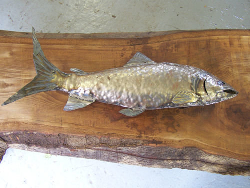

Heres one of my salmon i make for the birds. I cut out 2 identical fish shapes from 1mm steel doubled up. Then I sit over a block of wood and start beating them with a ball pein hammer till they bow out enough. Once this is done I weld them together then add fins for details
