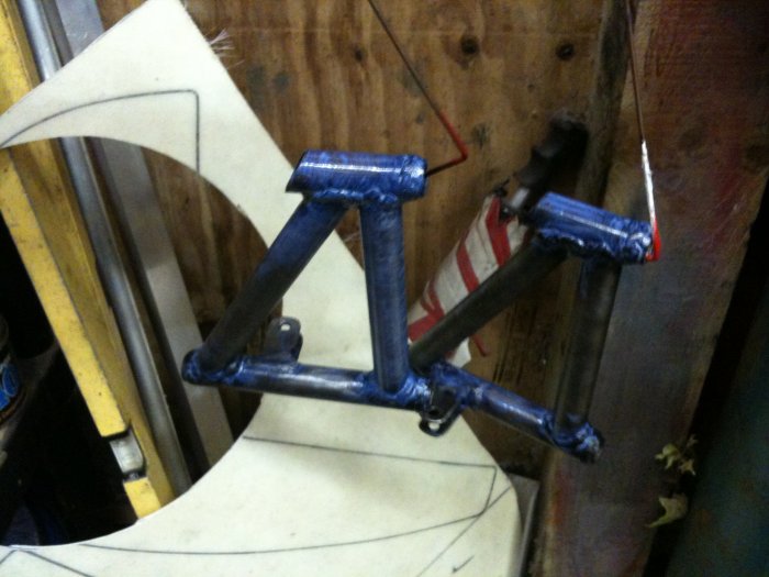

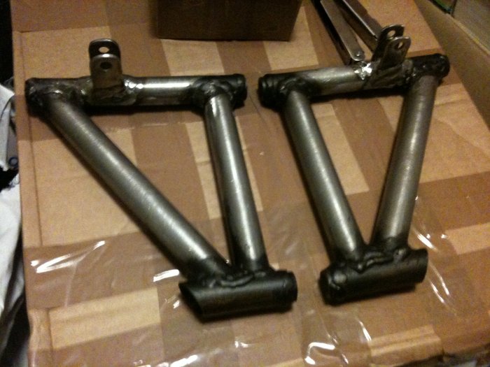

After posting questions on someone else's thread -- sorry , I have played around with my secondhand MUREX 186c mig which I bought to use on 16 gauge CDS 25mm roundtube and arrived at the best settings for my machine on this stuff.
It has 6 power positions but position 2 on any wire speed setting was not producing a weld.Tried w.speed 2 which the panel intructions gave for 16 gauge -- no good . The wire speed has 6 settings too .
Finally after messing around on some cut off bits of 16 gauge , I got a decent weld (for me) on power setting 3 and w.speed 3.5 . It helped to have the gas at 20lpm and 10mm stick out for tight angled joins but just 5mm stick out around the tubes from above position. Having read very carefully on these forums and various youtube vid's , I also stopped drag welding to go forward but in short 20mm maximum welds then welded another position till it cooled .
Cleaning the shroud often and purging the gas line also helped as did some tig welding gloves for easy movement m making it possible to use the left hand to steady and control height . I'm really surprised that these power/w.speed settings worked as I assumed they'd be way too hot on 16 gauge roundtube.
My welds are too big at the moment but by looking into the tube I can see penetration's ok . Now I need to practice speed control and getting around the tube with one pass rather than going over the weld again to tidy it.
Thanks to all who gave the advice I put into practice
