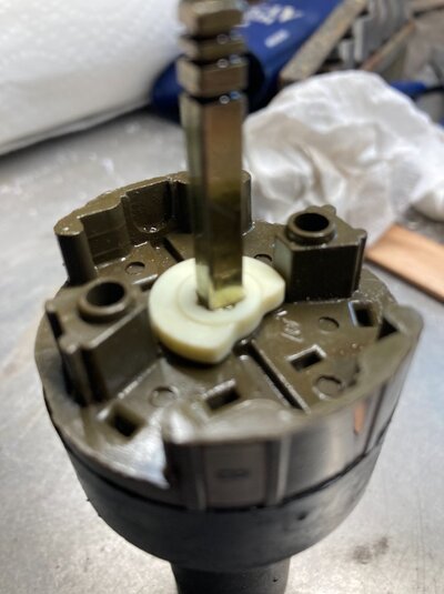

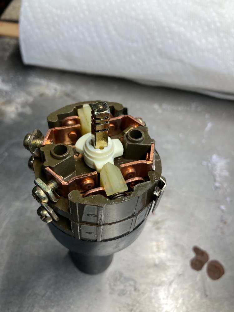

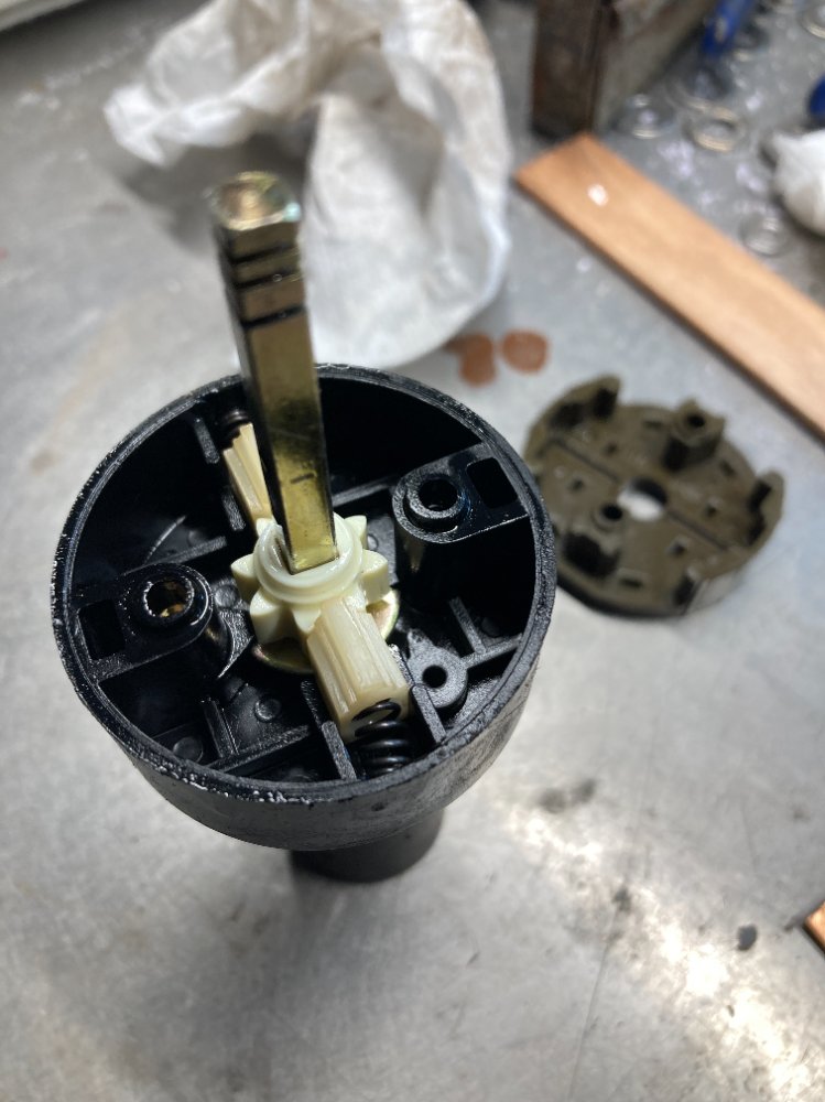

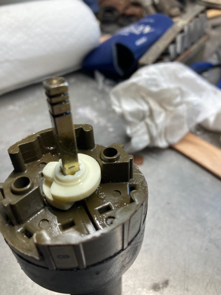

My heat selector switch began binding and didn't want to turn off. I took some pictures as I took it apart and found nothing wrong with it. I lubricated it as I reassembled it and it operates great. I saw the thread about a heat switch, looking for cam positions. It was back in 2016 and unfortunately did not answer my question. I find myself in a similar situation. I took pictures of my switch, but lost track of the position of the selector shaft, which made my cam position pictures questionable. There are three jumpers and I have them connecting #7 to center (unlabeled) to #2 and then #8 to center (unlabeled). If I could find a wiring diagram and get a few pictures of someone's working switch (on the outside), I could figure out if I have my cams in the right positions.
