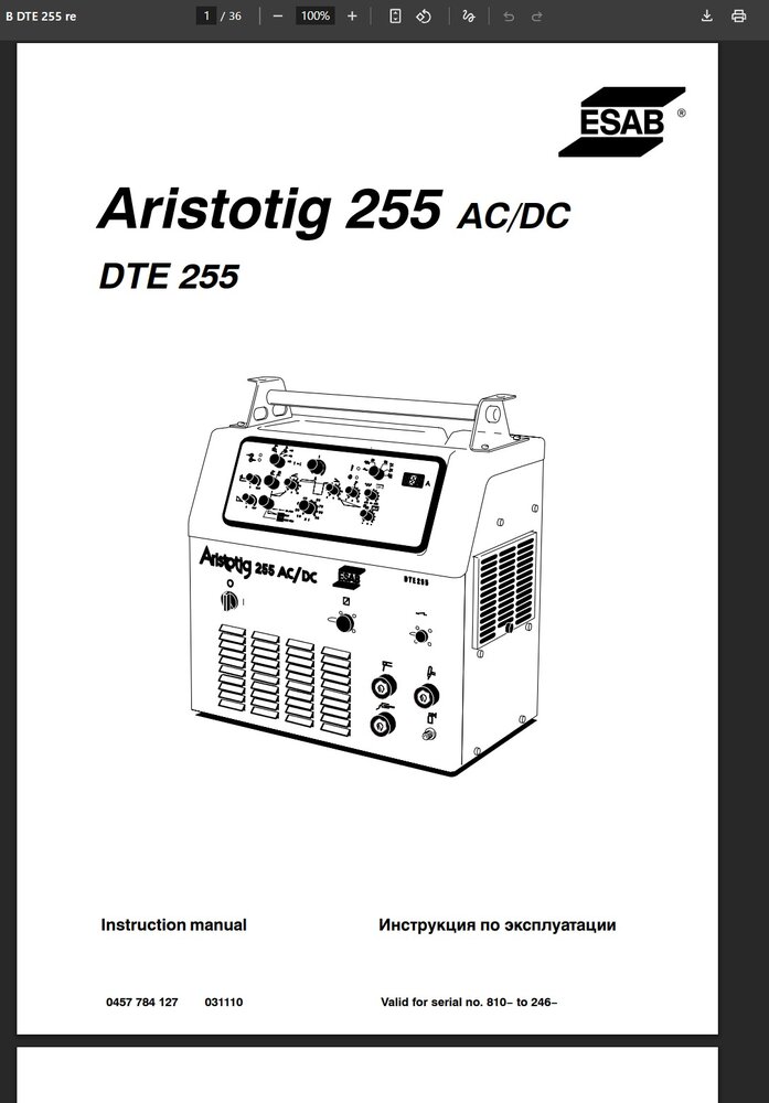

F fizzy Forum Supporter Messages 12,364 Feb 15, 2020 #1 Does this older TIG use a normal potentiometer style footpedal or is it also canbus? I am hoping the older ones are conventional. Would it be easy to use a cheap chinese footpedal for it? I object to paying silly money for something so basic.

B Bobbes Member Messages 230 Location Maarssen / Netherlands Feb 15, 2020 #2 Just simple potmeter and switch. But use the correct value of potmeter (2K5) Pagina's van DTE-255.pdf 87.8 KB · Views: 122
F fizzy Forum Supporter Messages 12,364 Feb 18, 2020 #3 Bobbes said: Just simple potmeter and switch. But use the correct value of potmeter (2K5) Click to expand... Thanks very much for that - will have a bash at making my own or modifying one.
