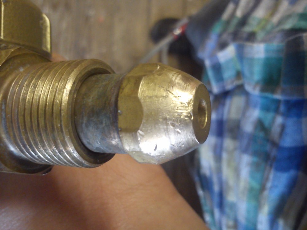

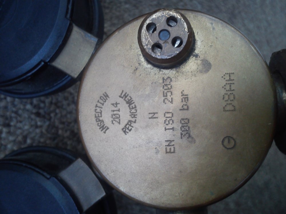

Have to disagree with ya there. The rubber diaphragm is a perishable item no matter where or how it's used. I weigh em in when the date is up.For industrial use they would be binned by the date shown for insurance reasons, but as DIY use is much lighter it will last a lot longer unless damaged like yours.
Well at least I shouldn't feel bad that I broke it if I should throw it away anyway.Have to disagree with ya there. The rubber diaphragm is a perishable item no matter where or how it's used. I weigh em in when the date is up.

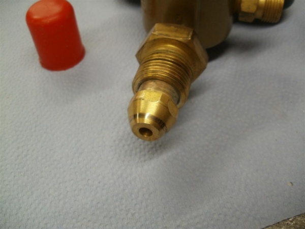

So I should get that reg and one of these.Rather than a flow meter you are better with a "peashooter", they are a fraction of the cost and generally more accurate, also they let you know how much gas is actually coming out of the end of the torch
I've just ordered one from weldequip.Just contact Weldequip and get a new regulator , their not expensive .
