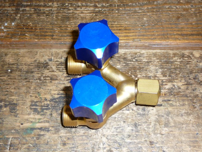

You can always rig up a second T and a third flowmeter for trailing purse if you need to do some titanium..........

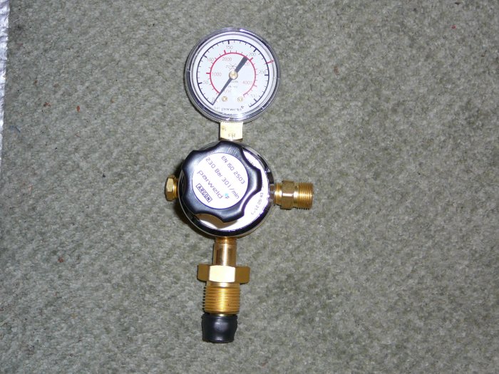

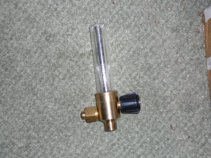

The "T" would need to be connected to the regulator, then two flow meters so you could control the purging gas and welding gas seperately.
Absolutely. But I can't see any other way of doing it, physically.
The way i read the post, HasBean was thinking of putting the "T" after the flow meter.![]()
